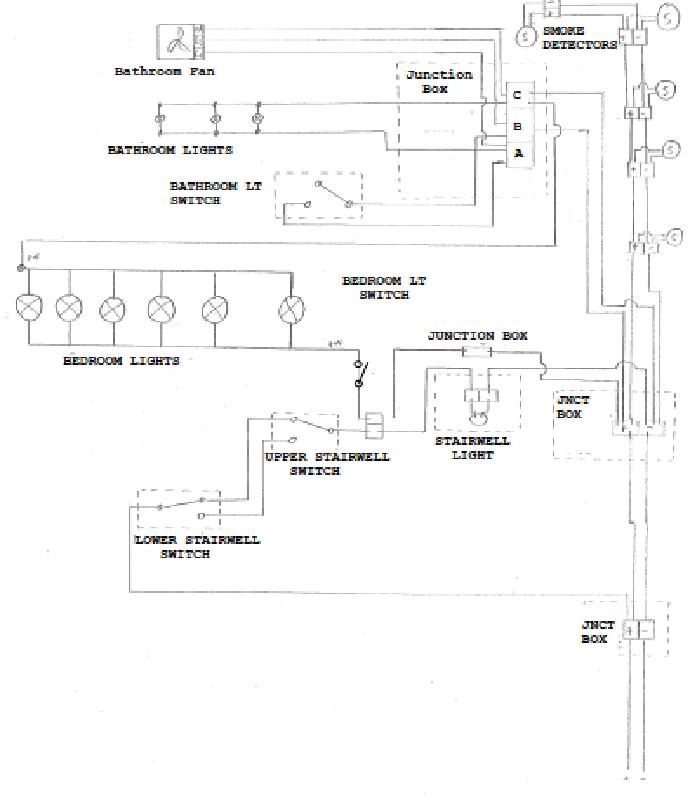

Project Attic conversion

Great guidance - well spotted - I am hoping that as the builder is aware that there are spots going to go in, he will allow for this.
Something for me to keep an eye on though.

In my experience, many builders have no idea about these sort of issues. They carry out their work given the instructions that they are provided with.
If you, the electrician, or the architect get it wrong then it will not be their fault!
As a veteran of several loft conversion projects, there is no possibility of installing downlights in the sloping ceiling. Often, for a standard roof, the only possible void for downlights is to construct a false ceiling at the ridge.
LABC are very hot on compliance with thermal requirements (pun intended).
I urge you to get your proposal agreed in detail with the Building Inspector early.

Ah - the attic conversion will be a dorma - i.e. flat roof over the habitable space. The downlights will be installed on the flat roof and not the (existing) sloped roof)
Presumably this will make a difference?

..oh...and yep - buildings control will be approached with constructional drawings etc before hammer hits nail....

Whatever the roof construction, there will be a thermal insulation requirement. A normal cold roof construction with downlights is not normally permitted. You may need to go for a WARM ROOF construction.
It will depend on your ceiling height.
Here's the difference
Ok - warm roof it will have to be....plenty of clearance between rafters and roof ridgeline....
