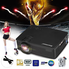

Yes it does although most projectors do have a "trapezium adjust/compensate" button but generally it is pretty poor. Also if you are thinking along the lines of buying a very cheap projector such as one of these DON'T. They are complete rubbish. LED technology just isn't good enough at the moment. Get one with a proper bulb that you wont have to have the kids sitting in total darkness watching an out of focus screen. I know I have one although I have now bought a proper projector. s-l225.jpg

The previous poster is correct about those cheap LED projectors. They sound great on paper, but the adverts are written in a way that makes them out be to be far higher specified than they are in reality.
In this situation, a used projector would be a far safer bet.
There are plenty of really good 720p and 1080p used projectors going for peanuts. Mostly it's down to lamp replacement costs.

Yesn it is called keystone my mistake. It's still rubbish on most projectors if not all. You will still need to get the projector pretty damn near to spot on for a decent undistorted picture. I reiterate don't buy an LED one.
