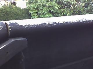

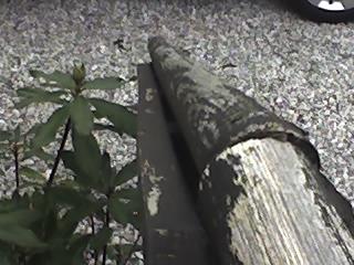

I used an internal handrail on a structure I bult to access a caravan. At the time, it was the only thing I could find that suited my purposes. I treated it very, very well with Cuprinol Wood Preserver - Clear, soaking the exposed ends for a lot longer than recommended and minimum three coats everywhere else.
It has been there for 20 years now, no rotting. Had treated it every year with something like Cuprinol Ducksback for sheds and fences! Has been neglected for the past five years, but still no sign of rot. Must get the paint brush out.
However, if safety considerations apply and people may lean on rail, then it probably won't be substantial enough. Sorry, can't help you on the other queries.
