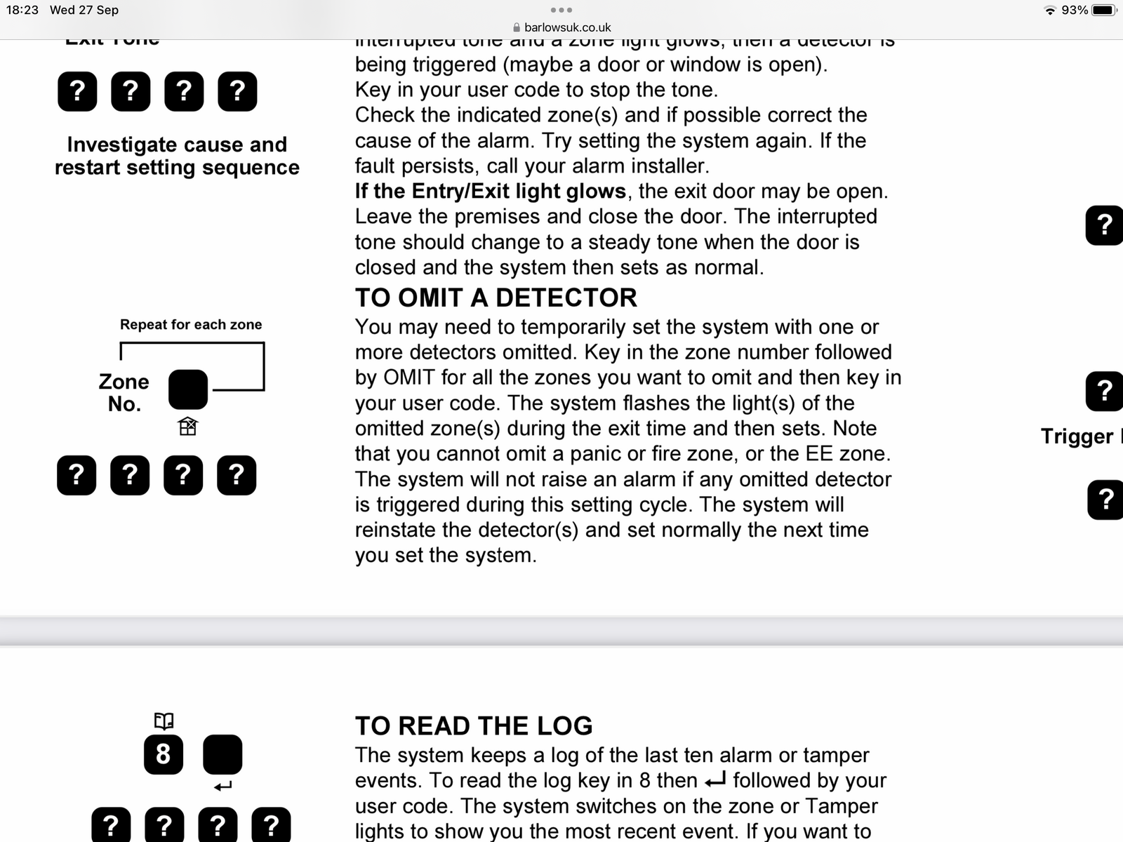

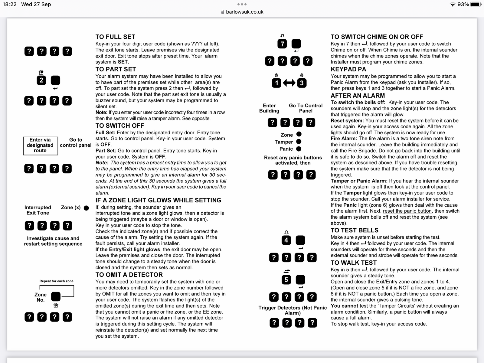

It’s done from customer code …. EG …..5 OMIT …..YOUR CODE ….EG 5678 ….read below , if it’s an entry exit zone you can’t OMIT

The sequence to omit when we set the alarm works, but I wanted to open up the technicians code side with 0 - enter -7890. Then use 10 - enter the zone to delete - enter..... but I cannot enter that for some reason.
The code has been changed. You can factory default the system following the instructions in the installation manual but u will have to reprogram everything
