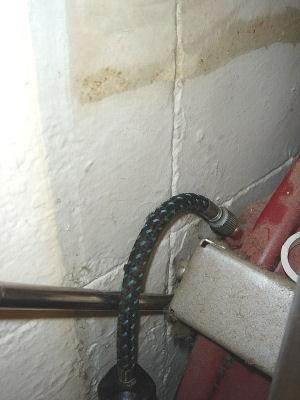

Problem is, in the 80E manual very little reference is made to the expansion vessel. From the diagram and the flexible 15mm pipe, it looks like it's behind the boiler/burner, against the wall. I can't see a schrader valve anywhere to check it's pressure and try topping the air up if it's low or test for water. Surely you don't have to remove the combi just to check the pressure?????
Can anyone help me identify/check the expansion vessel on 80E? I can get a new one for £45+vat if faulty but at least want to check this first.

Get up above the boiler and look down the back, you should find the top of the expansion vessel and a shraeder valve
You're not looking hard enough. It will be on the vessel somewhere but due to incompetent design sometimes the schraider valve is not accesible (ie it points to the wall etc). Have you looked down the back of the boiler....some boilers require small cover plate/bracket to be removed.

Pablo, thankyou.
Got it. 18psi, valve looks dry, no water came out. When I get a bicycle pump out so I can re-pressurise I'll try letting all the air out and putting system pressure back to make sure that no water comes out. Then I'll let system pressure out and set the expansion vessel pressure as per the book (1.5 bar I think) with no pressure in the CH - from reading the maunual that seems to be the correct way to do things, then top up the CH water pressure to 1-1.5 bar.

I wasn't - you were right, get my head in the ceiling and it's down the back of the boiler and quite accessible, presuming you are not tight to the ceiling with the combi!

NO, no, no, no the expansion vessel should only be set to around 0.8 bar (about 12 psi). Only check the pressure with the system pressure at ZERO and pump up if necessary. Afterwards set the water pressure to 1 Bar (certainly no more than 1.5 bar) with the radiators COLD and the boiler pump not running.

18psi is near enough to 1.2bar leave it alone ;) what you can do and others will advise as im a commercial engineer, find out how the vessel is connected to the system, i know some use a flex pipe which can apparently clog?

It has a flexi hose, should i take it off or just read pressure after I drop CH pressure to zero and if the expansion vessel pressure goes down some presume that the flex hose is okay?

If i suspected blocked exp vess hose i would drain boiler, remove flexi hose and repressure exp vessel with hose disconnected. If its blocked, nothing will come out of hose. If it snt, beware, alot of muck and water will shoot out! You may need an extra pair of hands for this bit!!
