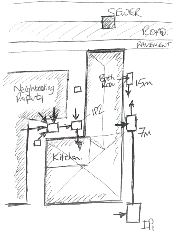

Updated overview including new access point flow info attached.
If all your neighbours waste feeds into the pipe running under your house does that not class it as a public sewer so the sole responsibility of the water board?.

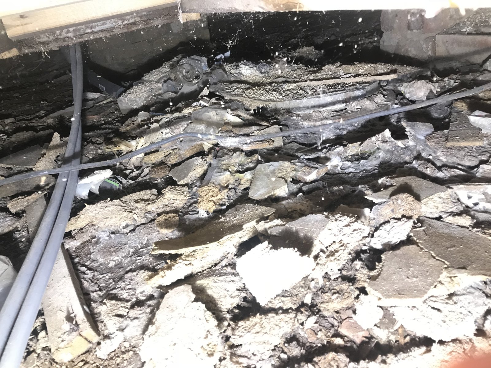

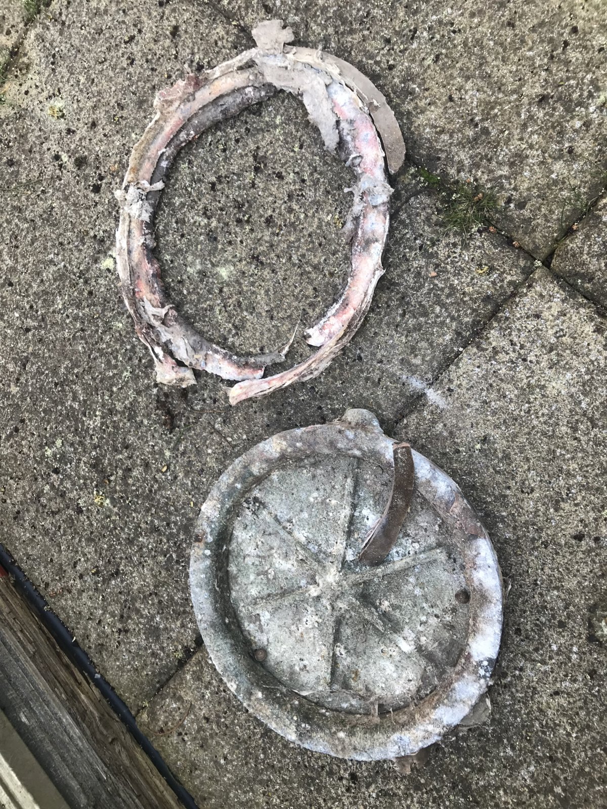

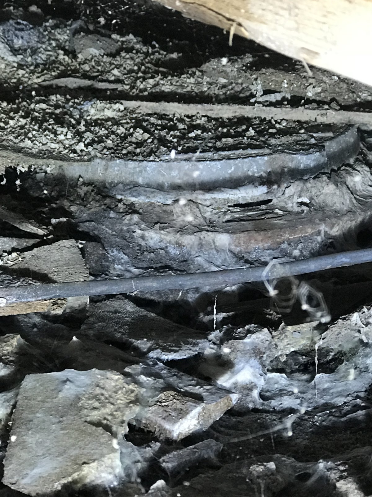

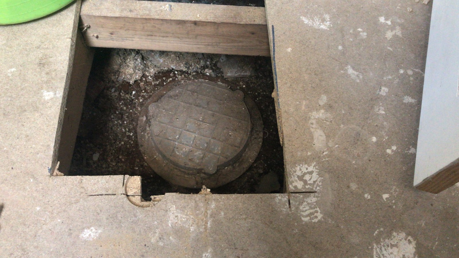

Since getting back I went hunting for the chamber that was found during my survey. Two failed attempts at crawling through the floorspace (still a bit damp) and two holes in my kitched floor later and I've finally located it. There is a damaged inspection chamber underneath the suspended floor of my kitchen that would appear to be the cause of the flooding. It looks like the top has popped off this inspection chamber under the build up of pressure caused by the block on the main street. As mentioned earlier, in the past the water escaped through another unsealed IC on the street. This time though, the seal has been blown off the IC under my kitchen. The seal is still actually screwed into a collar, but it looks like the seal between the collar and the IC itself has failed. I've attached a couple of images below. I'm not sure if this will work, but here's a video hosted externally of it's innards: https://www.dropbox.com/s/zbhffooa4lyonex/IMG_4197.mov?dl=0
2018-04-14 15.20.32 copy.jpg 2018-04-14 15.22.11 copy.jpg 2018-04-14 17.55.26 copy.jpg 2018-04-14 18.13.35 copy.jpg

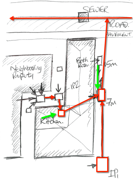

To summarise, it drain layout is as follows. Green being my responsibility, and red being the water co's. As you guys mentioned above, deff a water board job.
Water board wasn't helpful before as they were assuming it was my own private asset that failed (despite me telling them I thought otherwise). Now that I've located and got access to their IC, and confirmed it serves another property, I'll write to them asking them to reseal, sort out the damp problems that are still down there following the flood, and reimburse for the drain survey and damage incurred to kitchen looking for this. If anybody has any thoughts or advice on what else to ask/say when contacting them, that would be really appreciated.

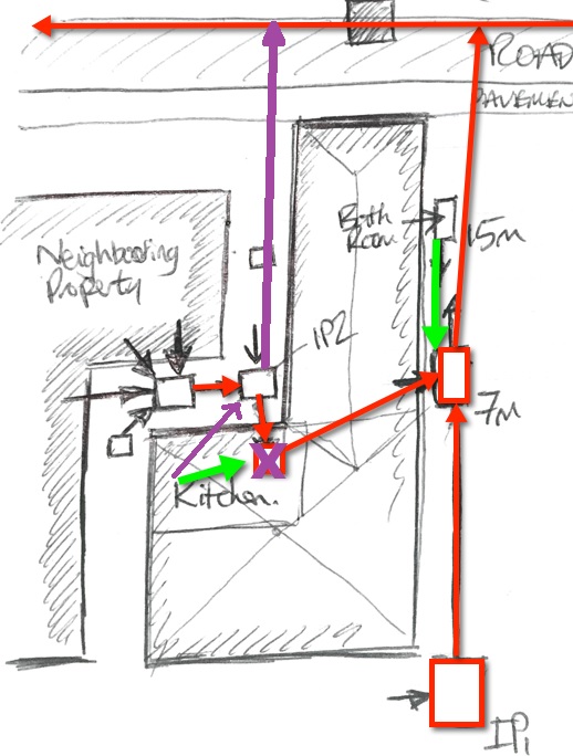

My suggestion would be to close off the pipe under your house and have a new sewer to the street as in purple here
Re-direct your kitchen wastes into IP2 so the new sewer is a shared service is a shared service and thus not your neighbour's responsibility.
For the Water Company creating a new sewer may be simpler and cheaper than making the sewer under your house safe now and then maintaining it in the futures

Not always that simple, the Water Co are not likely to want to spend that sort of money, when simply sealing the existing chamber under the floor will suffice. Also Legal issues with easements, a hell of a lot of disruption whilst the work is done, and for what? If there was a issue with the main in the street, then jetting that may have removed the issue, (be it FOG/roots/silt/unflushables/whatever), and hopefully the issue will not reoccur any time soon.
I'll discuss the above with the water co. The new purple section is approx 15m and would run though the neighbours recently laid paved area. Something I should mention that I haven't before is that the section that runs under my house is a 100mm pipe. The neighbouring property is a part of a care home. It was originally a 3 bed detached building, but recently they added an extension to the rear with another 3 or 4 rooms. I think all of these are now directed into this 100mm pipe. The drain survey guy suggested that was quite a big ask for a small pipe. Getting things redirected would be ideal for me, but yeah, as Hugh mentions, possibly too much to expect. I'll raise it though.
... simply sealing the existing chamber under the floor will suffice....
Am I correct in thinking that the sealing should be done by the water co rather than myself/a private contractor?

Sealing the lid of an inspection chamber does not seal the brickwork in the walls of the chamber.
A house near here has an inspection "pit" with a "sealed" cover in the cellar. The lid is 3 brick courses above the cellar floor and when the main sewers back up (*) liquid is forced out between the bricks above the floor. It isn't known how much liquid permeates under the cellar floor.

Its not a brick chamber though in this case, it is a clay chamber, probably made in one piece, as due to its diameter it wont be very deep. The correct cover looks to have been fitted, although the method of fitment may not have been adequate, given the hydraulic pressure created by the blockage.
