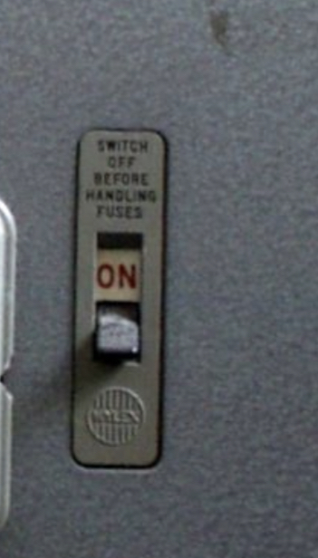

If you have a FUSEbox, there is often an instruction on the box telling you to turn off the main switch before removing fuses.
That then should put the matter beyond doubt!
I would suggest that, IF you have an old-style FUSEbox, you should first be spending your money bringing the basis of your installation up to date, rather than on cosmetic improvements.

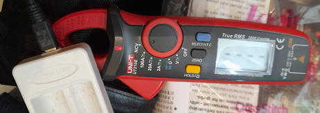

50 volt can still make you jump. But in the main I work with just the single pole switching RCBO turned off, with of course the clip and lock so can't be switched on, and always test for voltage and current before working on the device, I don't use a proving unit, I know I should, but I am a bit lazy, and in my own house don't bother locking off, as no one is going to switch back on.
The biggest risk is likely the borrowed neutral, I hope my clamp on which will measure down to 0.001 amp will alert me, and it also has NCV sensor so even without a reference point I should detect and live wires, I don't know how the NCV works, but it beeps, flashes a red indicator light, and shows 1 to 4 bars on the display, so not a simple reed switch.
I know many feel the NCV testers should be thrown in the bin, but I feel there are very good as a secondary test. Opps sorry NCV = non contact voltage.
But it can miss-lead
seen here showing all 4 bars, when put next to a USB charger which should be 5 volt, so it should not have shown any AC voltage, tried 3 power supplies, including the lap top, if I unplugged the lap top charger it stopped, but can't see three independent devices all being faulty, however showing voltage when there is not is better than not showing when there is. No voltage it displays EF.
It's true I do have an old Wylex fuse box, and at some stage I will have it updated. Although I see no urgency since we have lived in this house for 37 years and never had any electrical problems.
It seems to me that many new regs are often designed to just give jobs to the boys, although I agree a new fusebox would be an improvement.
