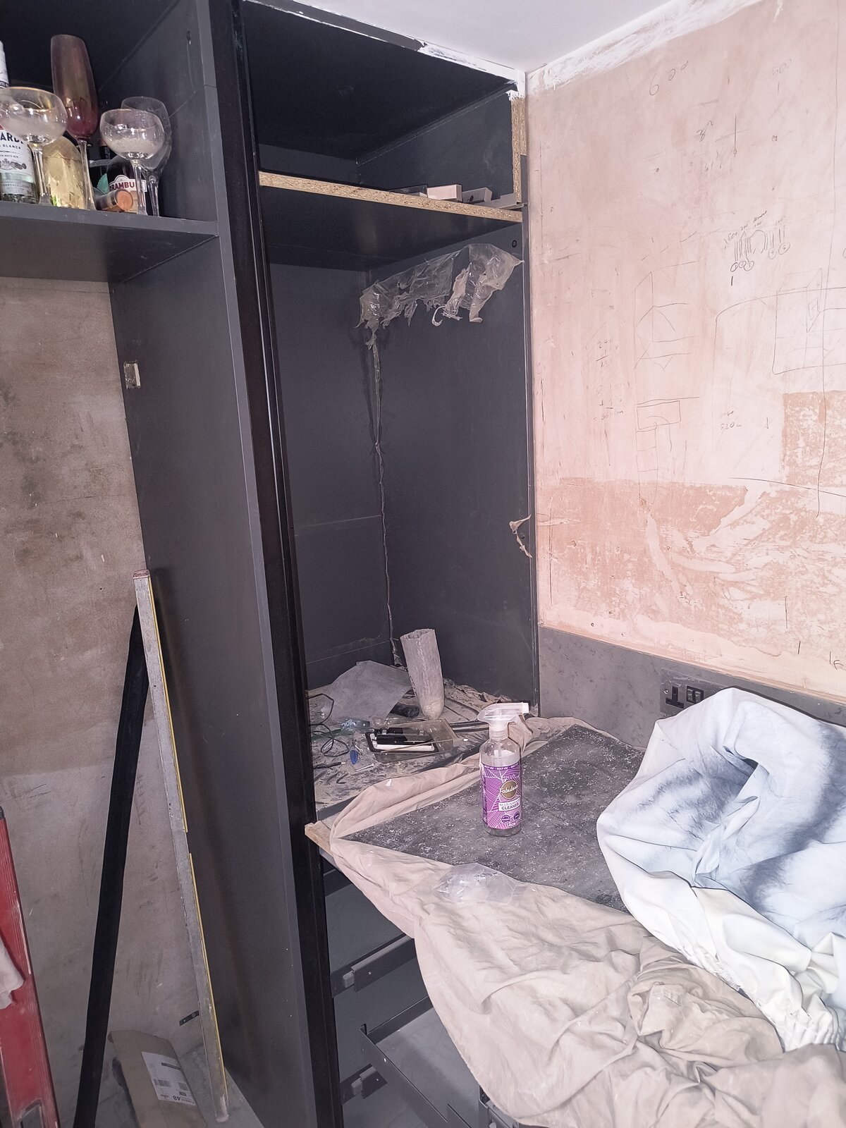

I want to fit two pull out "platforms" in this unit. One for a toaster and one for an air fryer.
Can I get special slides for this (suitable for mounting something on top (probably HPL) or do I just bodge some standard drawer slides?
Certainly for the bottom one (toaster) it would be better if it were bottom mounted (there's a shelf under the dust) as it would only need to be about half the width of the unit.
IKEA Komplement wardrobe slide-out shelves have bottom runners, and could probably be adapted for this - if the depth of the unit matches. Example:
Just bear in mind that you should not (as in NOT NEVER) allow either of those two heating appliances be operated when pushed back into the cupboard.
