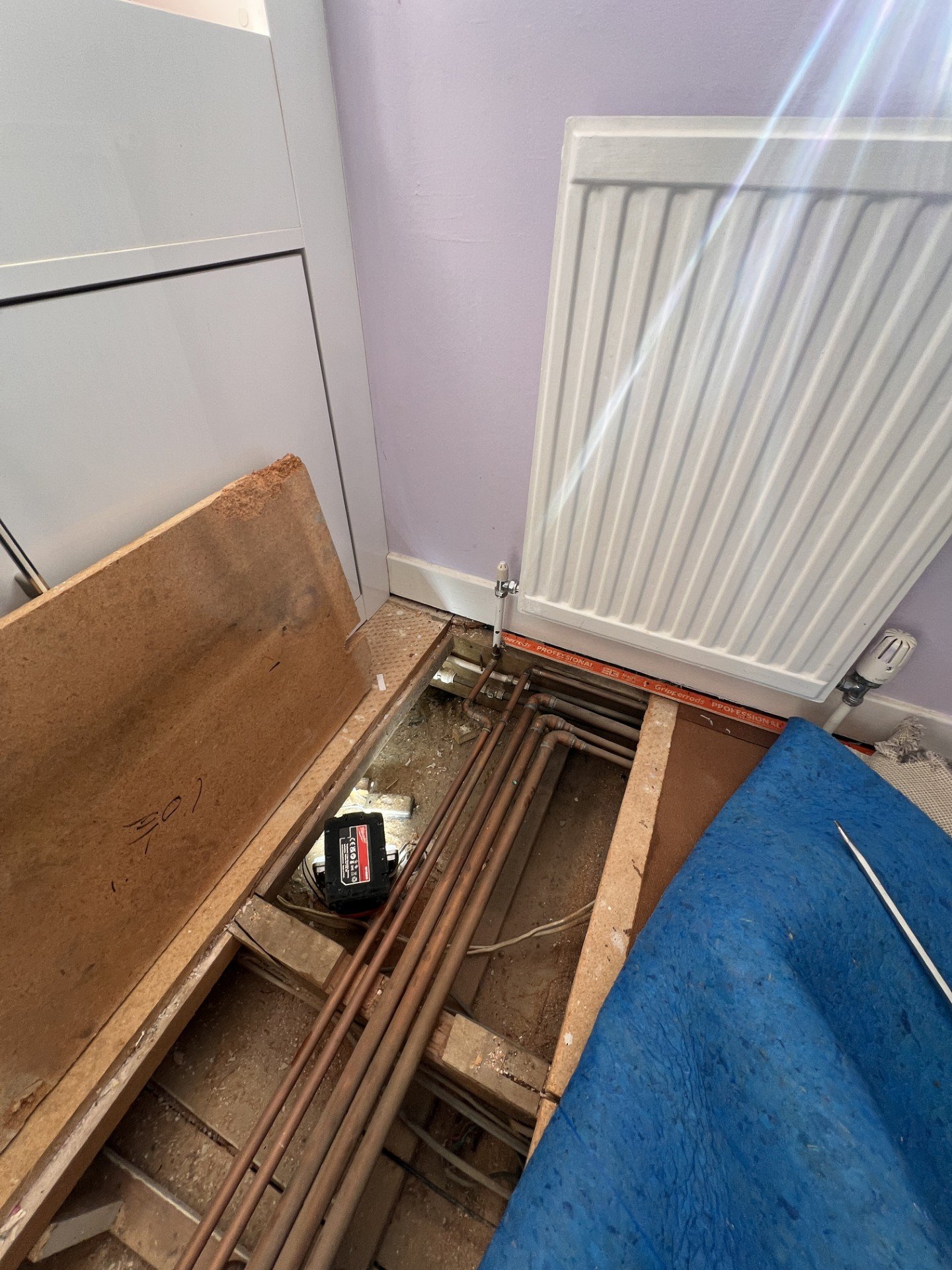

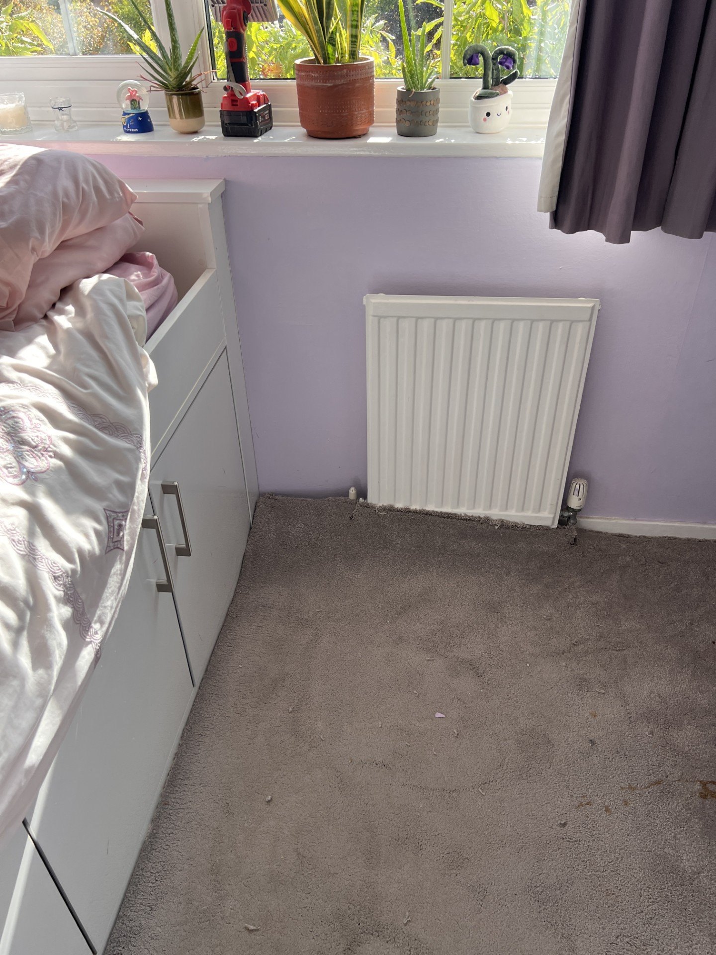

I wish I had used copper BUT because the property uses 1.2mx2.4m chipboard flooring and the joists are not directly below partition walls which makes cutting large sections of board difficult. If standard floorboards were used I could have used copper. The floor layout would mean HUGE chunks of floor missing in all bedrooms for weeks for copper whereas plastic only needs small squares cut out.
Most properties are now caberdeck or some such.
I've had them up and back down again and used copper... To replace the plastic that the place(s) was/were built with.

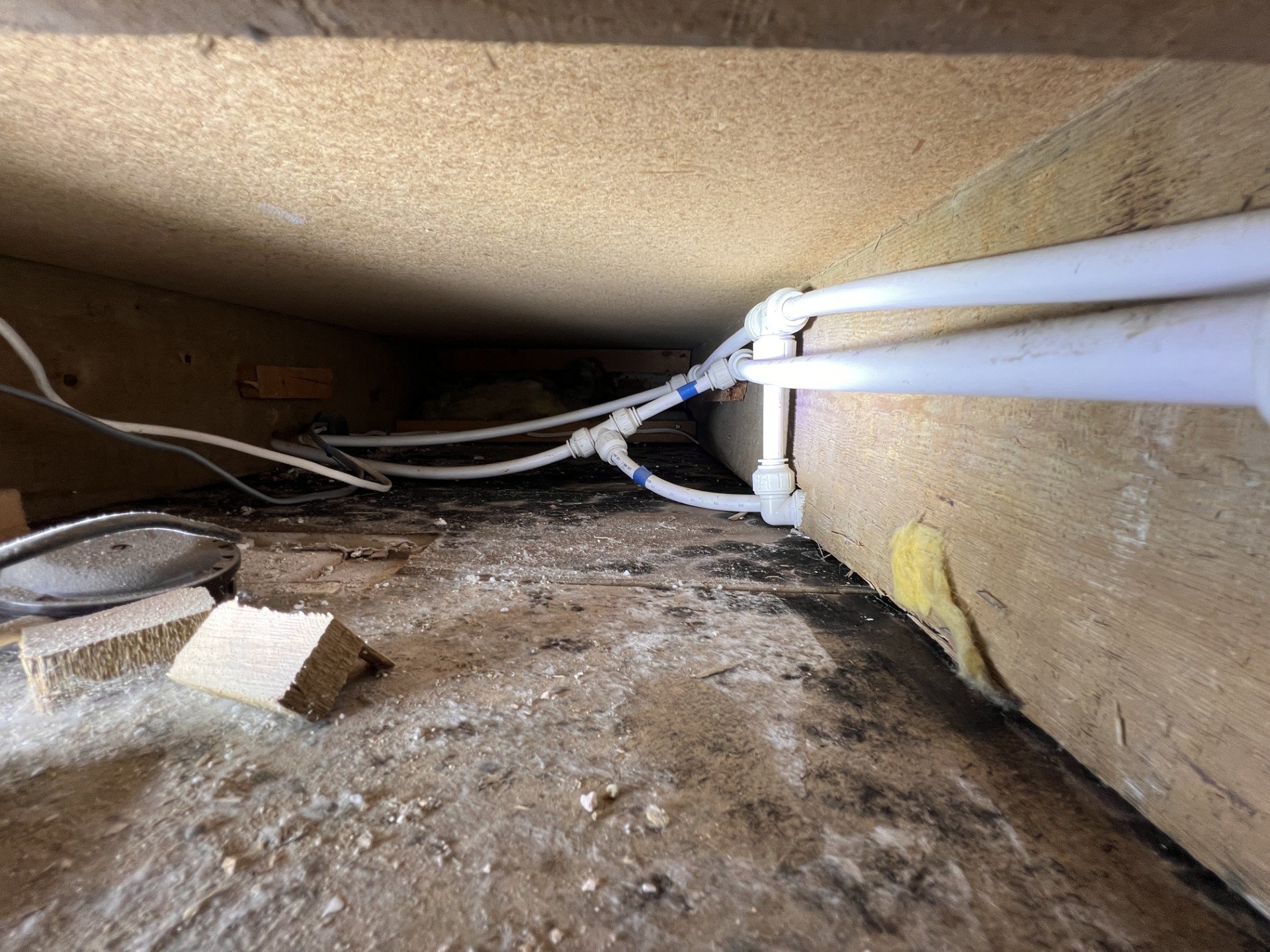

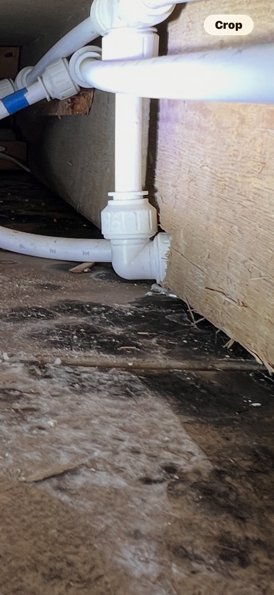

Called out to a leak from the ceing to the hall below, who is to blame, the plastic fitting or the plumber?
Andy
That 15mm 3 way plastic fitting isn't tightened on the right hand side. And overall not enough pipe clips
Couple locking nuts not locked there :)
