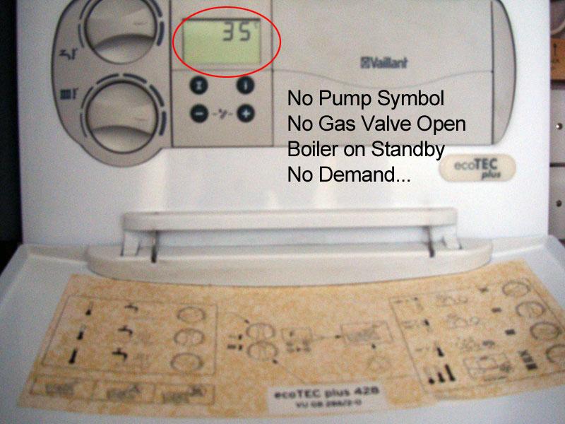

Hi,
The pump on my system has recently started to keep running 24/7, regardless if there is any demand for CH or DHW.
Pump = Grundfos UPS2 15-50/60
MV = 2 x Honeywell Model ?
Boiler = Vaillant ecoTEC plus 428
Searching on the forum, suggests the MVs could be faulty - however, the pump is wired directly to the boiler itself - the MVs go to a Vaillant VR 65 Wiring Center - with a Vaillant VR 360F Wireless thermostat.
So I am not convinced that one of the two Honeywell MVs are at fault? (They have the little bump on the casing, so can be replaced without draining down - so that is one option I guess!)
Any ideas? Thanks in advance :(
Sounds like the boiler is doing something it shouldn't. you need to get the wiring and the boiler checked by either an electrician or a suitably qualified gas safe engineer. The boiler gives the pump a 2 minute pump overrun and it could be faulty PCB.
The Valves control the Boiler only, the Pump is controlled by the Boiler, therefore it follows that the fault lies within the boiler possible PCB fault? :wink:
If your system is wired as a standard S plan then you could check that both the orange wires from the MV's are 0 volts (when system off) and thus proving the valve end switches are OK.

@ 45yearsagasman - yes, this is an S-plan, so great - I will use a multimeter to check the output of the orange wires from the MVs (which are not connected in the wiring center, neither is the grey) to at least put them out of the equation.

Thanks all, PCB was replaced - pump now behaving as expected / back in control of the boiler.
