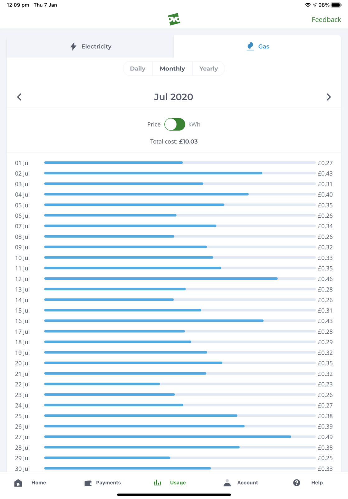

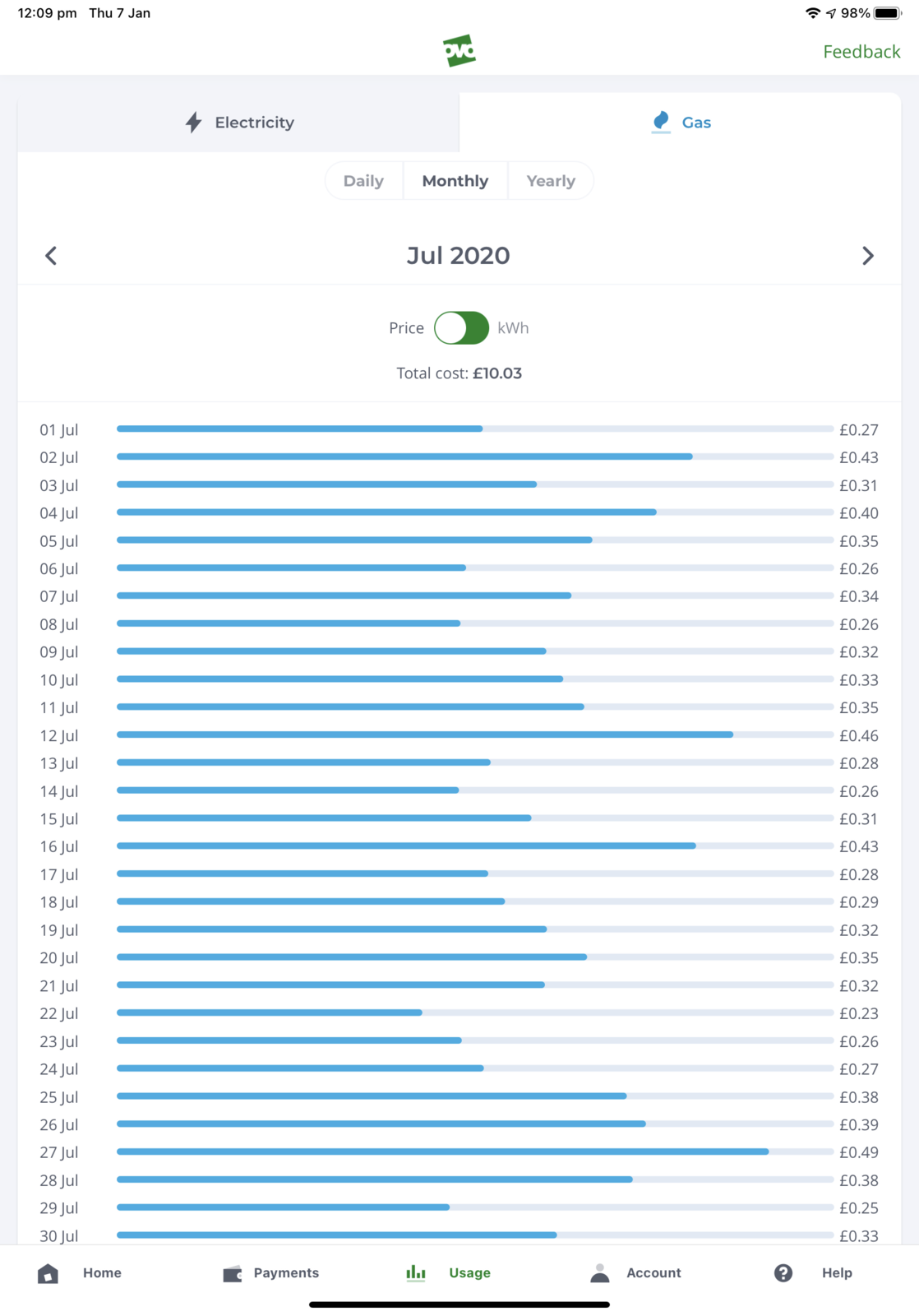

FWIW I leave my DHW permanently on. It’ll only heat it when needed and I’m always sure of a cylinder full of hot water. We have two long showers a day - sometimes the odd bath plus we have a gas hob. Looking at my gas usage in July when the heating is not used, it’s only pennies a day anyway.
Hi Mottie, when you say you leave it on, I guess you mean during the night. During my monitoring of the system, I determined that the cylinder looses around 4 deg C between 23:00 when it turns off and 06:30 when it turns on. That's with the hot water demand temperature set to 60 deg C, and I may even reduce this to 55 deg C and turn on the anti-legionella settings. A 4 deg C reduction overnight (in Winter i.e. last night) wasn't even enough to cause the boiler to re-heat the cylinder (as a priority) when it turned on this morning and it went straight to heat demand.
I can therefore imagine, as you say, it's probably not going to use much more gas to leave the hot water on all night, which would then allow for my son to have his late night showers, especially as it's unlikely he'll be returning to university any time soon. They only issue with the boiler operating during the night is that we can hear it as our bedroom is directly above the garage where it is situated.
