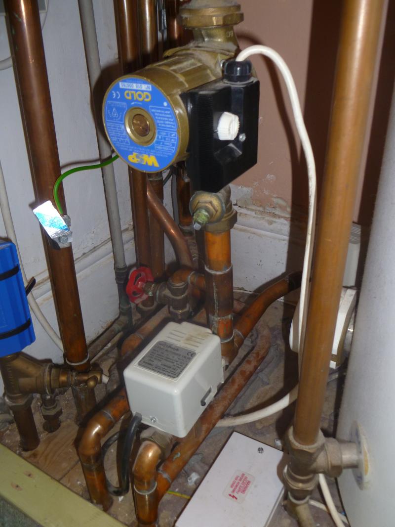

    Hi There, this is my first post and am hoping to find the answer to my problem, i have a pump next to my storage tank that will not stop running. I think the pump is for circulating the water around the central heating circuit and the hot water circuit. yesterday morning we used the boiler to top up our hot water which i used the 1 hour boost on the time controller. we got the hot water ok but noticed 7 hours later the pump was still running. The only way i can stop it is to isolate the power supply next to the time clock and hw and ch controller. there is also a thermostat on the side of my storage tank which is a megaflow cl210 on what i think is a sealed unvented system. there are also 2 x 2 port valves on this system and a room thermostat. could anyone help me to locate the reason? we think this may have happened some time ago as well but today after switching the power back on the problem seems to have self rectified for now!! any advice much appreciated, thanks.

    At the moment we dont know if this is the one heating pump or its a hot water loop pump.
    In the case of the latter then there would be another pump elsewhere for the heating water ( and that could be inside the boiler casing ).
    Can you post a picture showing the pump and the pipes connecting it to the cylinder?
    Tony

    I think there is only the one pump and 2 x 2 port valves. One valve is on the hot water loop on the bottom of the tank and the other controls the rads I think. I can post a picture when I get home later if that's ok.
  15. keggy
    Joined:
    8 Jan 2012
    Messages:
    18
    Thanks Received:
    Location:
    Lincolnshire
    Country:
    Hello again, If I have done I correctly there should be some photos of my pump and valves now on this post..It was hard to fit everything into the frame so if there's any more info you require other than this I will try to explain it. I think the valve you can see is for the central heating which we rarely use and the other valve is just out of sight on the bottom of the storage tank on the primary flow port of the tank.
