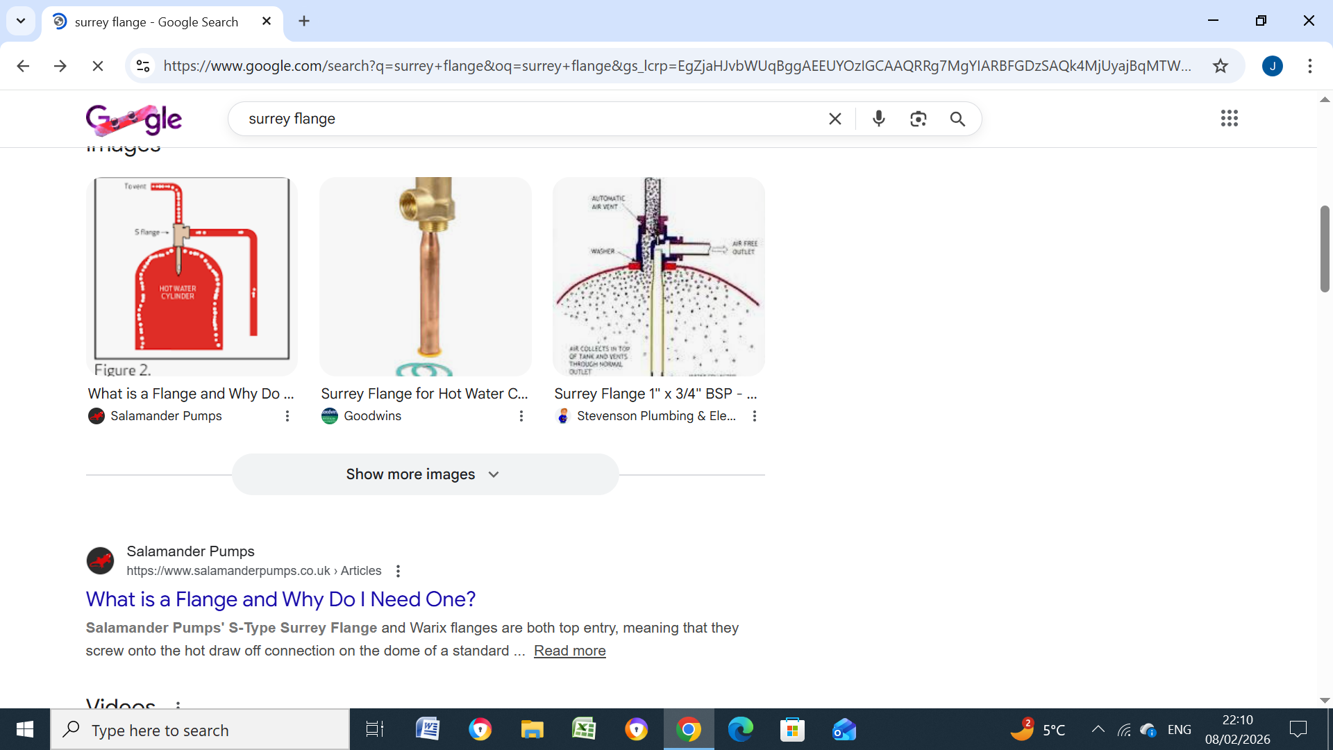

Yours should look like the attached, (if a Surrey flange). Take a photo if possible, and post.
Thank you so much and I do apologise for the delay - away from home at the moment.
Is this what you’d expect to see?
Many thanks!
The hot connection should be on the horizontal hot from the cylinder, before the tee, or on the vertical hot, below the tee.
If the horizontal right (from the Surrey Flange) is going to the Shower pump/valve and the vertical is the vent, then installed correctly? but the vent pipe should be sloping upwards with 45deg elbows until it connects to the vertical. What T are you referring to?.
