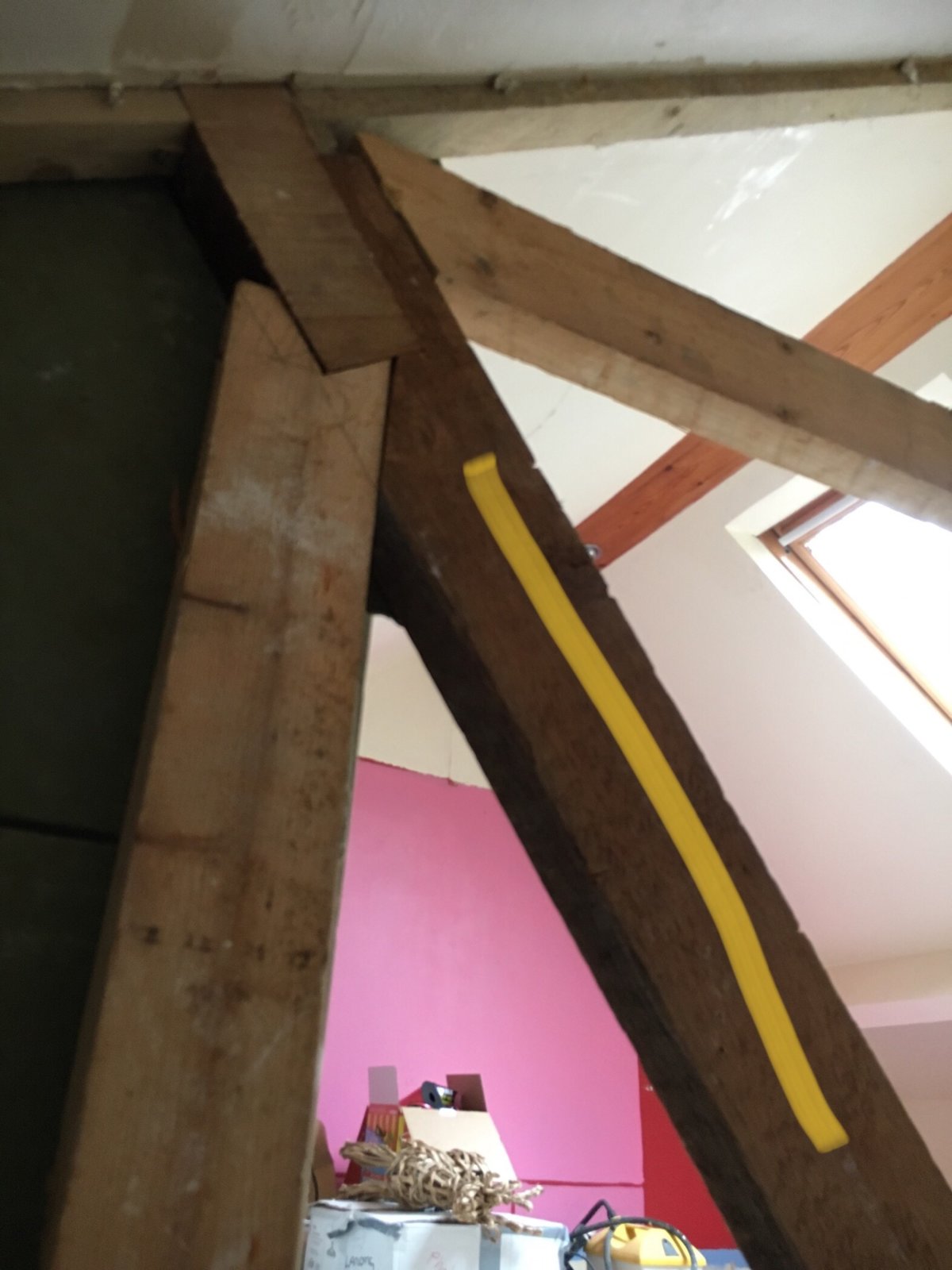

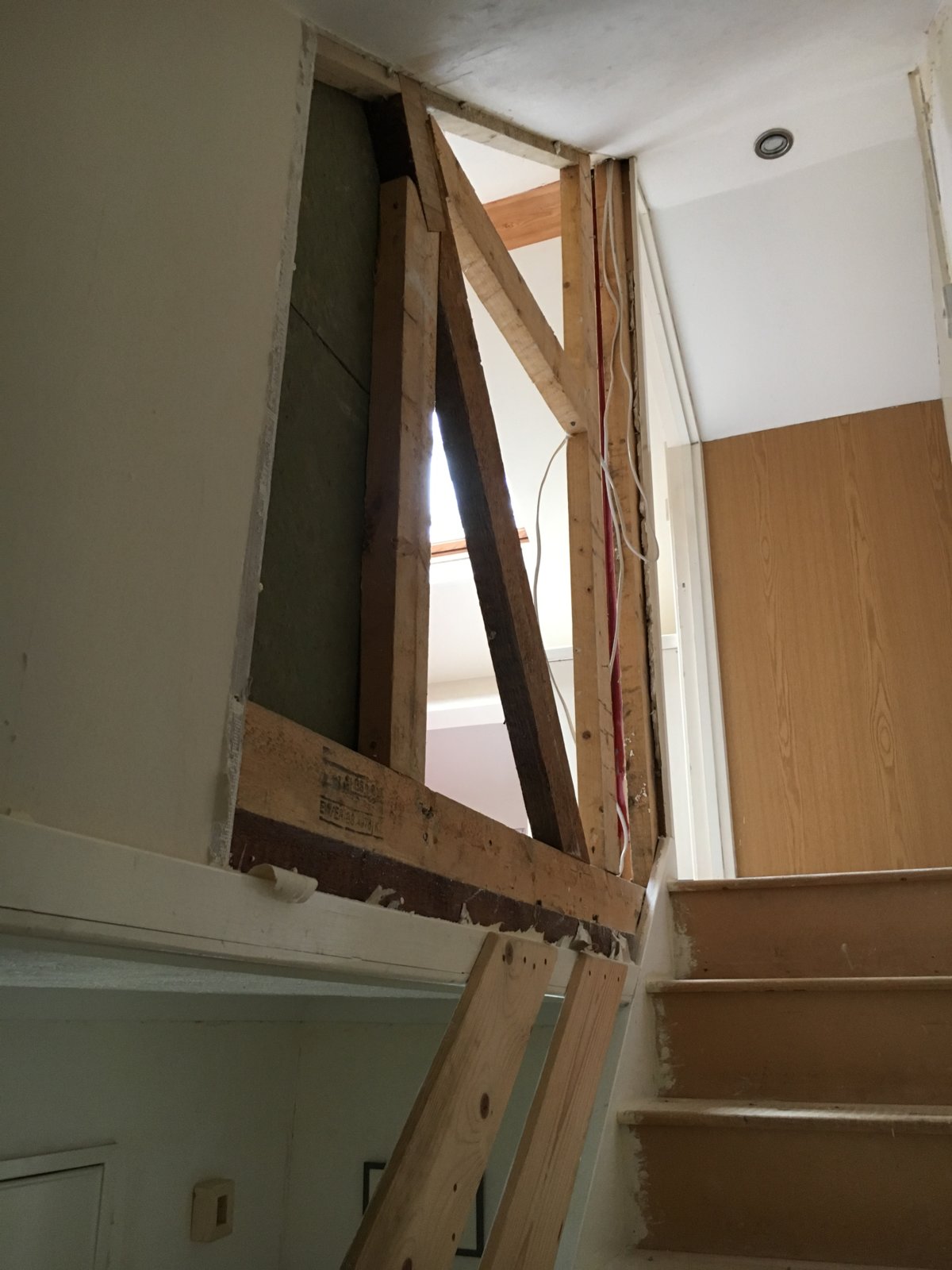

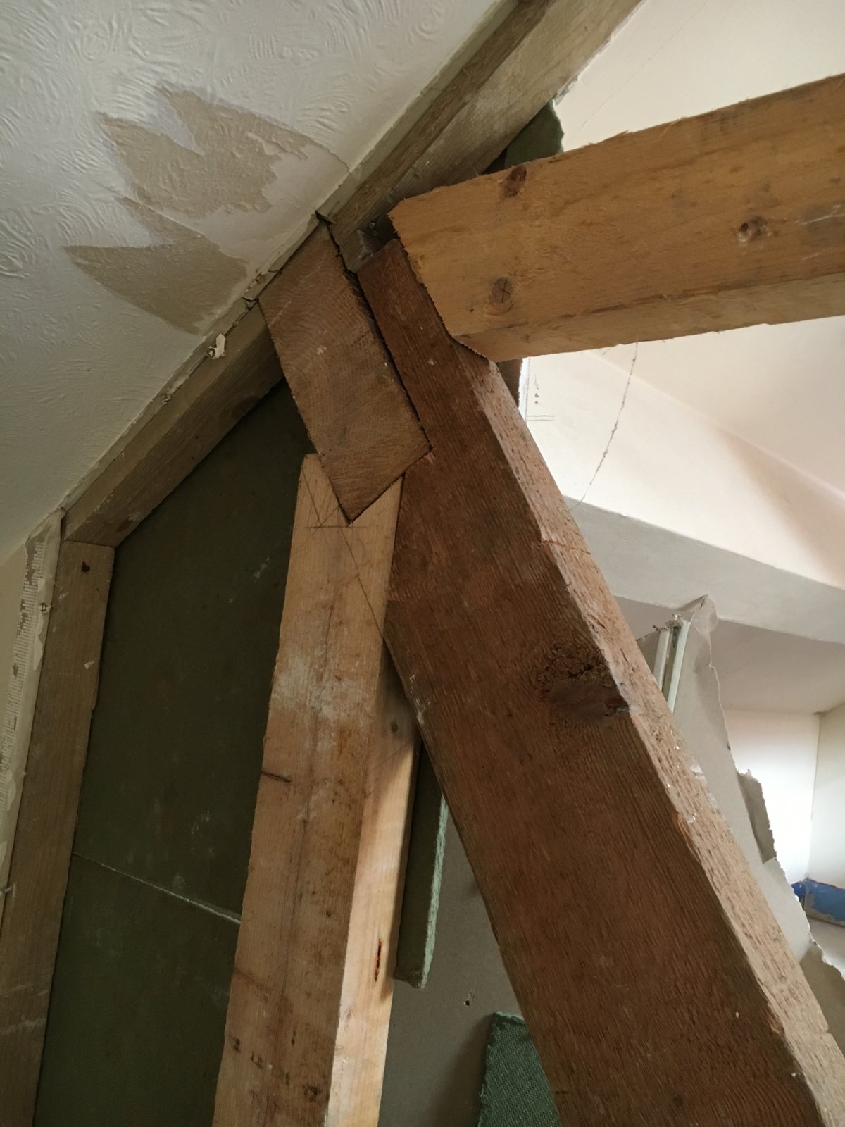

Hi I’m wanting to remove a small stud wall in the loft to put a handrail with spindles instead. I’ve removed some plasterboard and found how the purlin is being supported. Is there any way to support it differently so I could remove the highlighted timber? (Yellow line drawn in the photo) It’s in the way of where I wanted to have the new handrail.

That strut is transferring load from the purlin so should not be removed. Sand it and include it in an alternative design.
You need a structural engineer. All that propping is (I suspect) to compensate for the purlin having been cut short instead of running all the way to the end wall. The purlin is being supported- happy days- but what is supporting the 2 or 3 rafters above the stairs?

Bloddy hell!, that is the end of the purlin as you say. Looks loke it has been cut short after the house was built/ loft converted?.
yeah you're correct its been cut, i did wonder about those rafters above the stairs, presumably they were doubled up to give them enough strength? Its a loft conversion that was done about 12 years ago by the previous owner.

You can assume what you like but when reality bites you'll be sorry you didn't have a look. From the way that purlin is supported I'd be amazed if building control were involved, did you get any completion certs when you bought the place? If not then get a structural engineer in and be prepared to drop the ceiling above that staircase to see what is holding the roof up.
How's the fire separation on that staircase anyway? Any means of escape from the loft room if the main staircase is unavailable? Sorry to rain on your parade but you may have a few more urgent items to address than modifying a handrail.
