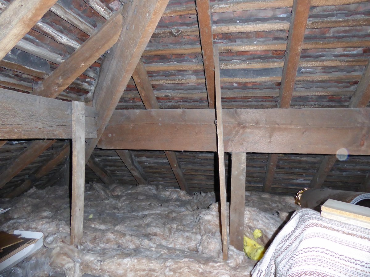

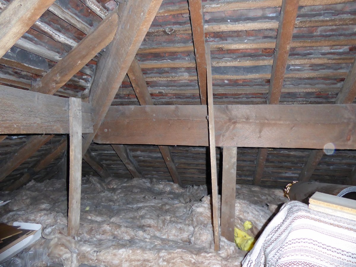

is this providing support for the purlin?
4 Apr 2012
9
Manchester
Just wondering if anybody can tell me if the purlin is being supported by the vertical wooden strut to the right of the picture? Does the hip rafter keep the purlin in place if this strut is removed?
There is a brick bedroom wall below this wooden strut, but the wall does not provide support to the ceiling joists. I want to remove the bedroom wall, and despite 2 people telling me they "think" it is safe to remove this wooden strut, i am still having my doubts.
Any advice would be appreciated.

Thanks for the reply Woody.
Do you know what additional support could be provided to enable me to remove this strut, or do i need a structural engineer?
The one under the purlin is a support for the purlin, the other 2 will be to stop the ceiling sagging.
I would guess that the support goes right down through the brick wall and into a base plate of timber under the wall. It looks exactly the same as ours.

Assuming you have a central brick load bearing wall in the centre of the house you would need a structural engineer to design a beam to go from the front wall to the centre wall, taking into account the point load from that support.
You will need a beam, which could potentially be a couple of timbers bolted together, rather than steel, and this will need to span across somewhere to support that post, or a new post in a different location.

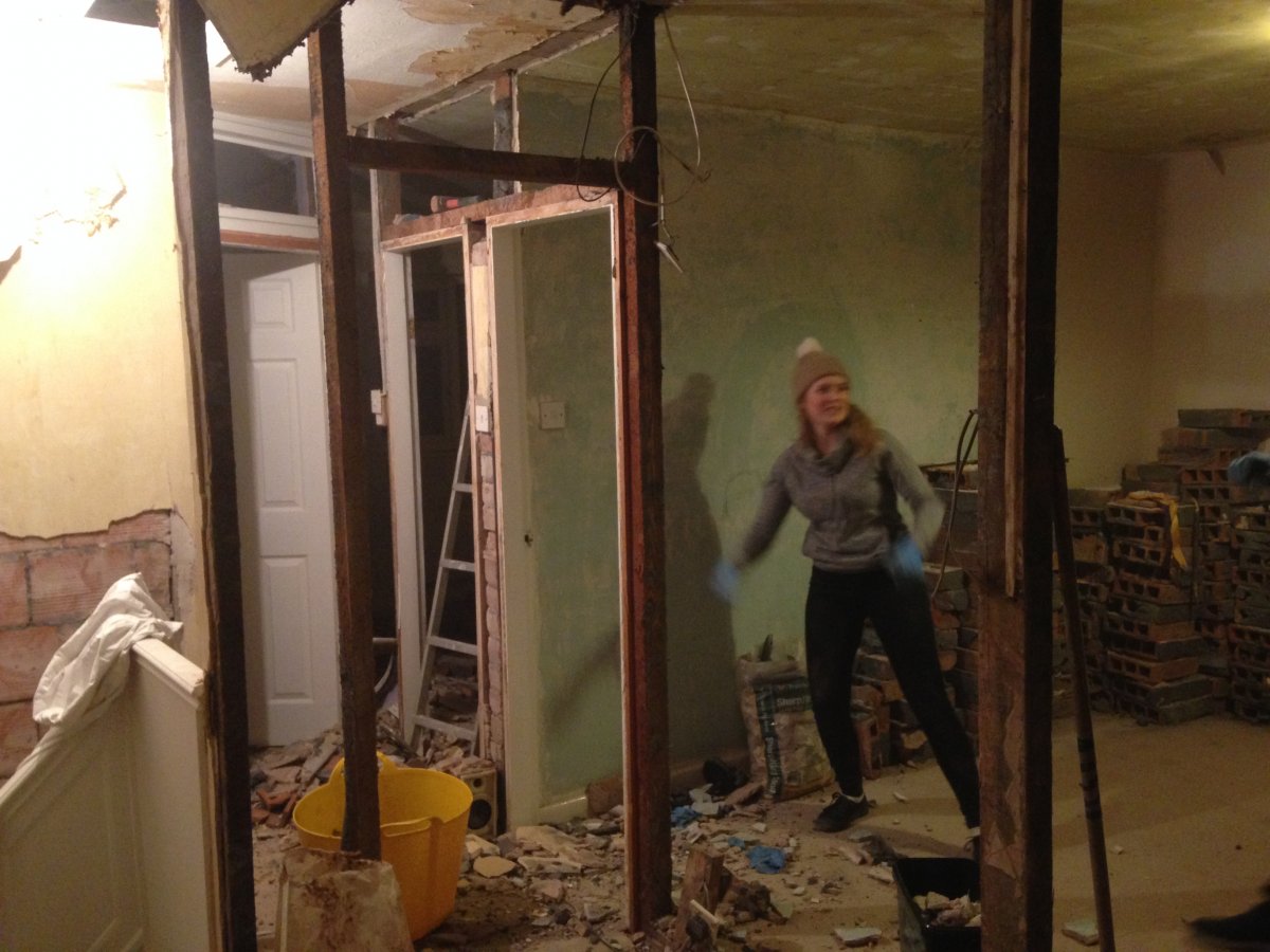

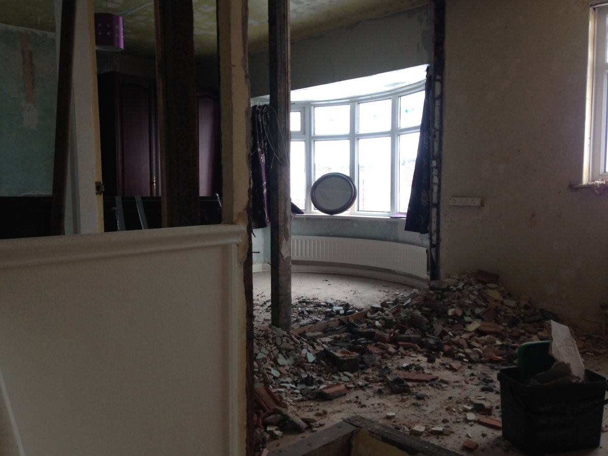

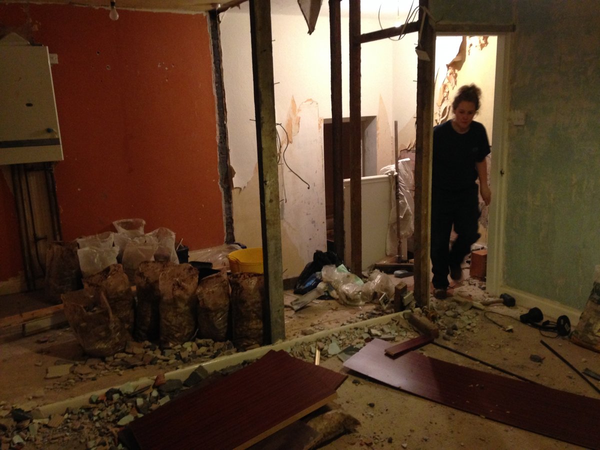

We removed a wall below in the kitchen so put a steel beam across the kitchen ceiling, a block wall ontop of that and reinstated the same support that your on about. We had the purlin propped with acros either side while we did it.
I'll try and find a photo.
There you go. I'm not sure what dance our daughter is doing.
Left alone over time that support may bend. That just my thoughts, I'm in no way qualified to give you any proper advise, only what I've done myself as a DIY'er.

yep that's supporting the purlin and the hip rafter doesn't support the purlin

How long is the purlin, and are there any other supports. Those are damned big purlins, and I wonder if the support was just to hold the purlin in place during the roofs construction. I think at the end of the day, it's going to be an SE that gives you a definitive answer, including an alternative method of support.
If there isn't a central load bearing wall, then how far down does the wall under the support go, to the first floor, or down to the ground floor.
