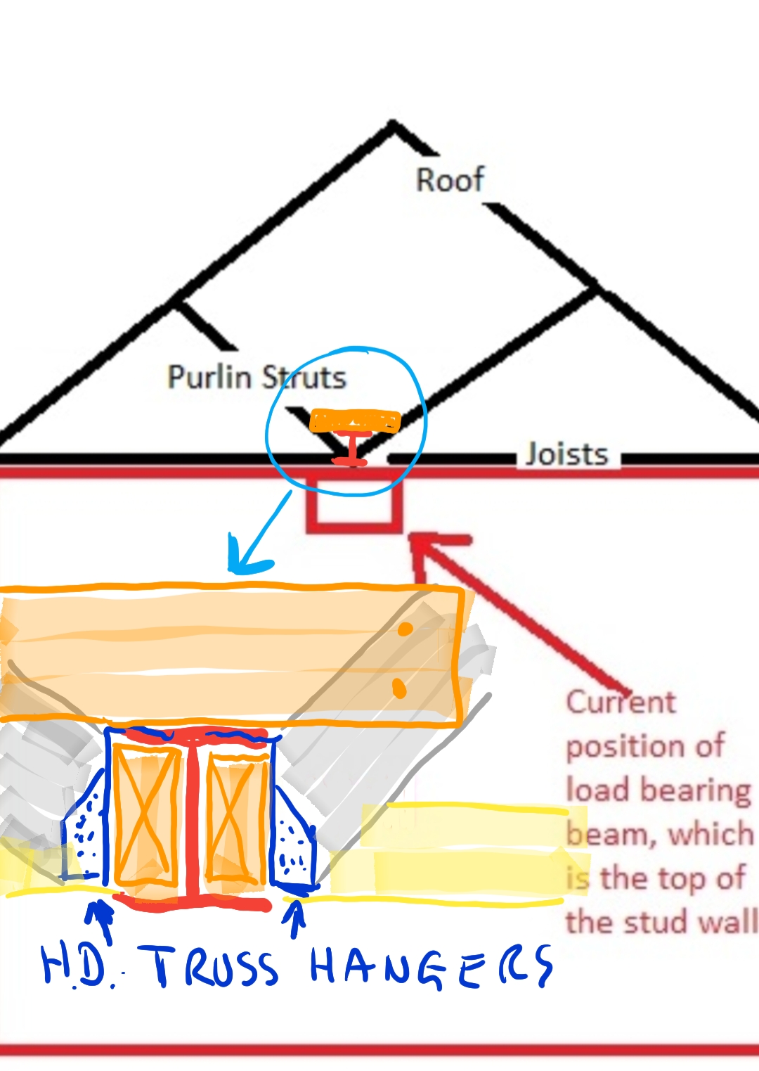

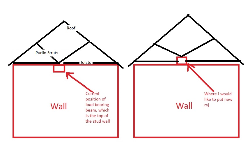

Hi, this is my first post so thanks for any help that i get!
I am removing and upstairs stud wall from an 1840's cottage, that is perpendicular to the brick walls at either end. The wall has 2 purlin struts sitting on top of it supporting the roof. I have had a SE round who has done all the calculations for the size steel and the padstones. What i would like to know is, is could i set the padstones flush into the top of the wall and have the steel sitting on top of the walls instead of set into the walls so that i can avoid lowering the ceiling. And if so, how would i go about stopping the moving under the force from the purlin struts?
Thanks again!

He worked out his calculations with it in the same place as the current beam, with the top of the beam flush with the top of the wall, what i wanted to know is whether i can raise it 100mm so that it sits of top of this wall instead of in the wall flush with the top. With regards to the purlin struts, if the beam is sat on top of the wall, how would i stop it moving horizontally, and sliding across the top of the wall.

Sorry i took so long to reply. Here is a drawing to try and explain what i mean a bit better.

Looks like you would be cutting into the ceiling joists and the struts :cautious: You need your structural engineer's advice on whether this is possible and how it might be done.
Basically you want to insert the beam at a point where all the roofs connective strengths come together?
:eek:
It would be simpler to conceal the beam with a lowered false ceiling. Or re-build the roof?

If he temporarily supported the purlins during installation of the beam (which he is surely going to have to do while he removes the wall) couldn’t he relocate the purlin supports into the web of the beam, rather than on top?
He’s still got the problem of preventing beam moving sideways after installation, but if it’s sitting on brick walls I wouldn’t expect that to be much of a problem, assuming he has room to add a few bricks each side.
To OP, are the walls gable walls, hip roof or eaves?
Use 2 new steel beams and put new struts at 90 degrees?
