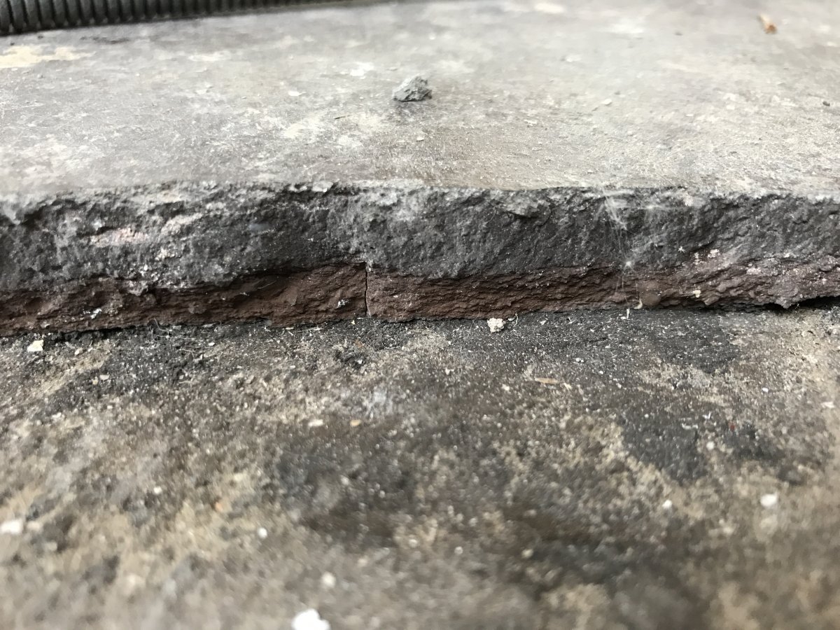

The downstairs of our house is solid floors with about 20mm of black/purple stuff on top of concrete.
In the hallway it's in very poor condition all around where it had a 10mm gas pipe channeled into it.
Is it any sort of damp proof layer or is it more of a leveller?
Could I chip it all up, insulate then tile the floor? Or should I repair it and tile on top?
Isn't it a dpc layer between the sub floor and top floor?
Is your house 50's?
Possibly asphalt? Hard as iron and chips rather than breaking. Needs an SDS to drill it
Yes, it is a 50's semi and the stuff has fractured, seems hard but brittle.
