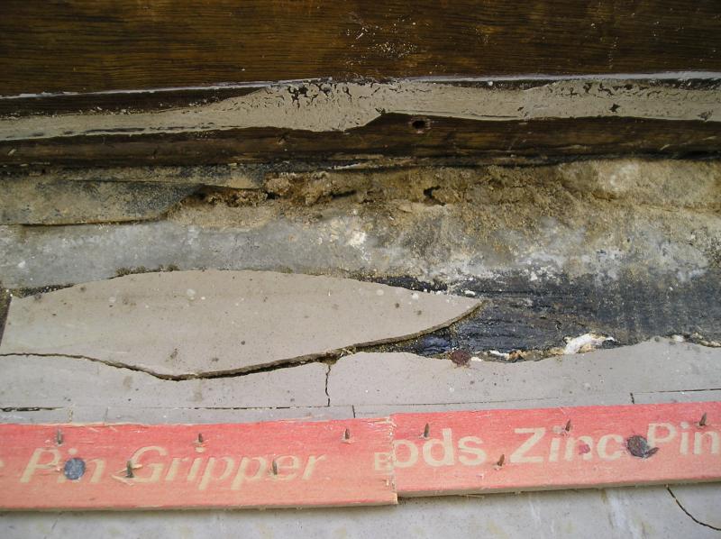

Just going back to this, I've noticed that at the point where the concrete floor meets the outside wall at the base of the patio doors, there are lots of little holes and gaps (see picture), which could well be the route that the neighbourhood ants took when they invaded this summer.
What would be the best way of smoothing and sealing all this mess? It would be nice to have some kind of liquid sealant that would actually run down inside these small holes and cracks before solidifying.
The carpet that I've rolled back, when the new doors are fitted, won't quite reach the new doors (the old doors had secondary double glazing, removed in this picture, and the carpet had been cut to reach the edge of that - note the large gap between door and gripper rod).
So I want to put a strip of lino in the door recess and cut back the carpet so that it doesn't enter the recess at all.
So any advice on: (a) sealing the holes (b) getting a smooth surface and (c) fixing lino on top - would be gratefully received.
I would suggest a piece of timber - cut to fill the recess. Use a silicon sealant to fill any gaps and then drill and plug the timber in place. Stain and/or varnish and run the carpet up to this which would then be flush to the wall.
