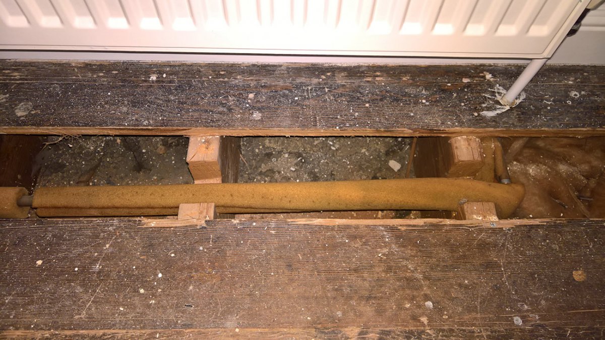

I will only put the insulation under the radiator pipes against the wall with the radiator as this will need better heat insulation. It is a bit frustrating there is nothing between the void to block out sound as I can hear everything downstairs and I'm sure they can hear me :(
here's where I'll put the new insulation. Need to clean out all that debris the bodgers left behind when they did all the plumbing years ago. I like to know its all clean as I'm sleeping next to it all and I got OCD :D

Fair enough, although I don't think that will actually achieve very much.
I can understand that, but doing anything (effectively) about it would, at best, be a much bigger job, not the least because it would almost certainly involve getting all of the floor up.

I know from bitter experience - you can stuff as much insulation as you like between the joists. The sound is actually transmitted through the joists.
The only satisfactory way is to have alternate joists vertically offset and supporting floor and ceiling respectively, PLUS void insulation. Doing as retrofit is not practical. There may be other ways if you are prepared to raise the floor, but this has usually unacceptable ramifications.
underfelt and carpet helps. Bare boards are bad.
so does thick plaster on the ceiling with no gaps (e.g. round pipes). After having an L&P ceiling remade with thick lime plaster I was amazed at the difference. Impractical for you though if flats.
dense mineral wool batts muffle some sounds a bit, e.g. speech or TV.
