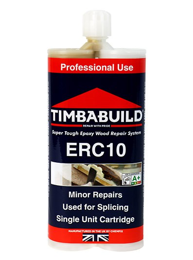

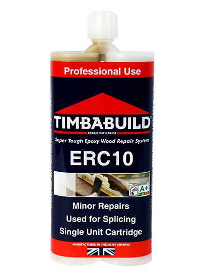

On Friday I put a double barrelled tube of Timbabuild ERC10 epoxy resin in to the gun and dispensed some, which I then mixed and applied to timber.
On Monday, I noticed that it was still very soft and would not sand back. I had to remove it with a sharp chisel.
I soon realised that I had absent mindedly put the tube in the gun the wrong way up. I can now confirm that the label on the tube saying "important- put this way up" is there for a good reason.
We live and learn...
Good stuff that timbabuild, dries slightly flexible.
