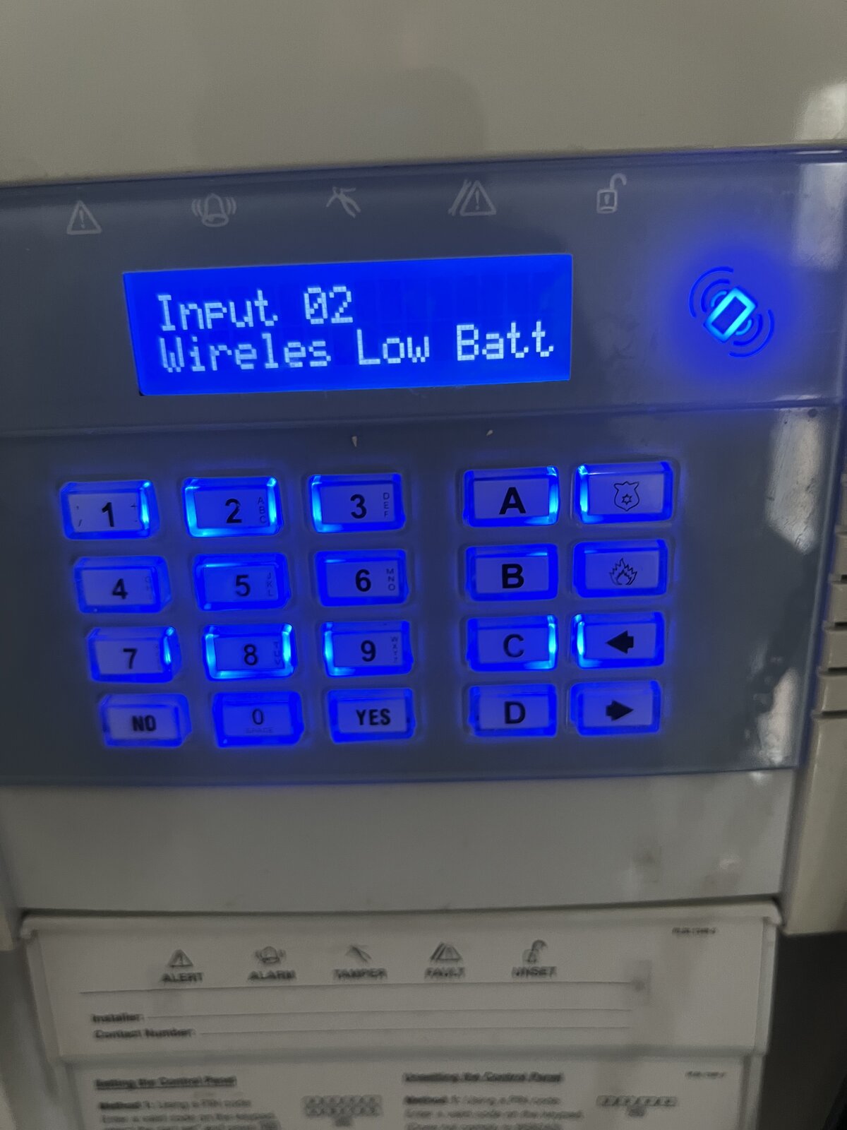

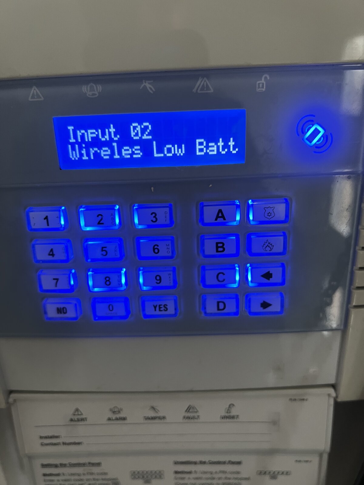

Hi all for a fairly old alarm pyronix 8-9 years old maybe but I’ve only had a couple of years as new homeowner
I believe attach shows that one of the sensors has low battery?
Can anybody pls advise how to change battery?
(I have “engineers code”)
I don’t want it going off whilst I try replace it..
Also what type of battery does it take? Then I can have ready before I try replace….

Hi,
Sorry, not an expert, but Pyronix lists two types of sensor battery on its website:
So it will be a 3V lithium CR2, or a CR123A. You may have to investigate the sensors further and tell us what you have.
...and if one battery is going, it's probably worth changing them in the rest of your sensors, while you're at it! :)
Show us a photo of the inputs and we can work out what batteries or alternatively punch in the engineers code, open the sensors up to check what batteries are needed, order them up and do this again to change them when they come
You are as well changing them all
Yes,change all the batteries in all your devices at the same time,this way you stop any other battery faults as you do not know how old the existing one's are.

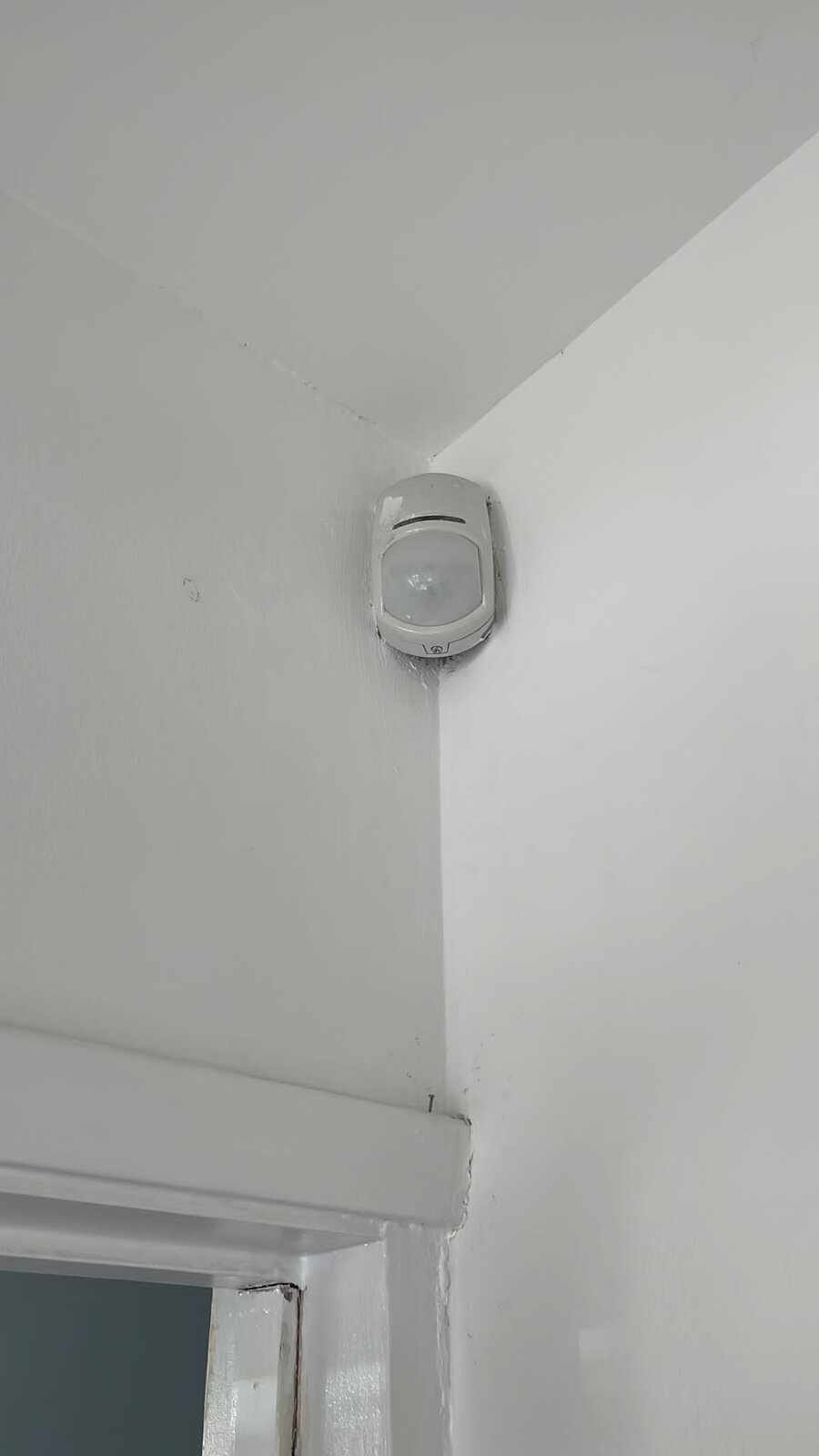

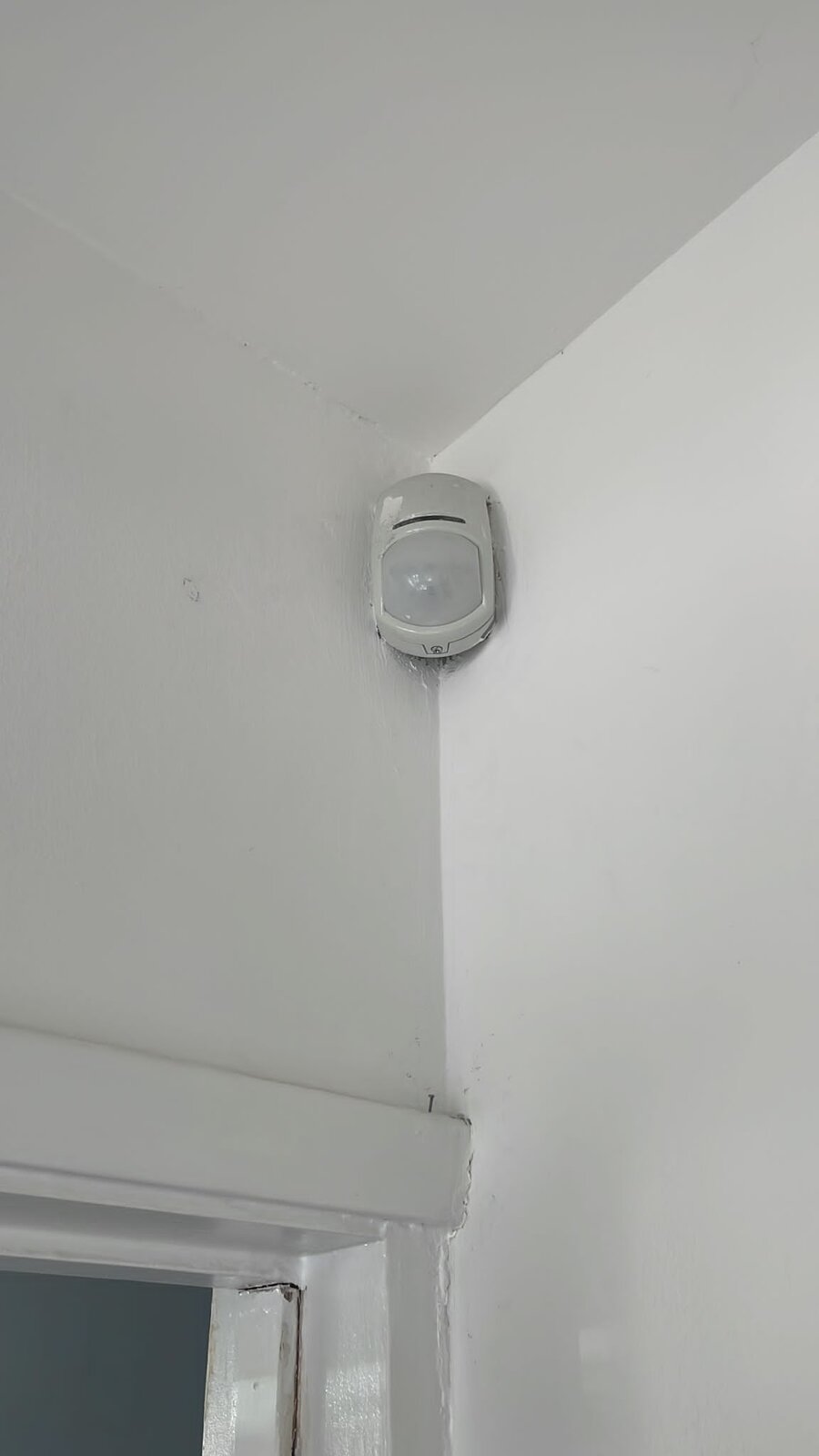

Pls see attached the sensor
I think they are CR123A
I will enter engineer code tonight and open sensors to check
And yes replace all same time - good point!!

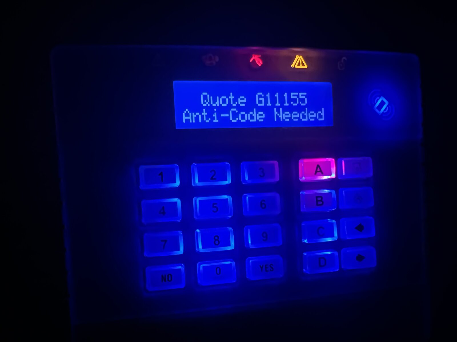

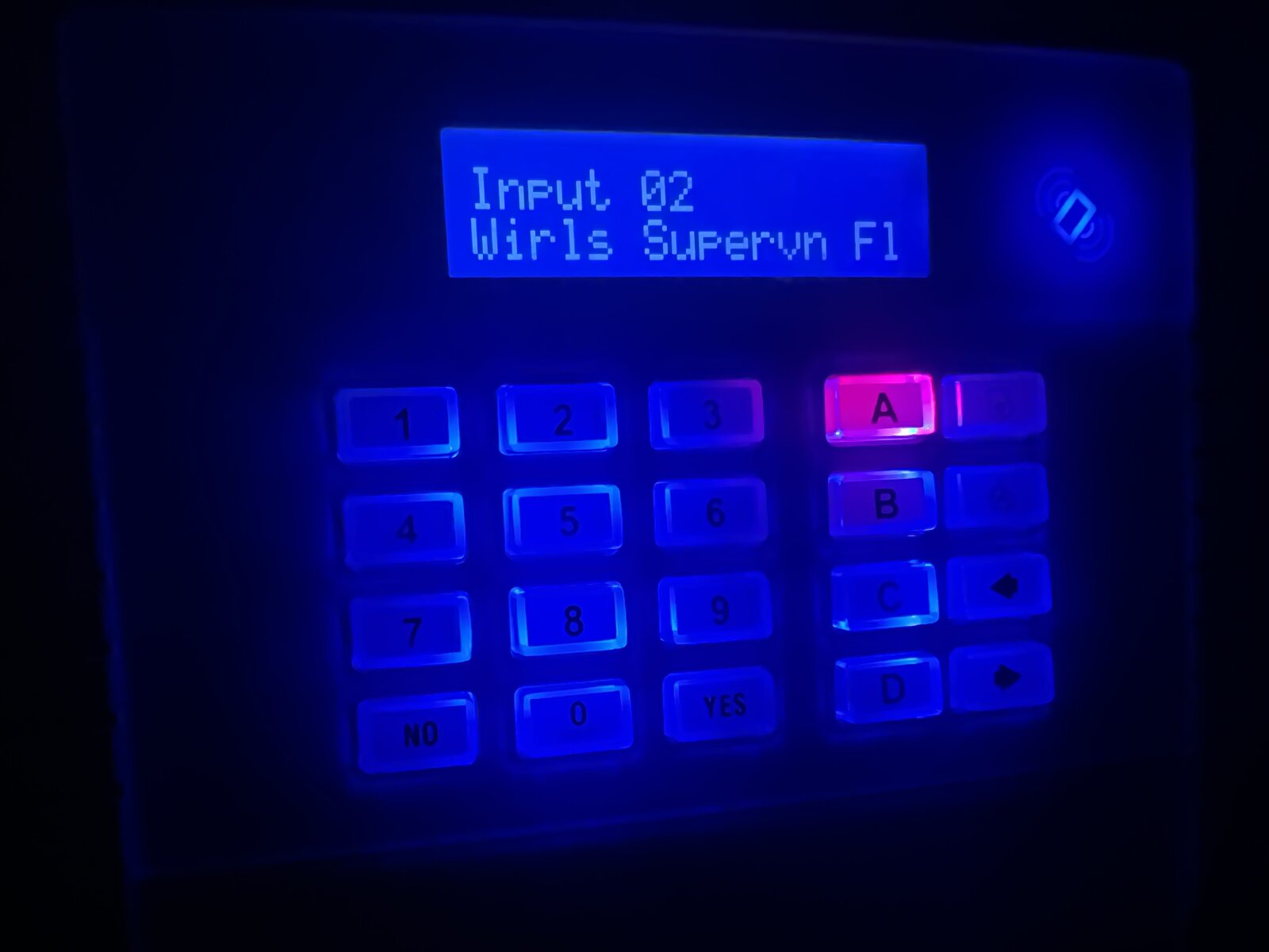

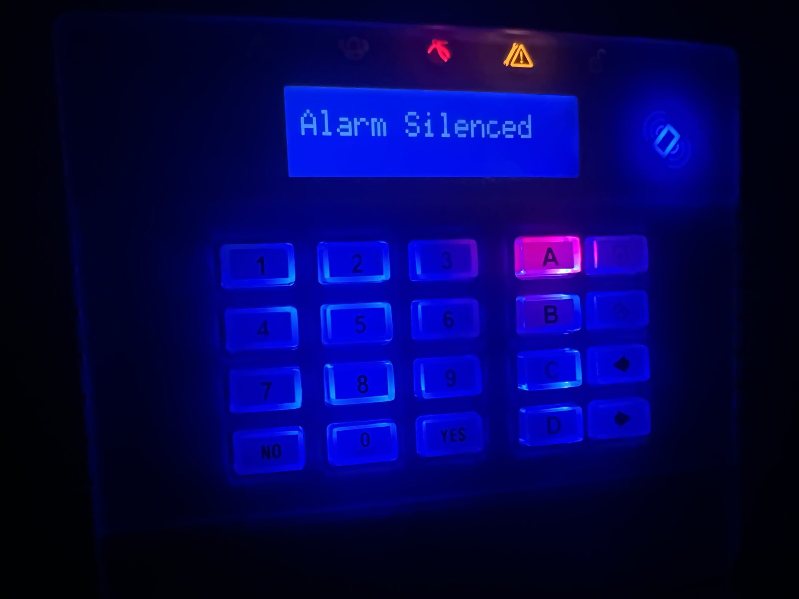

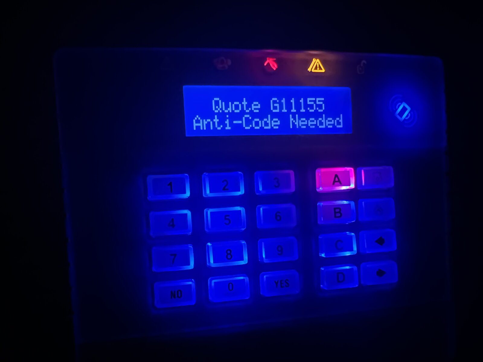

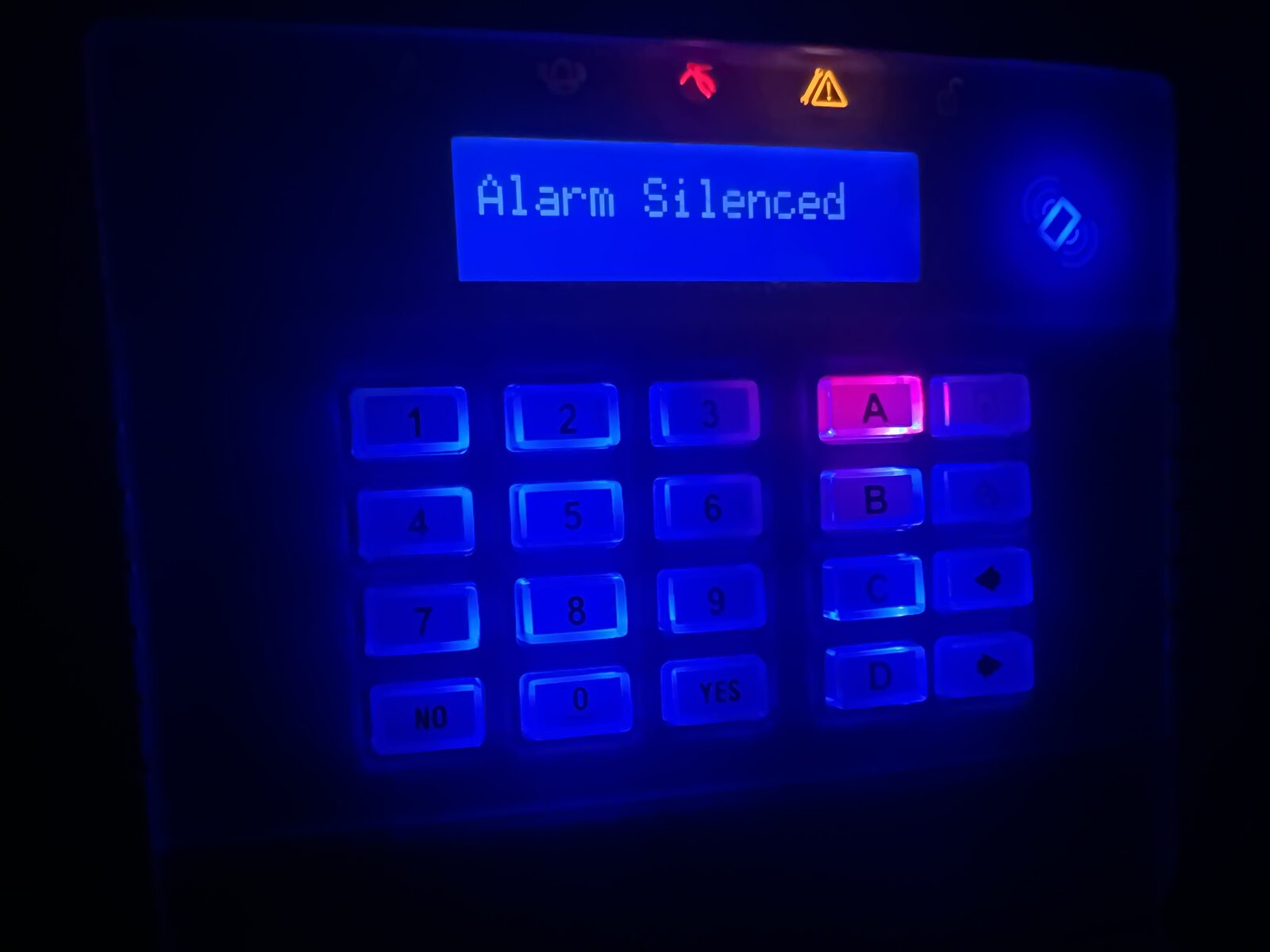

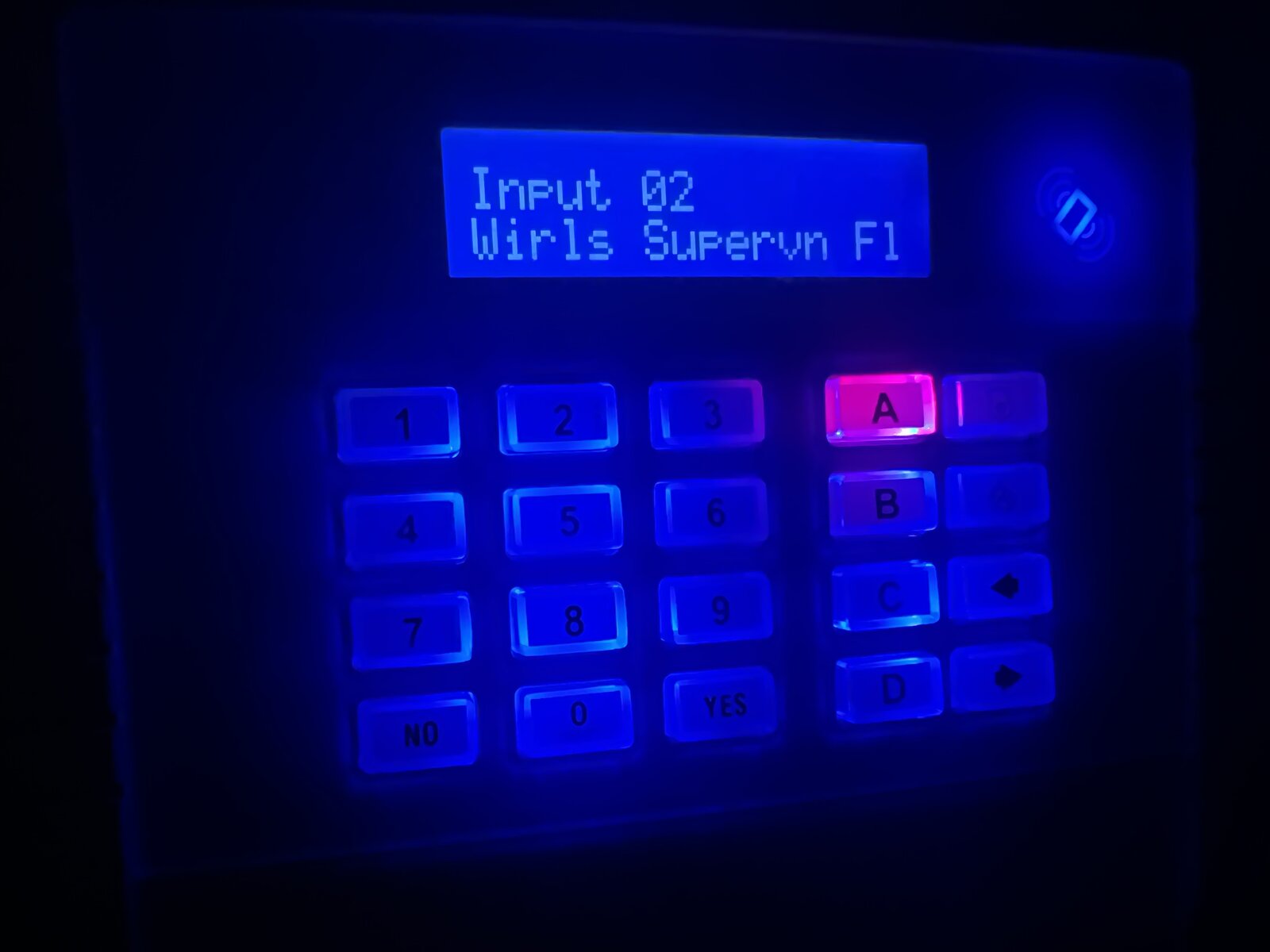

Unfortunately it says something else now….see attached please
Before I’m not sure what it said…but it’s certainly yeh right code cos you can press yes to “exit engineer menu” after u keep pressing no….
Not sure what to do now - any help appreciated please!

Your system is asking for an engineer reset.
Go into engineering ,change all batteries then exit engineering should clear fault.
Once you have cleared fault you then go into engineering and change alarm restore from engineer reset to user and turn off anti code reset as well.
