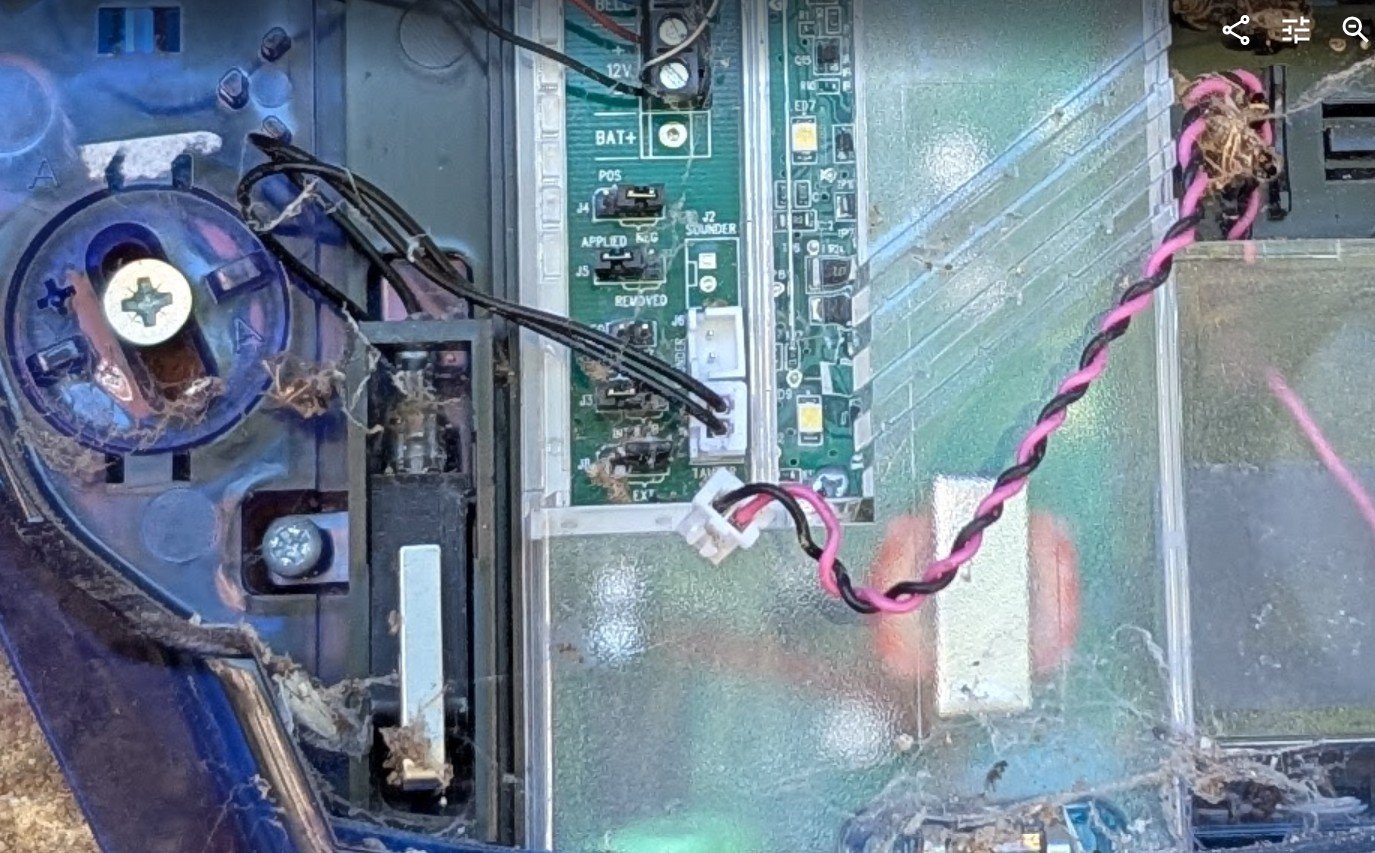

When I went to replace the battery over the weekend, I found what’s shown in the attached photo.
It appears to be hard‑wired, but it’s using the cylindrical-style battery instead - BATT-CR34615D . Given that it’s also hard‑wired, what’s the typical replacement interval for this type of battery?
As I didn’t have the correct battery with me, I didn’t take it apart any further. What’s the correct way to access and replace that battery?

I think I have just confused something else on that board with what I thought the battery. I suspect I actually disconnected the siren and I thought that cable led to the battery but couldn't see as it's obscured by that mottled clear plastic over the top.
It sounds like I just leave it alone until I get the error light, thank you

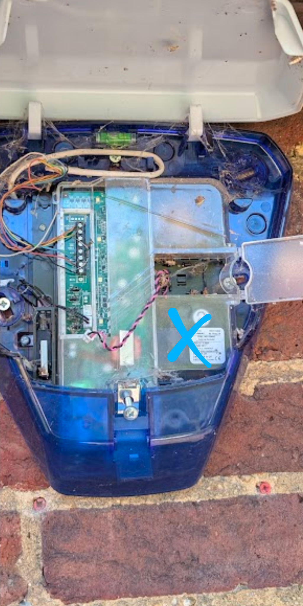

I thought it was where the X was, as it had a lead running from it, and when I pulled it. The siren stopped.
However in hindsight, I bet that's the siren and even pulling the battery wouldn't make a difference given it's hard wired.

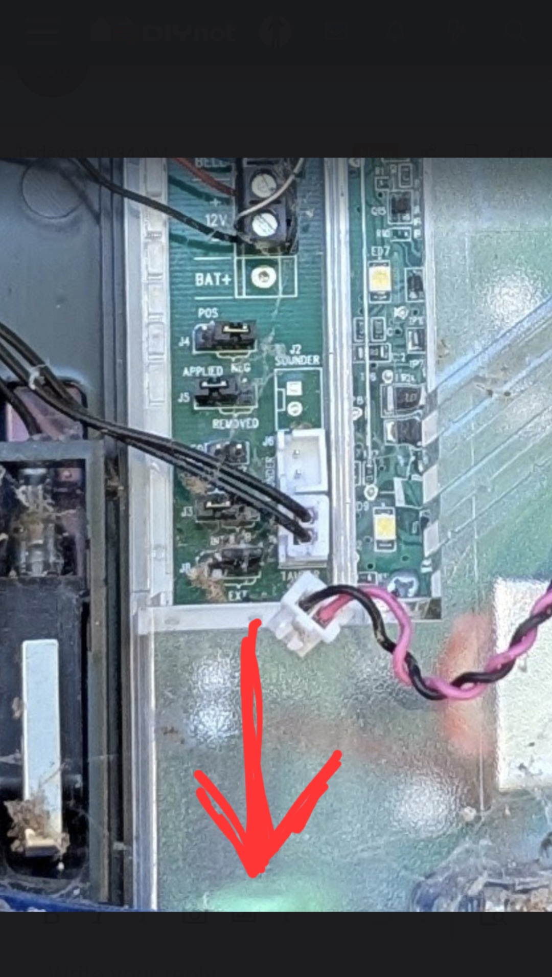

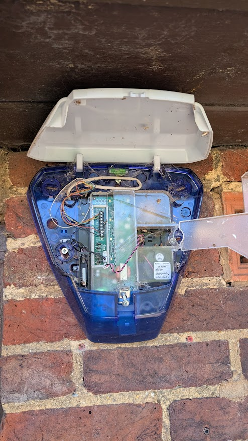

Looks like the battery isnt turned on either... move the bottom jumper pin over to the left
Your eye sight is better than mine
And mine , I do have some closer up pictures. Will move it across to the left, as does seem to be the right. So presumably it can't use that orange battery if the mains was cut.

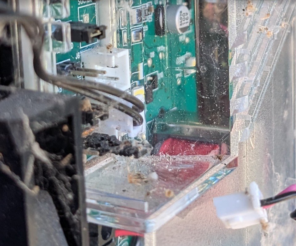

This is the battery below the red arrow. The battery would only be called upon if there was a total power failure, or if set to SCB
When you have switched the jumper pin for the battery over, remove the 12v supply to the bell, if it rings then you do not need to replace the battery.
