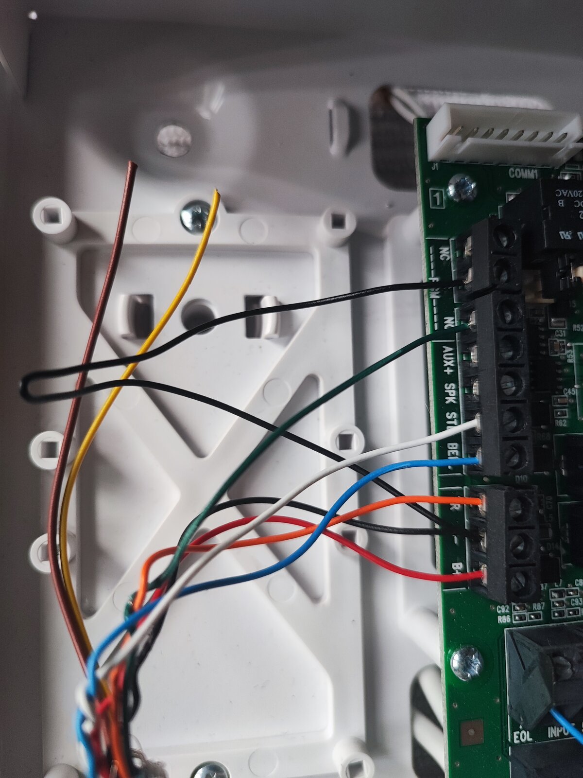

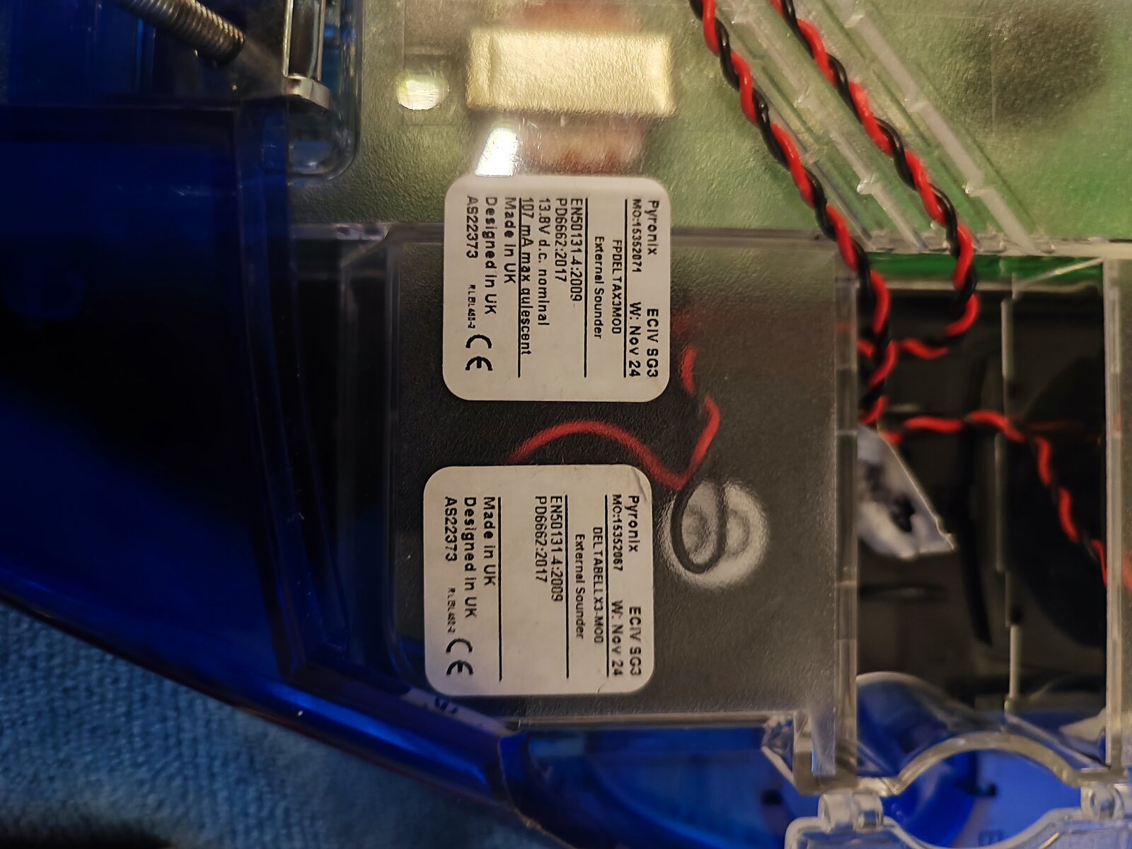

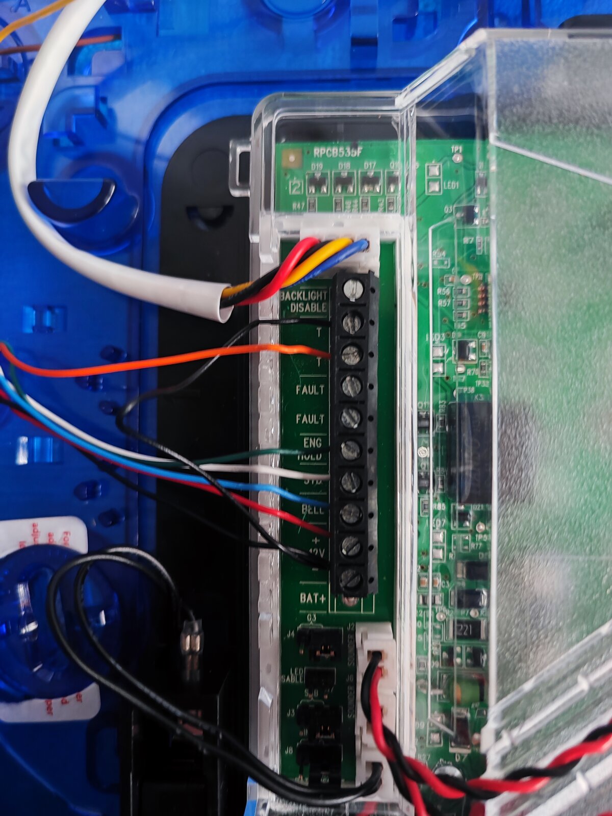

Hi
I have set up my new alarm system Pyronix Euro 46 Version 10 on the bench before install and on fitting a Deltabell X with Lightbox
setup as Photos attached it rings the bell sounder on entering Programing eg 1111, I have also programmed the hold off to 0059 and connected to
NO and linked 0v to C.
Any Help would be great

Change outputs
Endstation outputs
Bell O/P 0059 Engineer Access
Shoul I be Able to meter open and closed on the N/O contact after the 1111 Code is input
You have changed the bell output ….that why it’s ringing …you need to set the relay to engineer access and change the bell output back …
Sorted Very Helpfull Thanks
