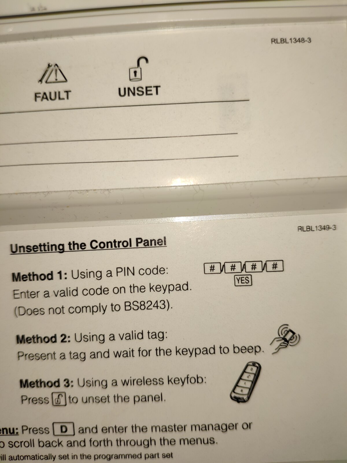

Hi there
I hope your all well.
We have left the company that installed our alarm and the monitoring service they provided too.
Basically I would like for it to phone or send an sms if the alarm is triggered.
I have not much knowledge about these alarms and I have tried googling and not gotten very far and hope someone can help me.
Thank you

Hi
Its not connected to the phone line or WiFi. It uses a SIM card I think. And I'm unsure about if it's fitted with a digi1200 ptsn module.
How can I tell the version?
I can access the manager menu though.
Cool, that's fine I can get that sorted but how do I actually set it to dial/text out from the panel? Can it dial out or is it only a text?
I've opened the control panel before as there was a problem with it so I'm guessing the sim will be around there somewhere so I'll just get a SIM and install that.
The control panel has RLBL 1348-3 and RLBL 1349-3 , if that's of any help?

It’s not going to be that simple …. Without knowing what’s installed inside the control panel for a start , also you would probably need the engineer code to check what is programmed on your panel to adjust as required …
I could open this up and take a picture. Let me know and I can try that if it helps.
Also I have the engineer code, I can access that section of the control panel.
If you feel confident to open control panel.
Release the 2 screws underneath the panel and remove front section. There are power leads connected to rear of panel.
Take photo of module fitted to back plate on right hand side.
Put panel front back on and reset with your code.
Post photo.
