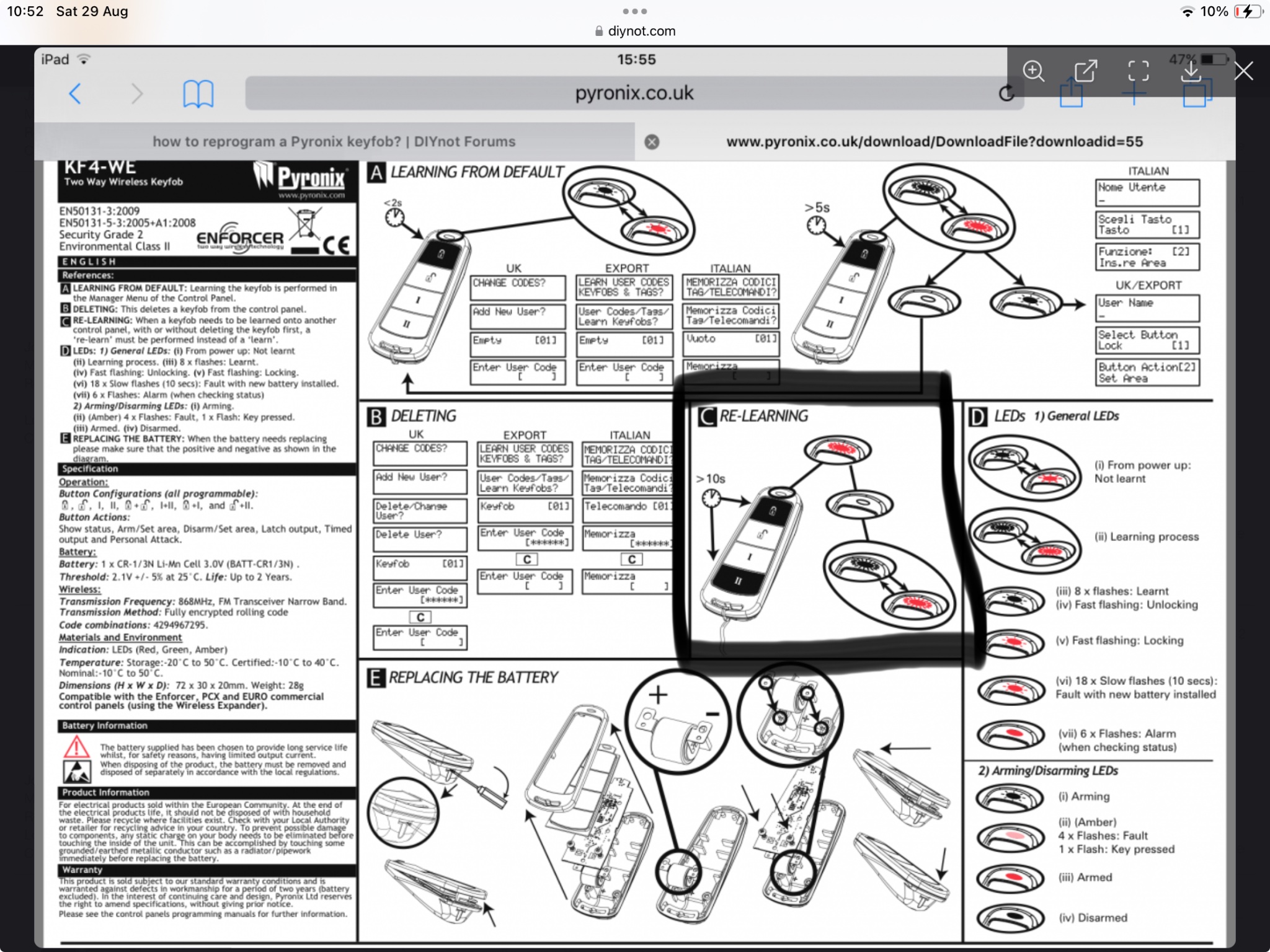

Thanks, very odd. Maybe some weird random button press in my pocket? How would one default a fob if you even wanted to?
Off top of my head hold middle two buttons down together until the led changes colour then let go …or is it top and bottom …
Ok,I had posted it before see below …that’s how you default the fob ….now you need to relearn it back on panel
