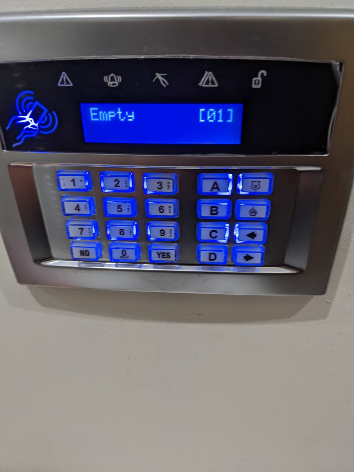

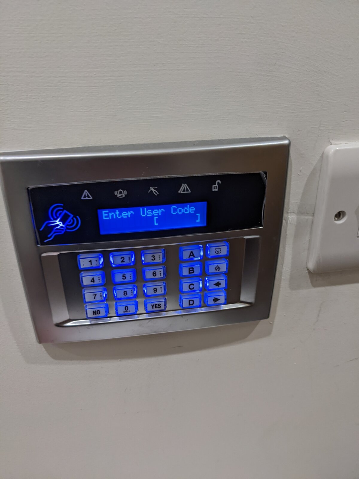

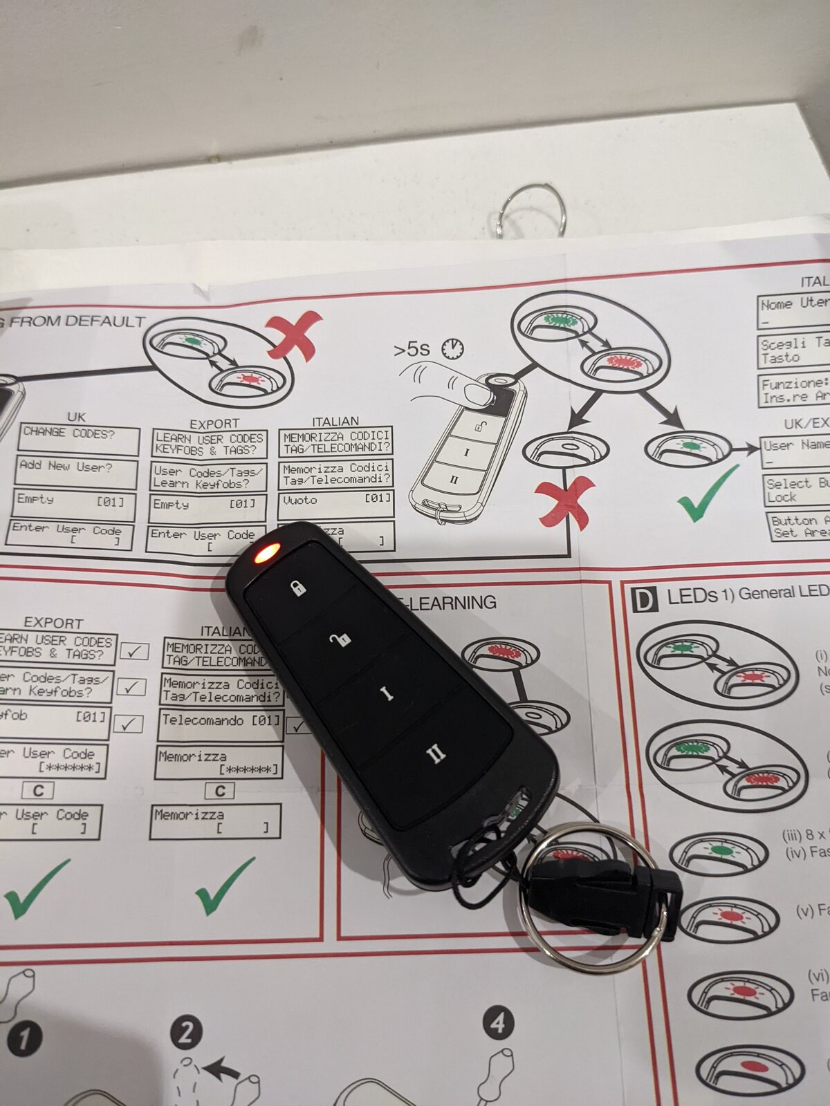

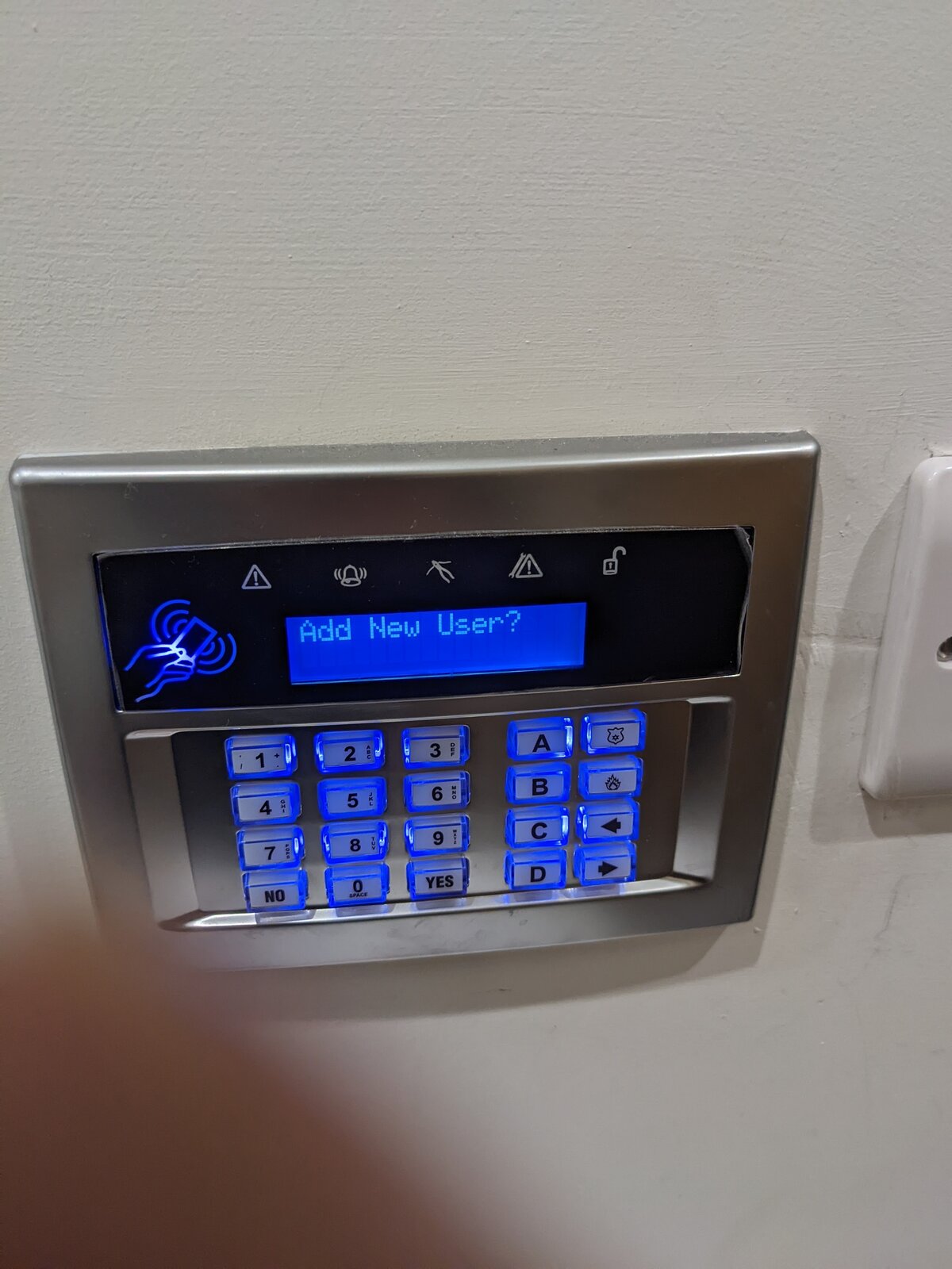

Hi I have a Pyronix euro 46 V10 hybrid panel and having difficulty programming a keyfob.(new)
Going through master menu getting to edit user-- add new user--. Empty 01
And then getting enter user code, at this point I'm pressing the lock button on the key fob as the instructions for greater then 5 secs but it's not adding on the system.
Any advice thanks

Ah thanks gave it a go and didn't work.
Just realized the whole panel and sensors are wired nothing wireless to it so might not have the 32 we connected? Could this be the problem?
Thanks for pointing this out, makes sense will have to use the pyronix app for now, seems like it has got a bit more quicker and stable over the past few weeks.
