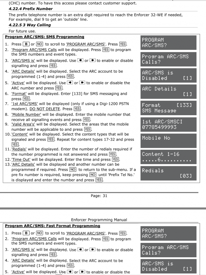

Hi, Hoping someone will be able to help. I have tried Pyronix but they refuse to help.
I have installed a Pyronix intruder alarm with a GSM module all is working well apart from the SMS messaging. Thinking the GSM module was at fault I sent it back to the company who supplied it. To their credit they replaced it without quibble. I have now fitted the new board but to no avail, still no sms message.
The setup is as follows.
Programme Arc/SMS (response yes)
Programme Arc/SMS calls (response yes)
Arc/SMS is enabled (response yes)
Arc details 1 (response yes)
Active yes (response yes)
Format 133 SMS message (response yes)
Mobile number ( entered using 0044 ) ( response yes)
Valid areas A ( response yes )
Content 1 – 16 (6, response yes)
Content 7 – 32 ( nothing entered ) (response yes)
Redials 3 (response yes )
Timeout seconds 55 ( response yes )
I'm sure this must be a setup problem if anyone can help I would be eternally grateful.

Remove the 0044 and put normal number in 07804 etc
Now try ensure the programming is as above.
If you are still having a problem. You need to see what the leds are doing on the GSM modem they flash when dialling number .look on GSM modem instructions they how what each led means.

Changed number as handymanjo suggested but still did not work. I added content 13 which sends an sms message when engineering menu is entered and exited, just to save the bother of triggering an alarm every time I wanted to generate an alarm.
To my surprise it worked every time, in fact other content settings work apart from content 6.
I now have the system set to ring out on content 5 and all is well.
Why content 6 doesn't work is still a mystery.
