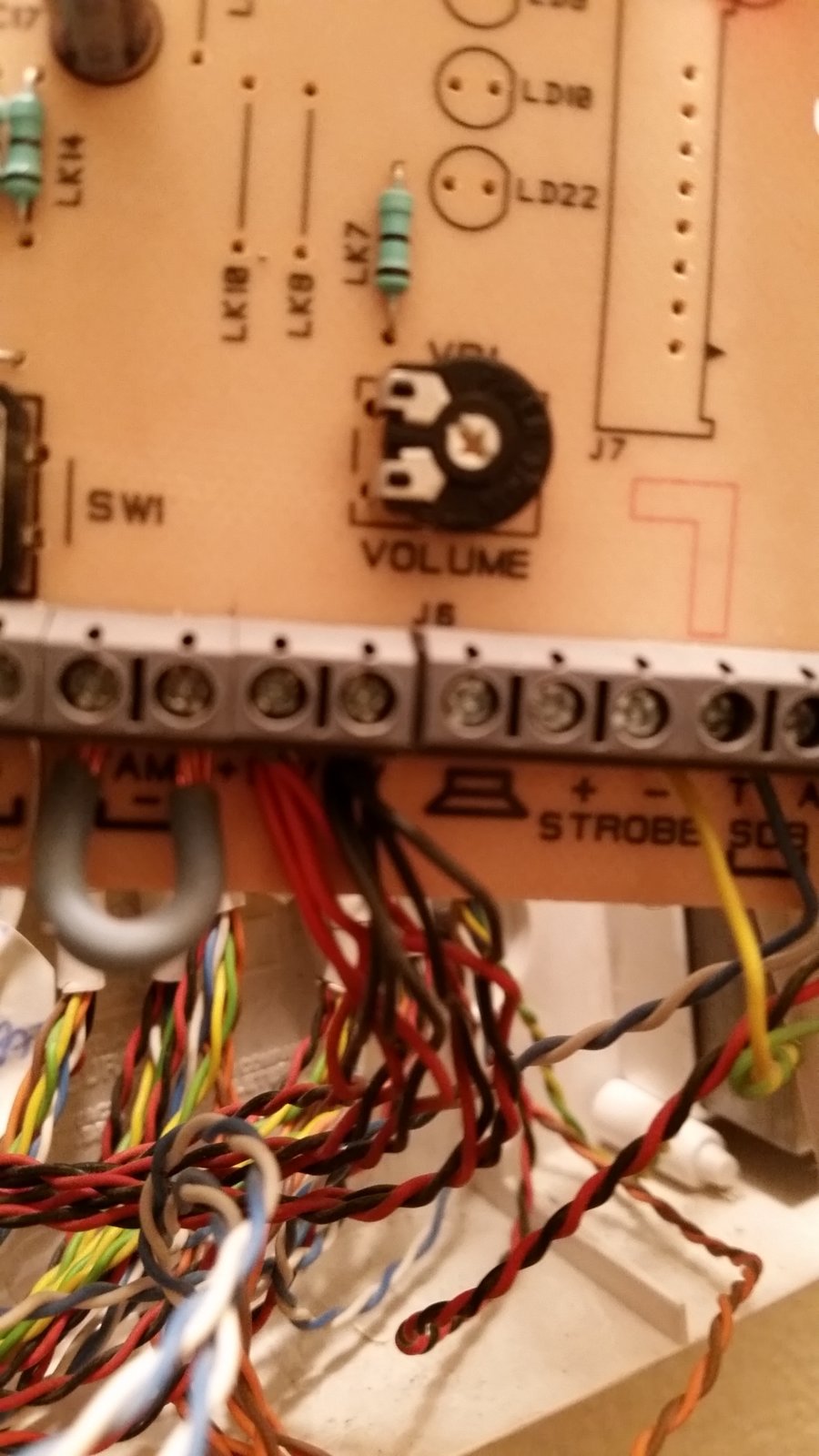

Hi All,
I have almost completed a Pyronix Enforcer alarm install and all that remains is the external Bell which has got me stumped.
I do have an existing wired bell outside the house from an old alarm that is no longer connected and would like to reuse it.
The old bell cable was wired to the old control panel in the following way and I also attach a photo.
red and black wires in +ve and -ve terminals
blue and white wires under SCB section wired into points marked T and A on old control panel
Yellow wire on -ve terminal under STROBE connection.
The old control panel also had a very thick wire across the -ve and +ve connections under a TAMP heading (see attachment).
Can someone tell me how I connect these old Bell cables to the new Enforcer control panel? I would be grateful if you could also include how the resistors need to be done as this is especially confusing. I am hoping that the wired Bell itself does not need any changes as I don't have a tall ladder at the moment.

The big QUESTION is what is the bellbox ? As the enforcer has only 250ma for the bell box ! Ok with a deltabell as it low current or a bell running in low current or scb mode ...looks like the ladders may be needed !

The SCB terminals on ADE panels is misleading ...it's actually SAB So forget that , you can power the newer wireless delta bell ( to prolong the battery life ) but all the other signals are wireless so you could make use of the existing wire for this .
Was there not a wire in the bell output on the old panel?
Having another look at the pic I think there will be wires going into the bell output D+ and B- the red and black wires. Well thats if its a accenta alarm which i think it is.
On the the Enforcer input output board wire in. red-12v black-bell yellow-stb white-com that should work. If you want the bell to have tamper wire the green wire on to the end of the resistor and the other end of the resistor into z33 . You will then need to program zone 33 as tamper and name it bell tamper.
