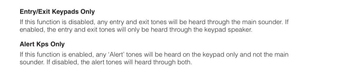

Hi sorry if this has already been asked but does anyone know how to turn the volume down for the entry / exit timer? Or to have it just beep through the keypad and not the speaker? When I’m setting it at night it is silent but when the count down is over the speaker located at the top of the landing makes an almighty chime it has started to wake kids up and if we go down stairs at night we are literally running to the key pad to get it turned off it’s very annoying and the installer basically said it’s at its lowest volume it can’t be changed.

Or you could have the entry/exit tones via the keypad only. The exit tone whilst full setting may not be loud enough though.
