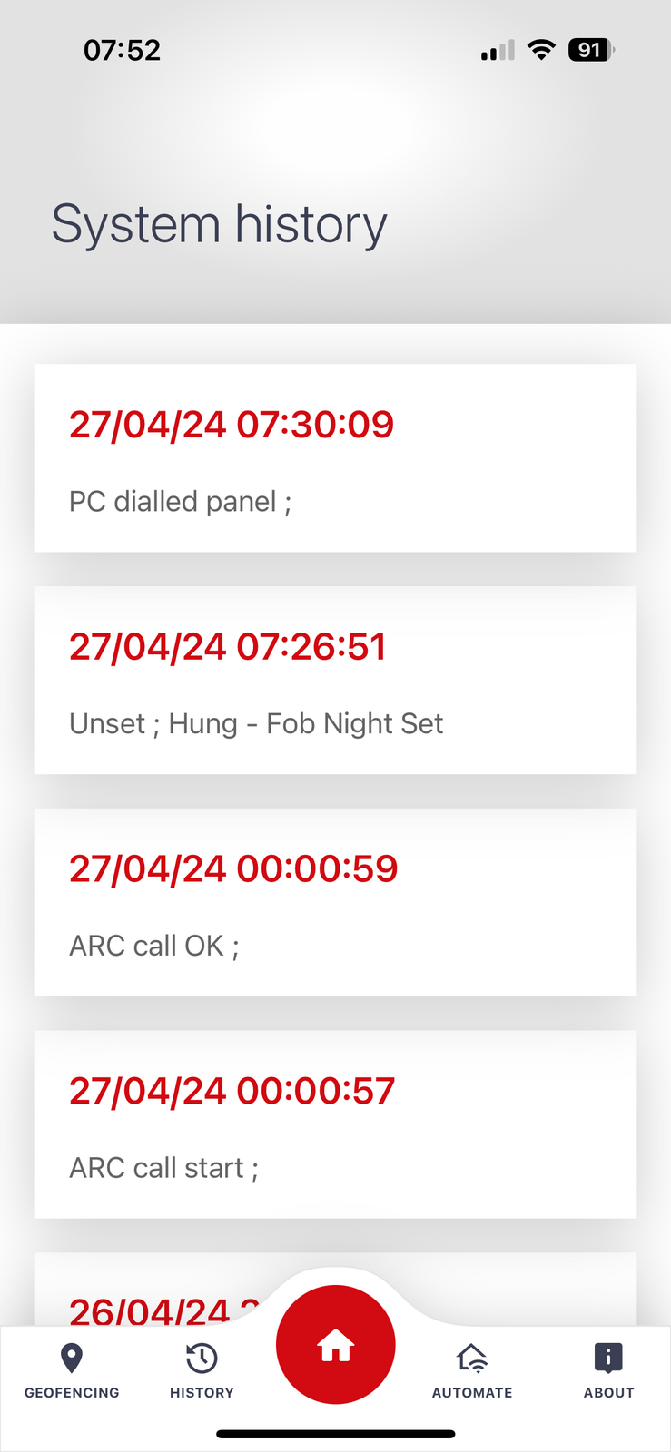

Hi,
Recently got Homecontrol setup with our Arc monitored alarm.
Can someone advise on what the following mean (assume it’s verifying connectivity to the Arc from our communicator) and should I expect to see this immediately after I arm the alarm?
Arc call start;
Arc call OK;
Notice it doesn’t appear show this after arming, and in a recent case it didn’t show until an hour after arming etc?
Is this something of concern?

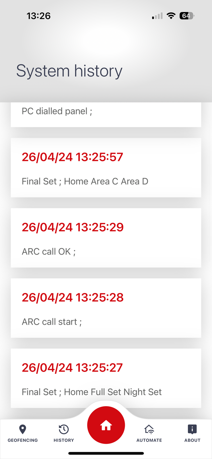

In the first photo, I've armed the system and immediately it appears to have called the arc and confirmed
i.e.
26/04/24 13:25:27 - Armed system
26/04/24 13:25:28 - ARC call start
26/04/24 13:25:29 - ARC call OK

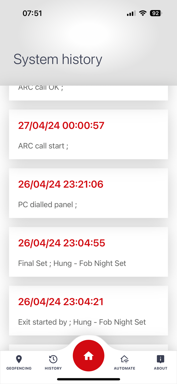

However, in the 2nd/3rd photo, I've armed the system but does not call the arc immediately?
Its only called it just after midnight and received confirmation shortly afterwards.
i.e.
26/04/24 23:04:55 - Armed system
27/04/24 00:00:57 - ARC call start
27/04/24 00:00:59 - ARC call OK
Having checked the past few nights. It appears to perform the ARC call start and OK just after midnight.
My question - Is that the normal behaviour? i.e. to perform an ARC call and confirmation at a set time (around midnight).
Or should i expect it to perform this ARC connectivity check shortly after arming the system each time?

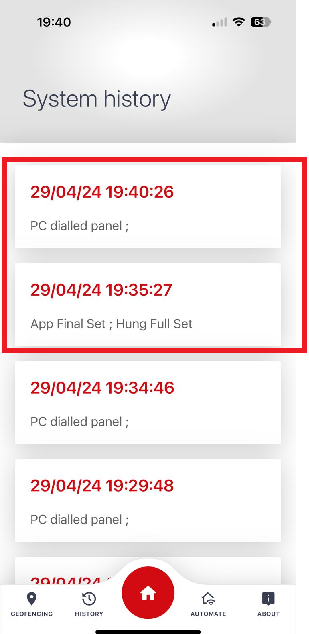

Ok, tried doing a full set (via remote app).
First instance I used a normal user and waited 5mins after arming then checked the logs and no arc checks.
Second instance, I used the manager user and waited 2mins after arming and samething...no arc checks.

When the system is armed, it will send a close signal to the arc. When disarmed will send an open. At default, the output will be programmed as final set all, which means it will only send the close signal if all areas are armed. Your system will never send an open/close signal in this case as it is not setup so that you can arm all areas simultaneously. In the first screenshot you posted it shows armed full set and night set, followed by a call to the arc, which will have been the close(armed) signal. Was this when the installer was present ?
Yes correct, first screenshot (below) i took when the installer was present, and we armed the system. This appeared to do both Full set and Night set.
However, it did not make sense to arm both full set and night set at the sametime i.e. full set is the same as night set with the exclusion of to 2 pirs upstairs.

It is not an arc check.
Arc call start means a call to the arc has been initiated
Arc call ok means the call has been completed and the message has been conveyed to the arc - I.e system set/unset. If the alarm is activated and intruder signal will be conveyed to the arc in the same way.
It looks like the system has been programmed as such that it will send a daily test call around midnight every day. This is to verify that the transmission path is working. It is not really required to do this as the arc will register a poll failnif communication is lost.
Your installer should be able to resolve the issues easily with a couple of programming changes.
