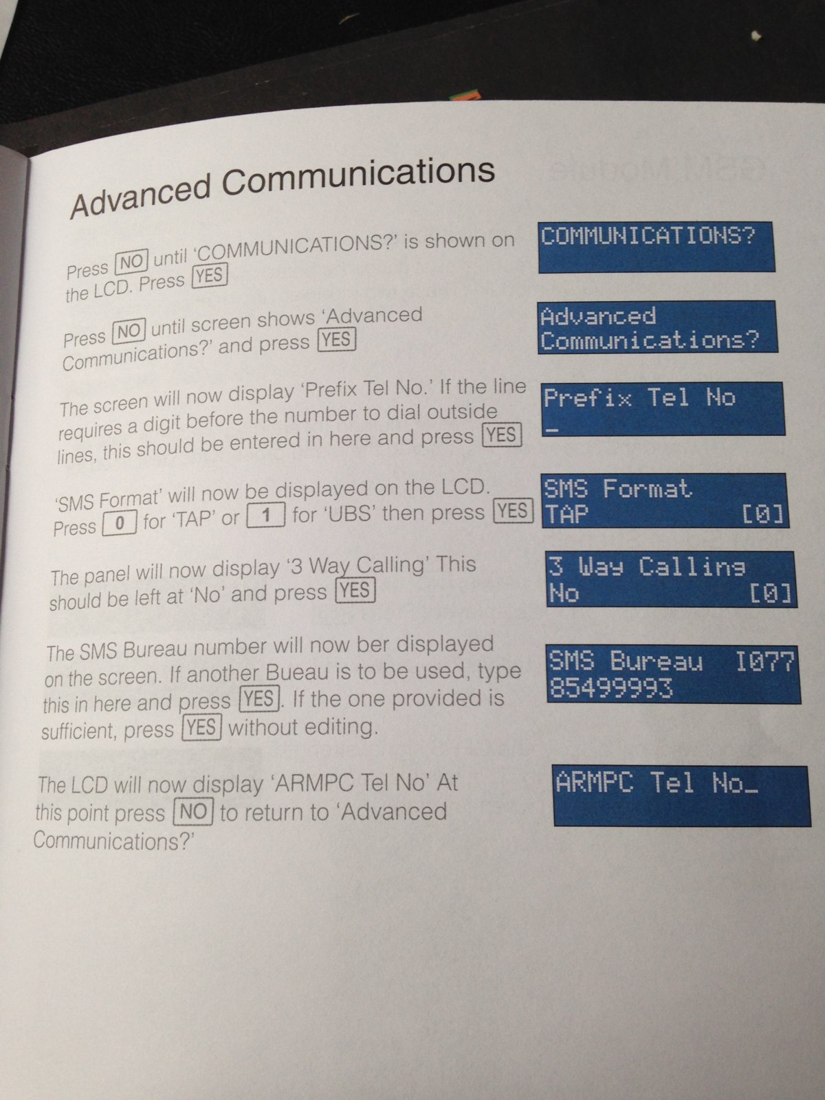

After carrying out a routine service today, I can confirm after speaking to pyronix tech the tap server numbers are no longer valid which they have known for "a couple of weeks"
Does that mean the only way around this issue is to upgrade my alarm panel, or are there alternative tap numbers which can be programmed into my existing unit?
IMG_3718.JPG Change sms bureau number to open tap BUT it may still be calling the castle host computer which may be bringing the no arc issue
I'm not sure that I have access to that menu as I am just a home user and don't know what changing the "bureau number to open tap" means. I have changed the recipient mobile number to one on the Virgin network but still get the ARC Call Fail fault.
