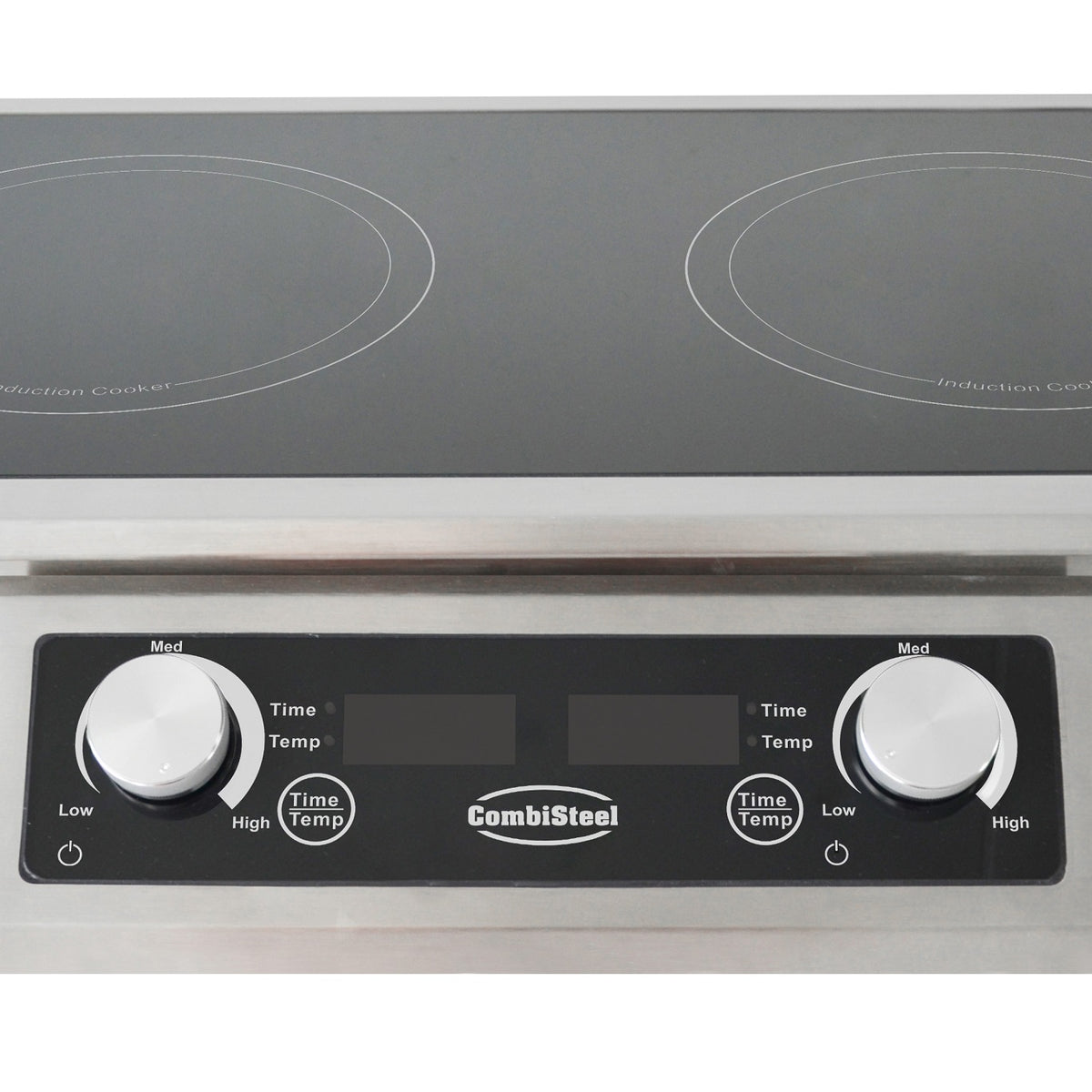

I'm quite interested in this
I can see why, for commercial kitchens, it makes sense to offer 3-phase kit, even if a 7kW appliance doesn't need to be 3-phase, but I'm wondering if, under the hood, it really does have 400V innards, or if it's really two separate 3.5kW appliances, using off-the-shelf 230V units, each connected to a different phase?
And would therefore work fine in my kitchen.
I've asked the maker, and if they say it is a genuine 3-phase item, or won't tell me, there's nothing I can do, but I'm curious to know if people think I'm likely to be right.

"Electrical power (kW) 2x 3,5" is not three phase. Both the adverts you link to say the same, they are not 3 phase, neither are they split phase (wrong voltage) maybe not designed for the UK or Europe?
Two and three are not the same.
I took that to be an indication to buyers of the "cooking power" of each "burner".

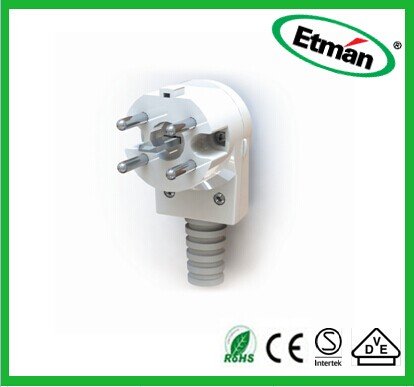

I think you are making unjustified assumptions. Here is a Swedish cooker plug. 3 phases, neutral plus earth.

Commercial three phase UK use these 1726566573034.pngin the main, for single and three phase these 1726566643601.pngso having a twin hob running on 400 volt would use either, but if 230 volt one area and 230 volt other area then it would need the neutral, and neither are using three phases, so the worry would be is the split phase 400 volt or 460 volt between lines.
