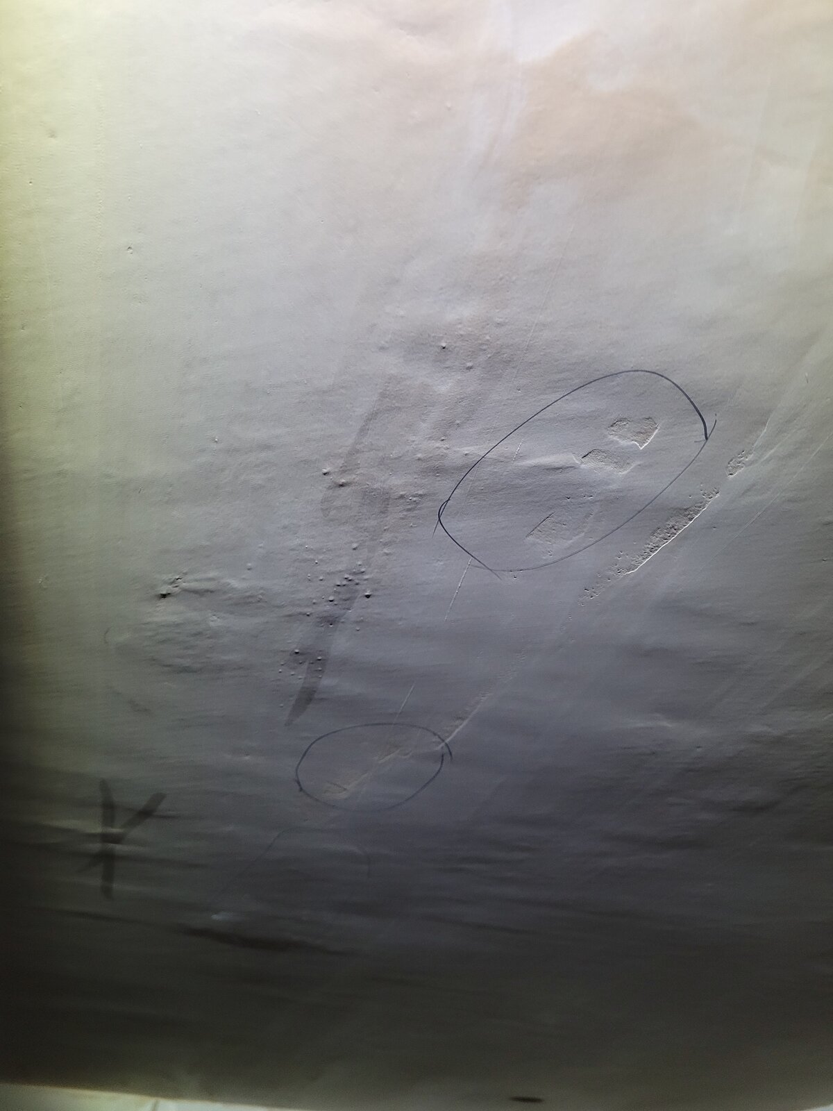

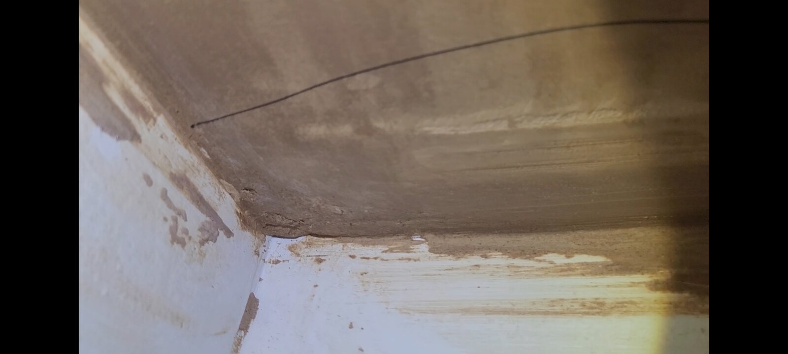

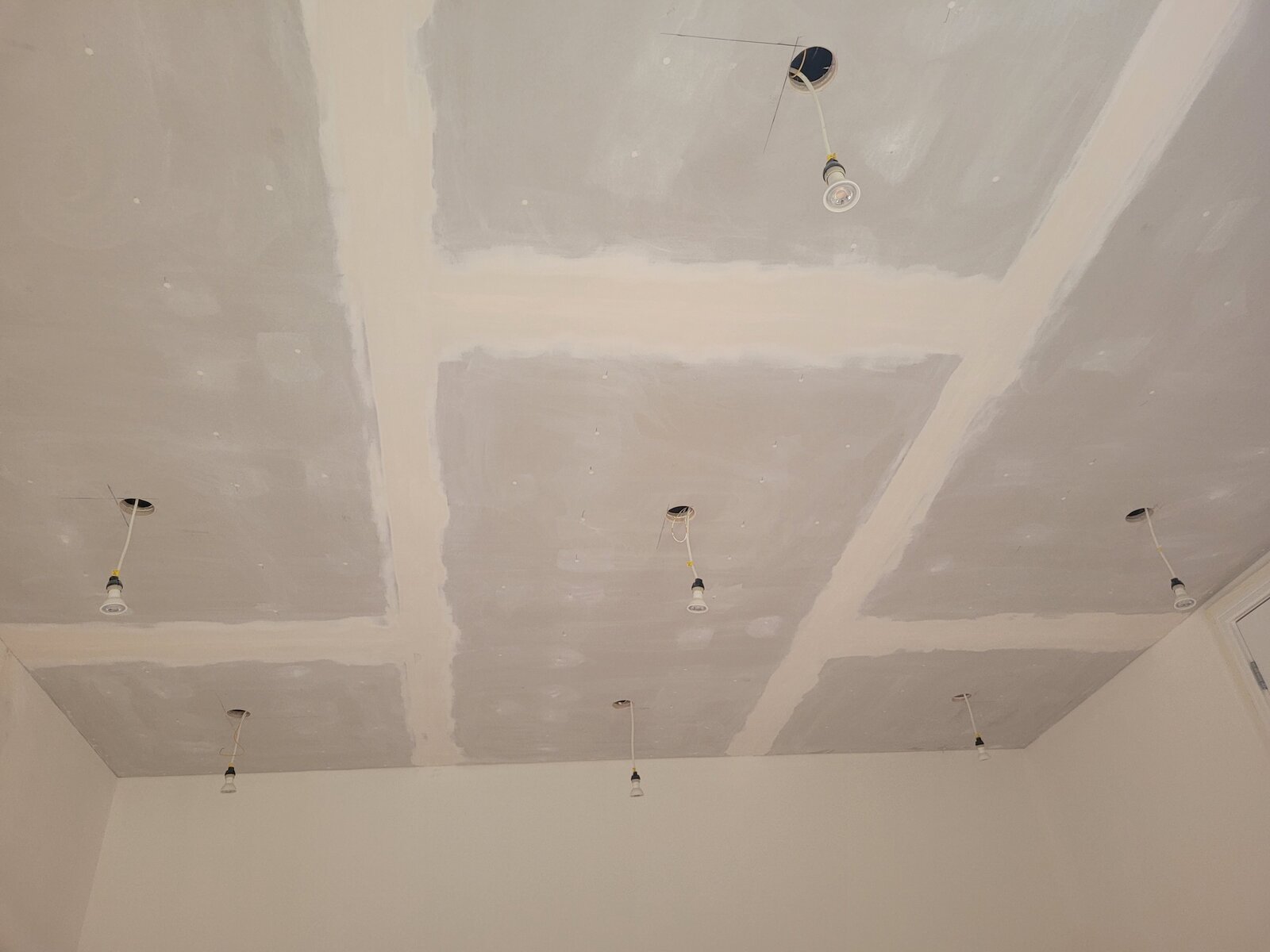

Hello,
Earlier this week I had a new plasterboard ceiling plastered, it was on a low ceiling. That I had already prepped, taped and jointed, sanded and cleaned down. I had laid down a dust sheet and made everything as easy as I possibly could for the tradesmen, hoping it would result in a better quality job.
The tradesmen arrived on time and was friendly, however he seemed a bit rushed and quite messy.
For the next couple of hours I let him get on with plastering the ceiling as I know someone watching over your shoulder all the time can be offputting.
He let me know once he was done and I pointed out a couple of imperfections to him, that he said was just a bit of dried plaster, I was like ok no worries I can sand that out.

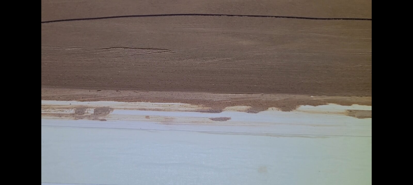

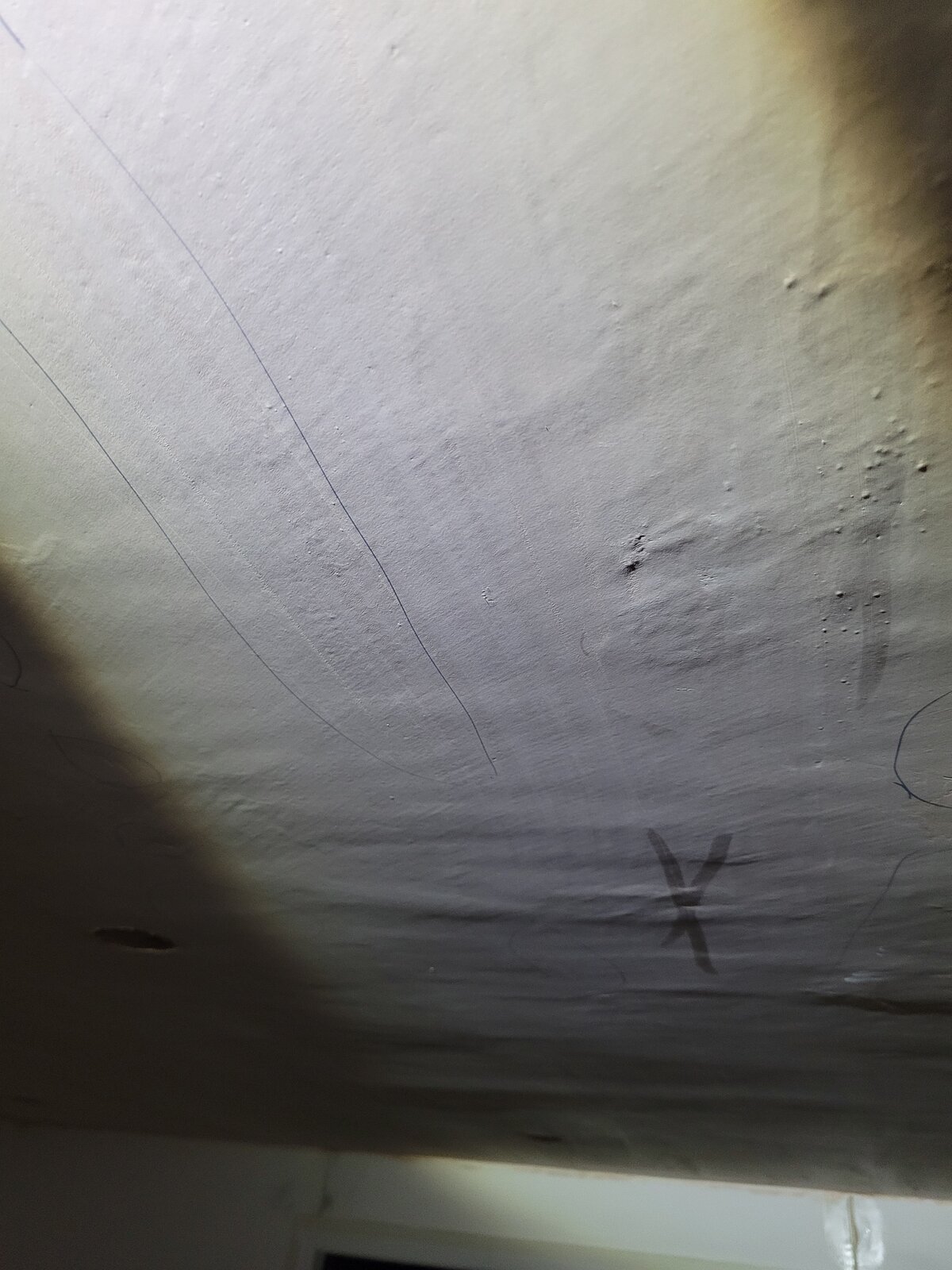

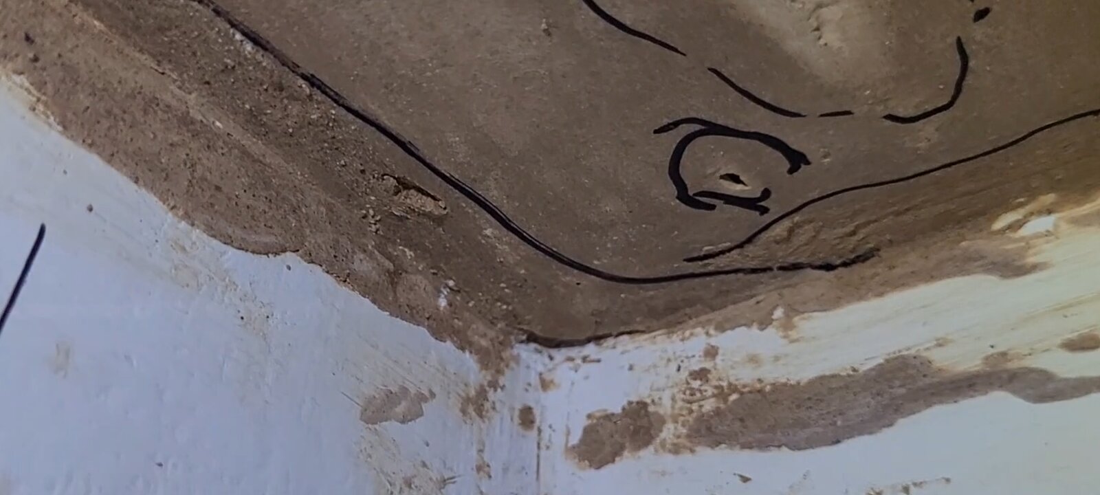

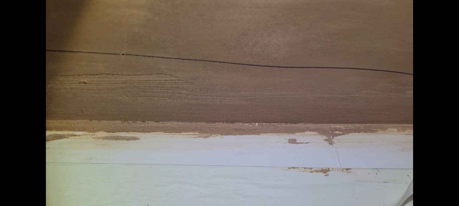

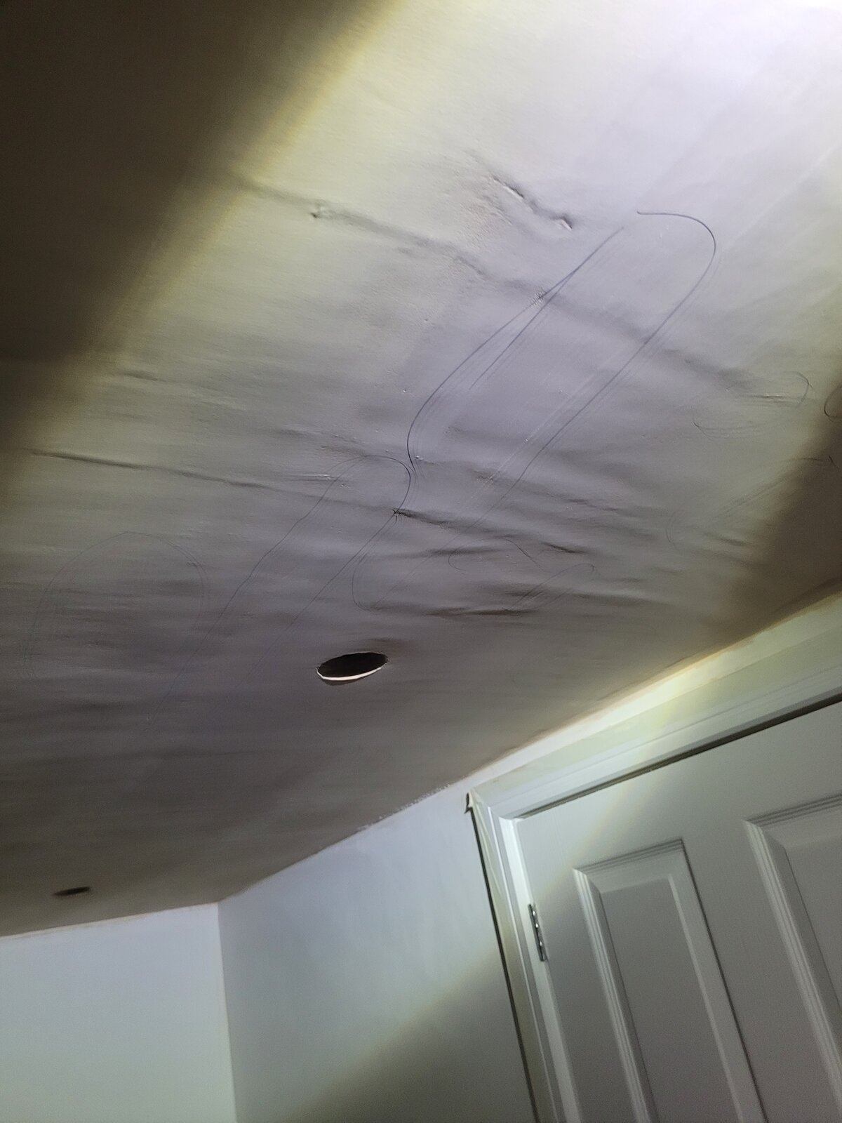

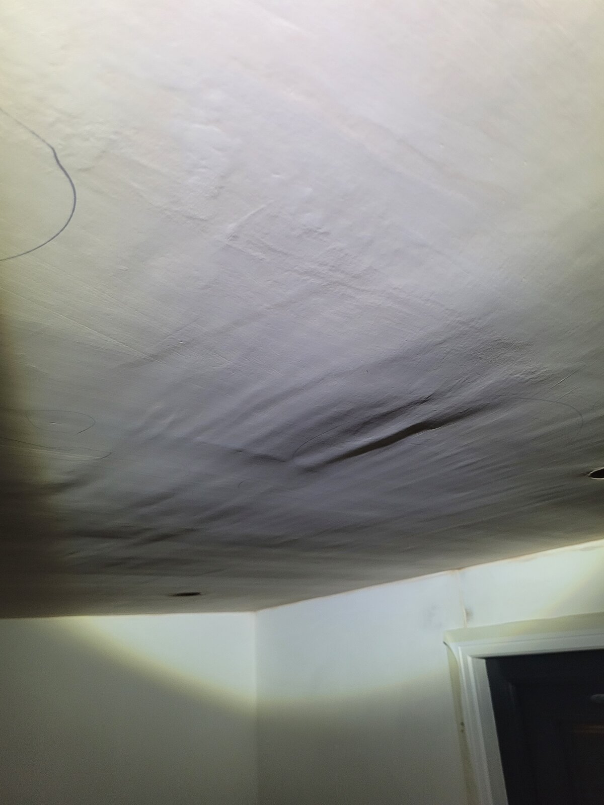

Later that evening I thought I would have a propper good look at the ceiling and I now think it looks really crap. I have circled near enough 100 imperfections and today after it has dried out a bit, I noticed the whole ceiling is really bumpy.
I used a torch to look for imperfections as on a sunny day they really show since the ceiling is quite low, which was something I made clear to him.
I have sent him a video of the ceiling pointing out the problems but have not received any reply yet. This was 3 days ago. So before I take it further I thought I would see if I can get some second opinions.
Please see some attached pictures of before he arrived vs after.
Any appropriate feedback is appreciated. Thanks

Wow, that's shockingly bad. Where did you find the plasterer? If he hasn't replied after 3 days I'd assume he won't at all.
Truly a terrible job.

Yeah as things currently stand, it seems like that could be the case. Think in the future I might do that, as right now I am left with an absolute shambles of a ceiling and have just created a tonne of work for myself to rectify as not sure if he will. Might just rip it out, replace plasterboard and tidily tape and join. That would at least be a 100x better than this.
Get a proper plasterer in and ask whether it is possible to make good with a reskim, can't see why not as thats whats happens on walls. Important thing is getting a proper plasterer to do the work
Thanks for your reply, that would be the easier option although more costly. The only thing is they would probably need a bonding coat since the ceiling is that bumpy and wavy, and as the ceiling is already quite low, I really dont want to lose anymore head height. Although I guess that is something I could discuss with the plasterer

Thanks for your reply. Yeah it doesn't take much to beat the state of this ceiling! Similarly to you I would have given plastering a go if I new it was going to look like this. I tried sanding his work down but it is proving really hard to do as its gone pretty hard, even with an electric wall sander. As someone previously said on this thread, a lot of the positive reviews on his account might have been from his friends. I got a response from him today and he is trying to put it down to the plasterboard itself, which is almost embarressing, since it was brand new and in perfect condition... anything but accepting liability. Like you say definitely puts a big question mark around sites like that, think the best thing to do is get a recommendation from someone in real life who you know
