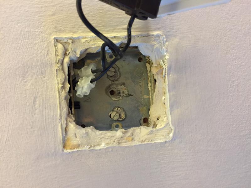

Having taken a look in the switch box now, can confirm that there is a snipped pair of black cables in the box (very similar to what is in the spare light fitting), so im assuming that once upon a time the light fitting may have had 2 switches, one for each fitting.
I have also tried disconnecting the cables in the spare fitting, to see how it affects the other light - having tried both the cables individually, and then both, nothing affects the other fittings power or switching so it seems it must be linked individually, and as suggested above what I though was a channel must be some form of paint effect on the ceiling.
So im guessing that its a case of trying to put in a new switch plate and reconnect the original cables in the spare rose - problem now is that the cables that are cut are cut back so short with no slack.
Possibly. But before you go too far, I suggest you do a continuity test to see if the wires are still connected and havent been snipped anywhere else!
If they are too short, you may be able to chop out a bit of the ceiling that will be covered by the new light fitting, and make a joint at that point, > join and shrink sleeve a crimped joint. Sounds like fun?

(imagine this photo rotated 90 degrees clockwise - but you get the idea with the snipped cables)
Yep makes sense - will need to check the existing cables, although testing is going to be a bit of a chore with the cables being as short as they are, the rose end isn't so bad but switch end has all of 2-3mm to spare and the box is well and truly embedded, with no access behind it.
will have to put a voltage across the cables and stick a meter across them at the switch end to see if they still connected.
thanks for the replys so far - any ideas on how to extend that cable would be appreciated (providing its connected still).
