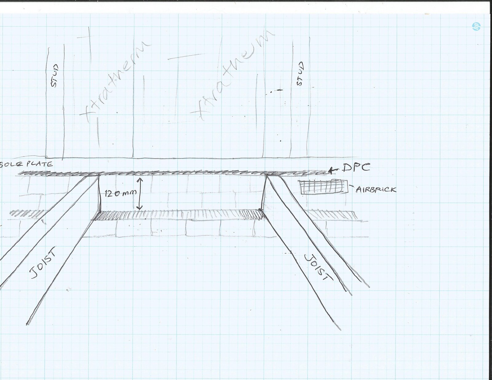

Hi, I'm insulating my old workshop (timber frame, walls sit on brick & concrete block walls), and am currently about to start insulating the suspended floor. Have taken out the old chipboard flooring to expose the joists. The plan is to cut 90mm Xtratherm insulation boards to fit between the joists. Then cover the lot with a vapour barrier. Then put down ply flooring.
The ends of the joists sit on a "shelf" on short wall of bricks (and they sit on loose laid strips of a damp proof type material). There is a DPC on the top of the bricks and under the sole plate (ie. level with the top pf the joists). Diagram attached.
If I put insulation boards between the joists, the tops of the boards will be level with the DPC. The insulation boards will therefore be effectively sitting below the DPC. My question is - does this matter?
If the insulation boards must sit above the DPC, then my floor will end up being raised by 90mm (plus flooring). Which will be a right pain.
(And yes there are air bricks but have already established ways round that. It's the DPC that I'm now worrying about!)
Thanks.

I have this issue, I just cut out the insulation around the air brick so there is plenty of room for air to flow through - I little bit of floor without insulation is not going to make a huge difference.
Yes, I'm OK with the airbrick issue. It was the fact that the insulation might effectively be bridging the DPC that worries me. ie. If the insulation is butted up to the wall below the DPC, possibly against the edge of the DPC in places, then it would technically be bridging the DPC, but could moisture actually travel from the (possibly) damp area below the DPC, up through the insulation? Does stuff like Xtratherm conduct moisture? Probably not I guess.... Just need some clarification (hopefully a "Yes it'll all be FINE, stop overthinking") before I commit!

But is butting the Xtratherm up to just under the DPC going to cause a problem?
It won’t cause a problem.
I insulated my floor with rockwool ( I know different to you) but after that, I covered the whole floor with building paper before putting the floorboards down.
Result - draft free.
Thanks Mr Chibs! Did you have the same issue as me, with the DPC being below the top of the joists?
Yes, the risk of bridging is small. It will be a big improvement over an uninsulated floor.
