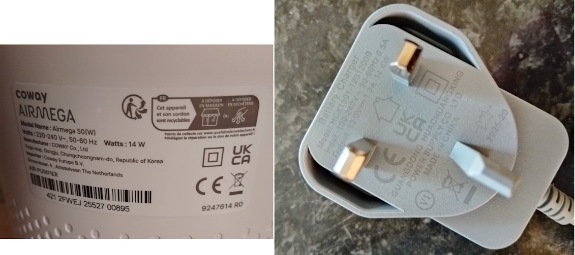

Hi all, zero electrical knowledge so please go easy on the tech talk ;)
I am going round in circles online, now hoping for some solid advice. I purchased a Coway Airmega 50 air purifier recently to help with air quality and allergies. Worked a treat until I discovered plug getting hot when on maximum power for 30 mins+ and warm when on power setting 2.
Reported it and was sent a replacement. Having same issue. Everything online says hot plugs are a no-no. Customer service has been good and I have zero animosity towards them. I've been running tests to see what the different power settings do to the plug. No other devices in my home get hot plugs and I have tested both purifiers in 3 rooms over 4 sockets, I always get a hot plug on max power. PC and dehumidifier are on for 8hrs regularly and don't get hot plugs (not even warm) so I am assuming it's an issue with the air purifier.

My question:
I'm wondering how hot is too hot, (I have no way to measure the temperature) no smoking or signs of damage anywhere but I would class the plug as definitely warm on lower setting, and hot on full power. Not scalding, but definitely hot after 30 mins to an hour of operating.
Is Google right? Should a device with these specs never even get a warm plug? Do Coway need to do further investigations/potential recall if I have had 2 units now with the same issue? Photo of plug and device info attached. It has been on for 2 hours now at max, unplugging it the back of the plug case is still hot, the metal pins are not hot. I just noticed that the plug says battery charger on it - is that okay?

if you look at the back of the plug it states clearly that its not a standard plug but a transformer - input 240v output 12v. Perfectly normal for a transformer to shed heat when working.
Even my laptop and phone charger get noticably warm.. But not too hot to touch, which is something to be concerned about.

Nonsense, it will generate some fraction of 14 W of heat, which is certainly noticeable.

Probably true.

Edit: maybe we can excuse the AI if it doesn't understand that the "plug" is actually the power supply, rather than a passive plug. At 14 W, a passive plug would not feel noticeably warm.
There are some abnormalities. Unit marked 220 - 240 volts, and 50 - 60 Hz 14 watts, but the plug says it is a battery charger, so a DC output of 12 volts 1.2 amps, 14.4 watt, my guess, and only a guess, is they are made for Europe, and to sell in the UK the supplier had to find an alternative power supply, and they have selected a battery charger which, although it has a nominal voltage of 12 volts, it will likely rise to 14.8 volts if designed for lead acid, and it expects the battery as it charges to use less and less power. So for its intended use charging a battery it is OK but for what it is being used for, it has not got enough cooling.
But it will run hot, the question is how hot? If you can hold it without hurting your hand with the heat, it is likely OK.

definitely not scorching hot, but a jump up from the warm of setting 2. At setting 3 I definitely say hot. When I touched it to unplug and move the device it was definitely hot enough to cause me some concern. I don't think it would be pleasant to hold for more than a minute at that temp.
Yes response from Google after asking for several clarifications but as you point out, can't be relied upon as accurate. Hence further research leading me here to some human expertise hopefully :-) If coway and respondents here think it's fine and safe and won't set my flat on fire if the unit is running for 8+ hours a day, then ok, I'll trust you all. It has just thrown me because no other appliances in my home get hot plugs in use after hours, so it absolutely felt concerning.
If it's only a 12v psu then how about getting a decent 12v psu.
I.e. not a little plug but a proper power supply that can deliver a lot more than that little thing.
It would cost more but should be safer to leave on.
Is that a foreign transformer with a clip on adapter to fit uk sockets
Your guess is as good as mine :-) It's a fused plug so not something I would want to replace, but someone else commented it looked like a transformer as it says battery charger on it and so IS likely to generate heat but is not dangerous... thoughts?
