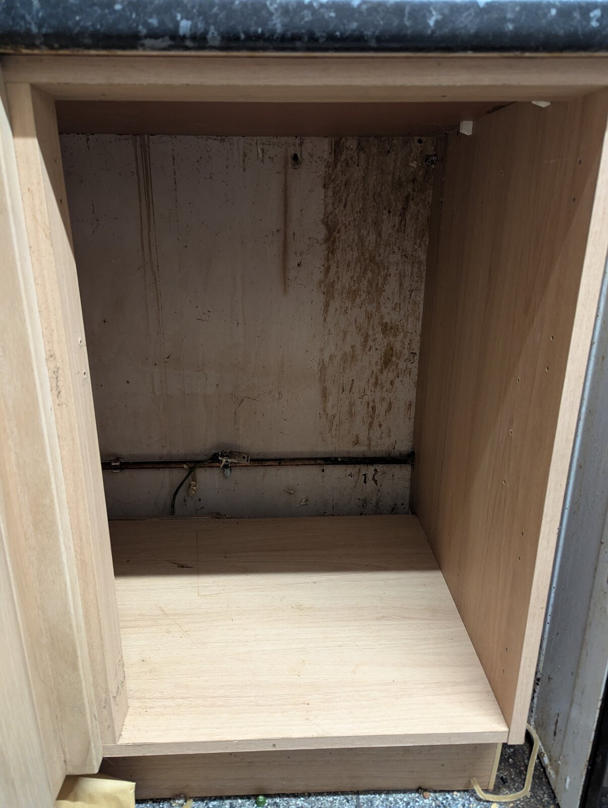

I have just started taking the kitchen cabinet apart to create the space for the dishwasher but there is a copper gas pipe that runs to the cooker with an earth connection.
Is it ok to still put the dishwasher here as long as I am careful?
There is a picture below. Thanks.

Just check the dishwasher you want to get for a service void/cut-out @ the same height - not all of them are the same
