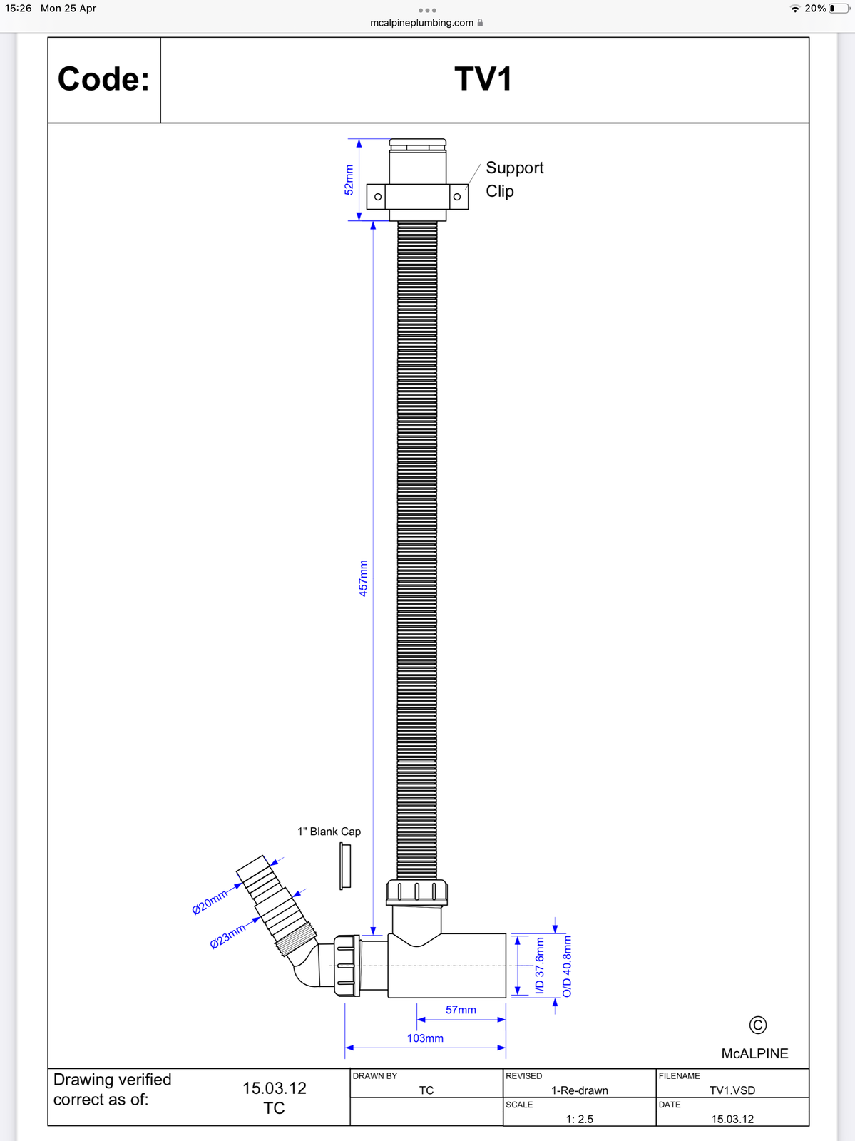

Thanks Madrab. That’s air admittance on the downstream side of the trap, right? Any thoughts on my concern about the upstream side? Googling finds lots of American references where they need to have an air gap upstream of the trap for regs compliance. I know we din’t need it for that reason, yet still we do nearly always have some sort of air gap e.g. a standpipe or a connection below a sink waste. If I just connect a dishwasher hose to the input of a trap like that one, are there any problems?

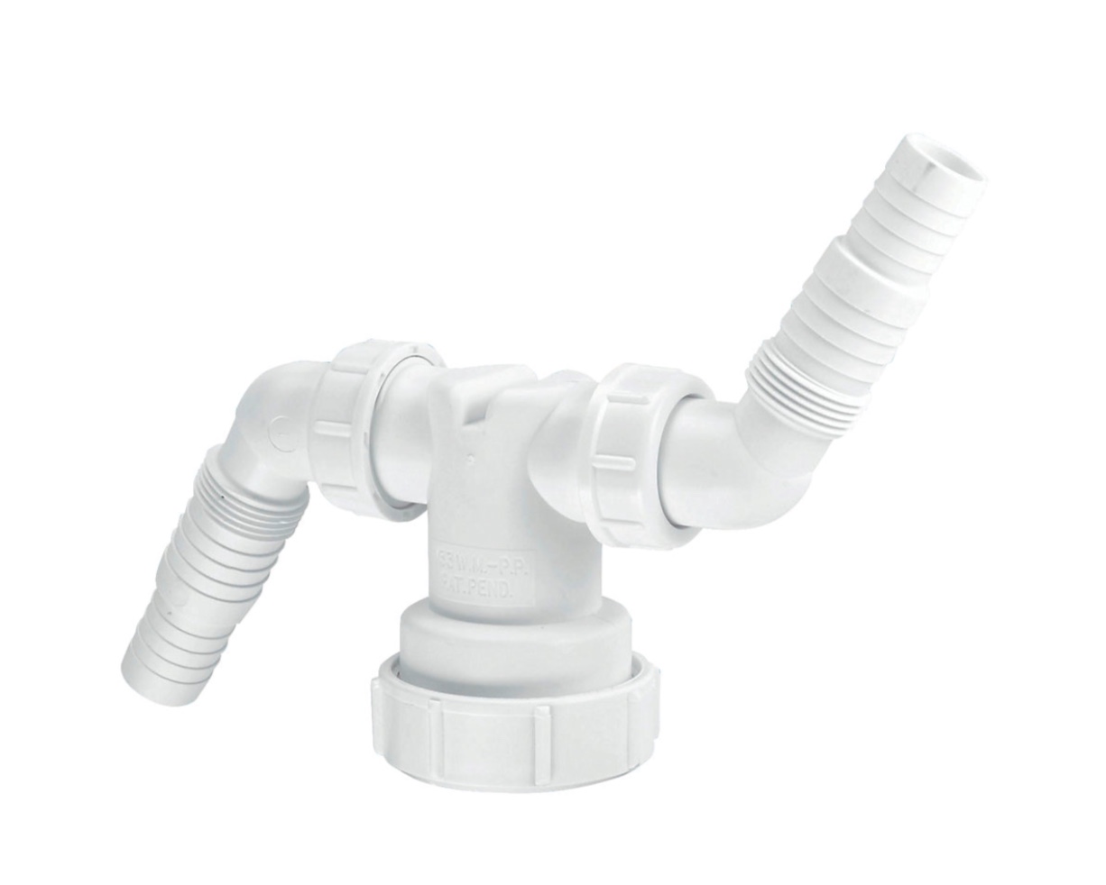

I’ve found this part:
https://www.screwfix.com/p/mcalpine-twin-hose-connector-40mm/206hr
McAlpine twin hose connector
For plumbing 2 domestic appliance discharge hoses into a standpipe trap
Incorporated Air Break
Is this the sort of thing that I need?
Hmm, actually that “twin hose connector” doesn’t seem to have any sort of valve in its air vent; it is literally just like sticking two hoses into one standpipe. But McAlpine do have this, which does have a valve. But it is rather long; can I cut that down to, well, almost nothing and still work?
The McAlpine twin spigot has an air hole in that slot in the top.

I would have thought the inline running trap would be sufficient. However, the mcAlpine double spigot or the trap Madrab suggested would be more than enough.
The sort of valve in the “TV1” i.e. a float so that air can go in or out but not water is, I think, the ideal solution. But i bet no-one ever uses them!
