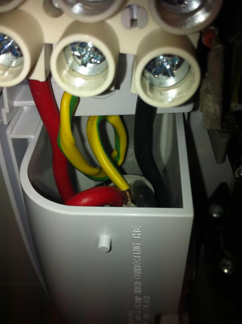

I've noticed that the shower is not on the RCD side - it could be a bodge install, looking at the way the cable has been run into it from the top....
Shower has a 50A MCB, which is not suitable for 6mm cable.

Assuming the cable is 6mm as suggested then you will need to lower the size of the MCB to 40Amps and put it on the RCD side of the CU.

10mm cable 50Amp MCB and put it on the RCD side of the CU.

6mm is solid copper strand and 10mm is several strands.
is that right?
The 6mm cable has a Solid Earth conductor, whilst the 10mm cable has a Stranded Earth Conductor.
Correct for modern cables - although was he talking about the cpc?
Unfortunately it looks like 6mm. Thats not good on a 50amp MCB! I wonder if it is 10mm from the consumer unit to the switch, and 6mm from the switch to the shower?
If the earth is solid, it is 6mm.
If it had been stranded it would more than likely be 10mm, but could be an older 6mm.
So I've checked and the cable is 6mm throughout
