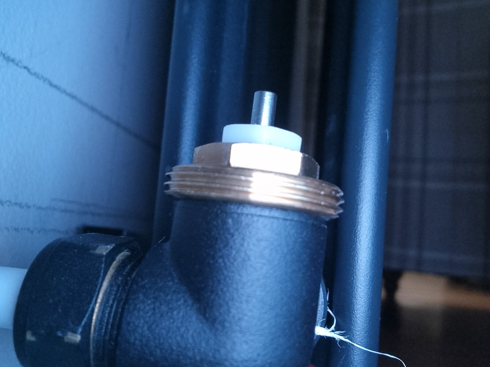

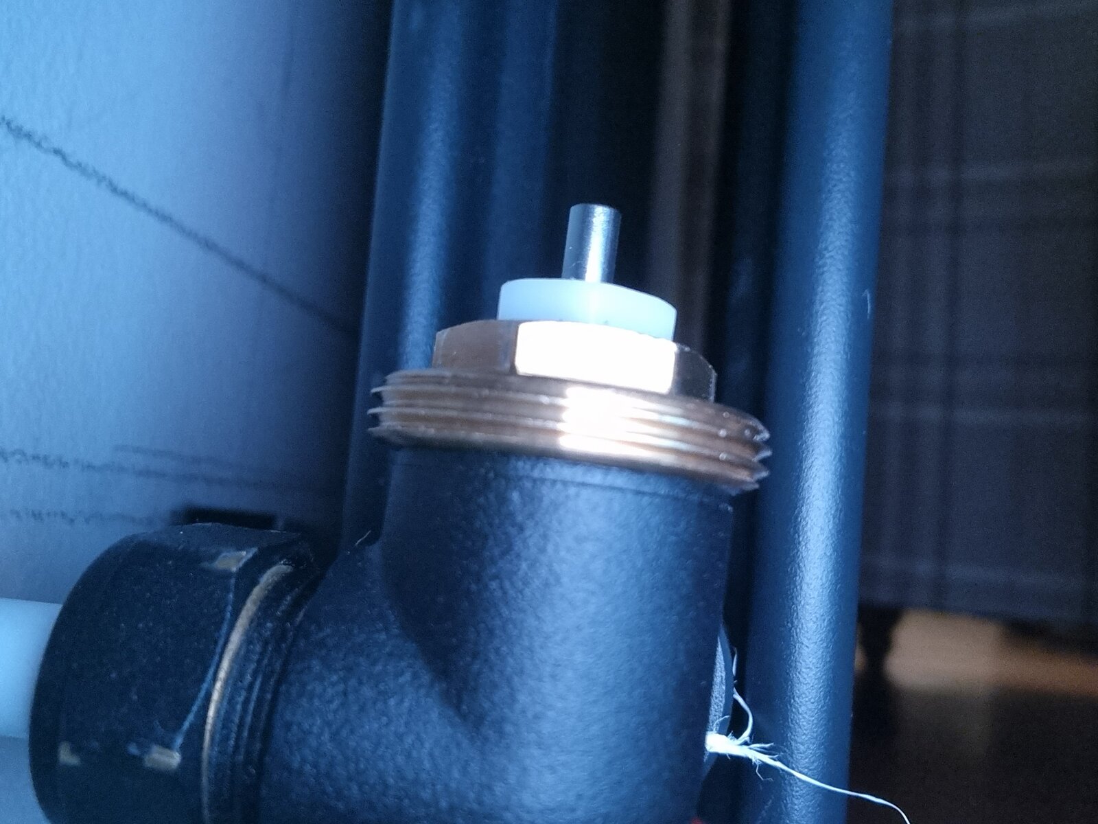

I did. My best guess is that it belonged under that shiny brass valve, if you might have undone that?
Thats what i undone yes, ive had a look and it possibly is, i just cant see any missing at all underneath so not sure how it would have filled the gap.
So if i turned that white valve clockwise would i be able to undo the brass nut to check the gasket and reseal it with some ptfe tape or will it **** water everywhere still given the white nut is attatched to the gold nut i think?

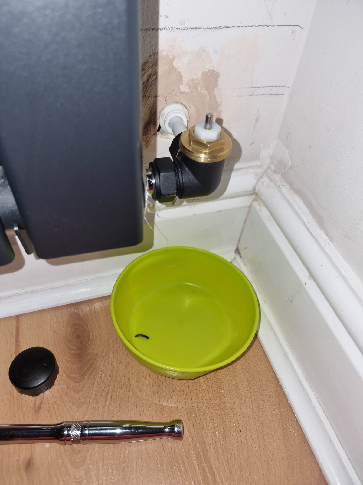

Release all the pressure, and you should then be able to remove the brass part and investigate where the rubber has come from, source a replacement form a plumbers merchant, fit it, repressurise, and then you can maybe stop worrying. PTFE is not a good solution to the problem, it would be a botch.
To release the pressure, just lay some old towels around, have a couple of bowls, plus possibly an assistant. Put a rag over the top to catch and direct the spray.
I see you have what looks like a ratchet there. Was it the brass bit that you undid using a socket?
Yeh stupidly thinking that was the lockshield!

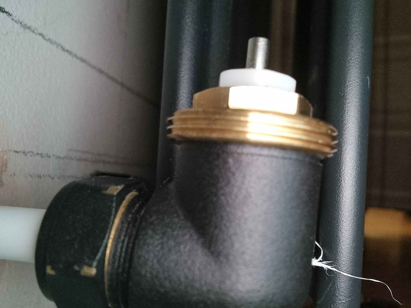

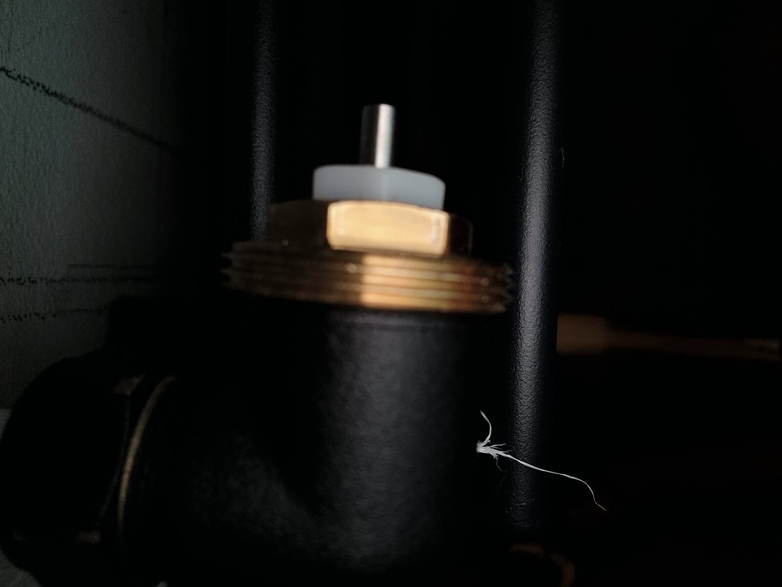

I think the tiny bit of rubber has come off from where the brass seals against the black plastic, as i have tightened it - it has squashed the remaining black rubber gasket to fill the gap and thats why its currently not leaking??
That sounds quite unlikely.
Thats the only place i imagine its come off from though, see this picture and it looks like there might be a black rubber gasket between the brass and the black plastic??

Well if it’s not leaking now and it’s under pressure, leave well alone!
