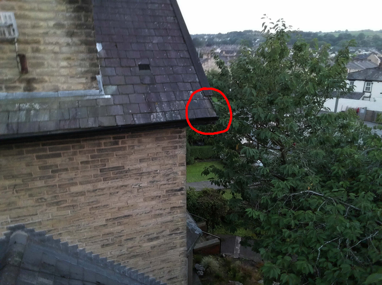

"There are some slates loose and missing on one corner of the front roof. Apparently it's because the fascia board has no capping on this side, so the wind has lifted them (all below). There's also a slate missing higher up and on the other side one missing from under the ridge tiles.":

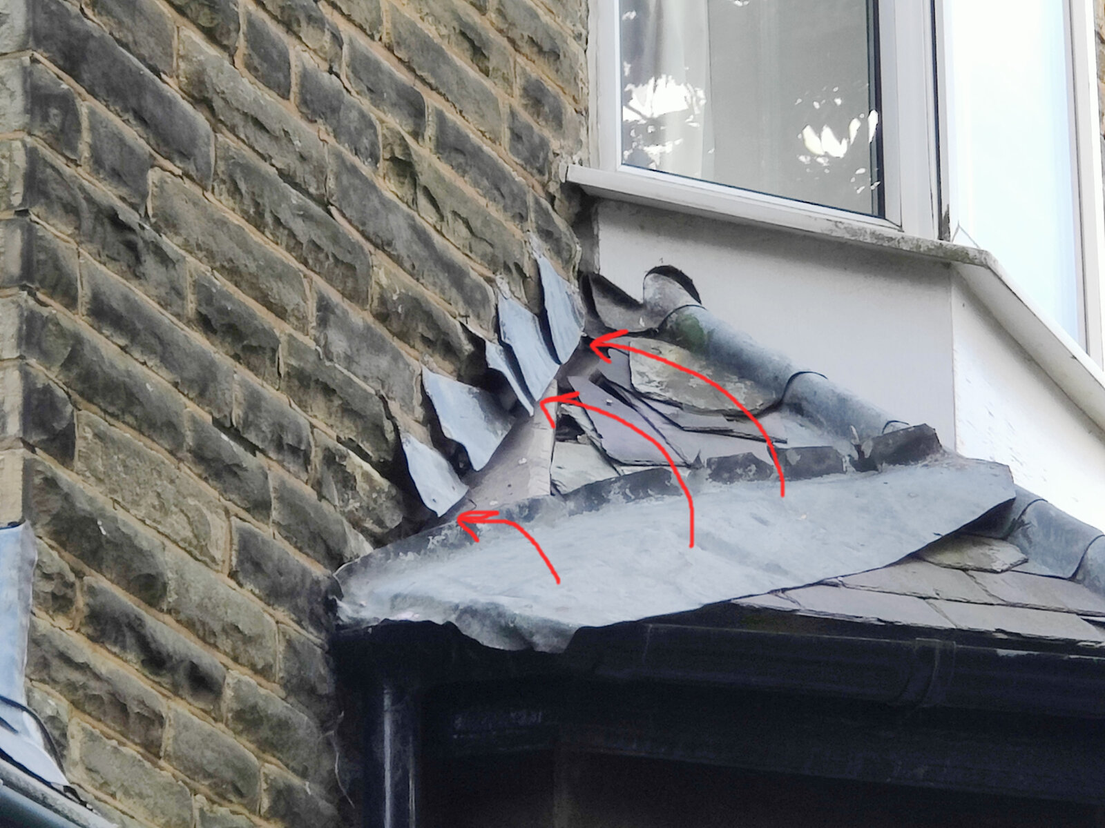

"The front bay window lead flashing (below) has pulled out on one side. The first floor bay window (above) has a very slow leak to the lead capping in very specific weather - driving rain or snow. Looks like it's been a problem for years." noticed on the above there's also a line of lead flashing above the bay. Would that suggest it could be coming from the cavity somehow?:

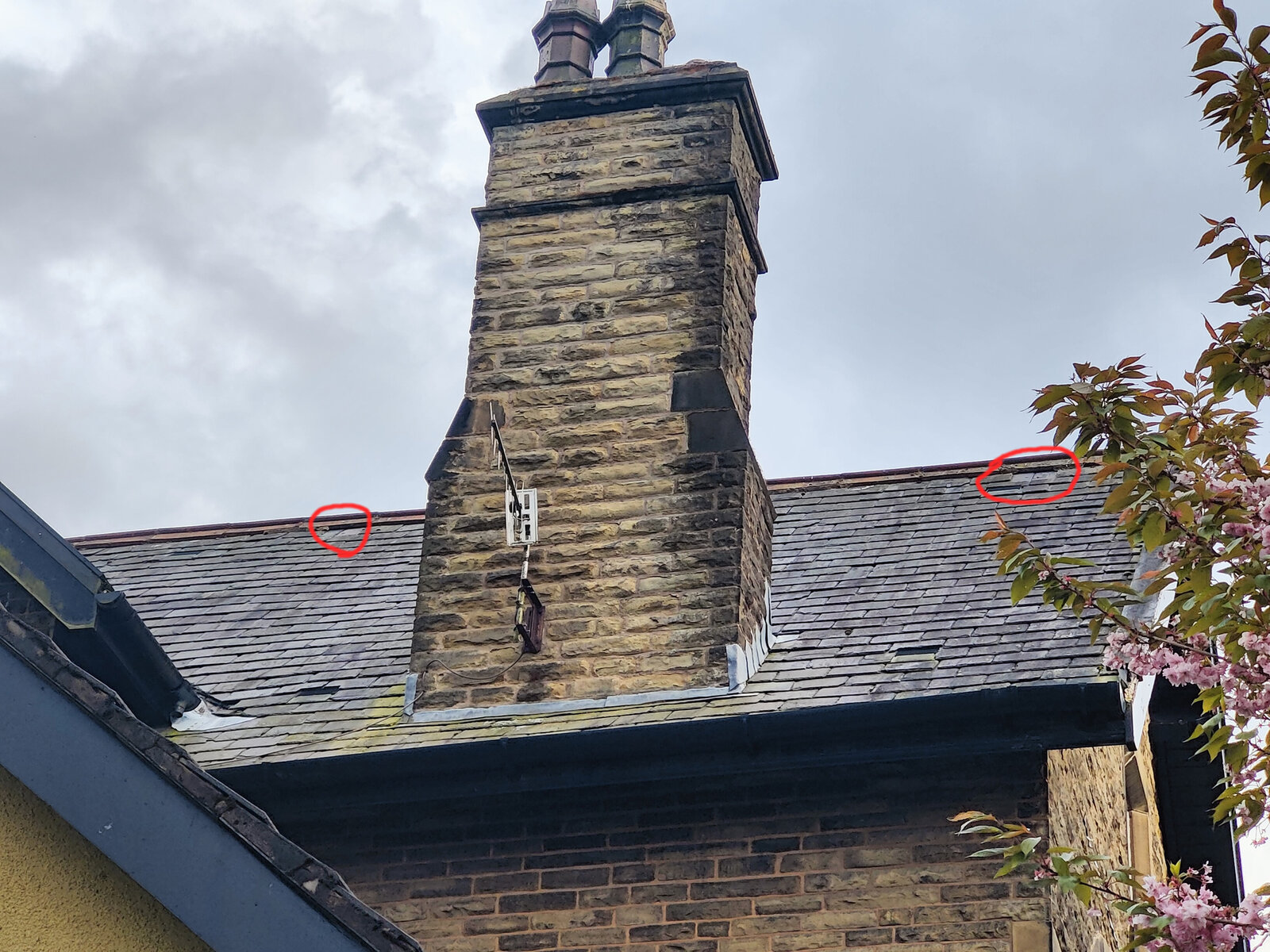

'The middle roof has a slate or two missing (below):'

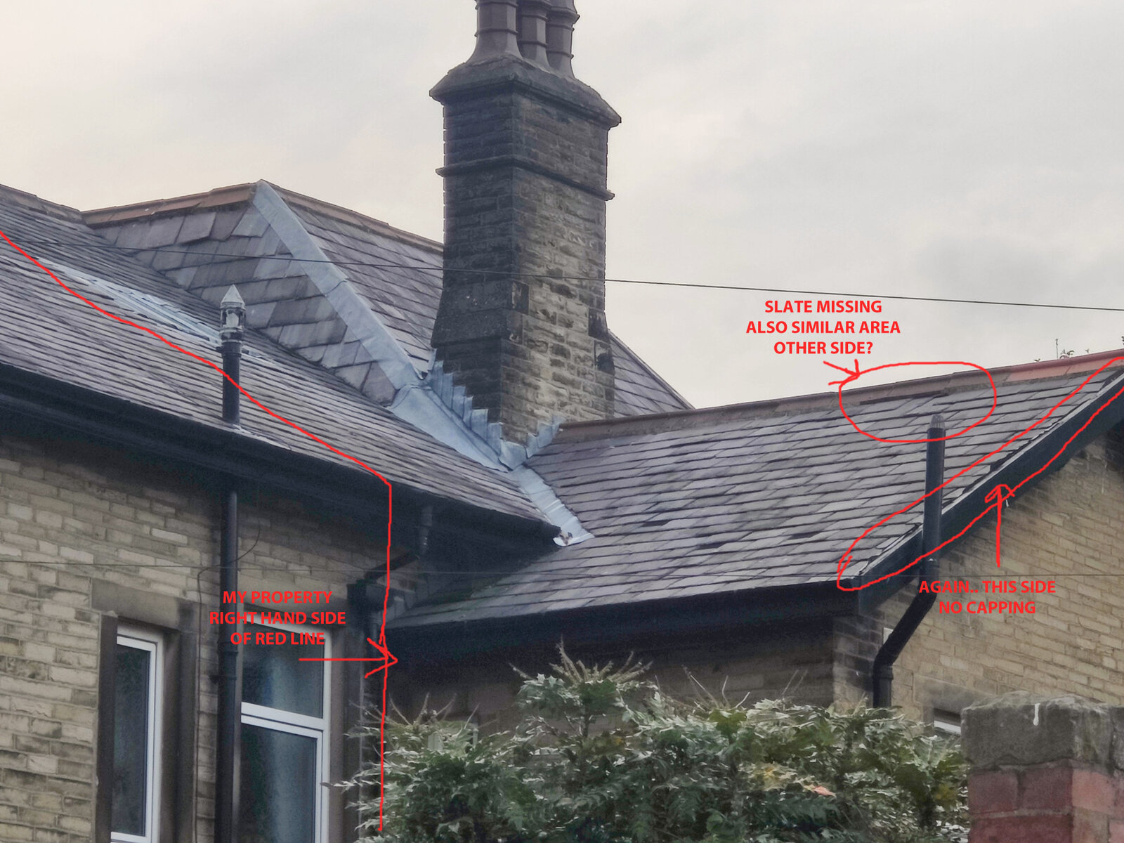

'The back roof has a slate missing from under the ridge tiles, two of which have no pointing around them - unsure if they are loose or not. The fascia board also has no capping on one side either.':

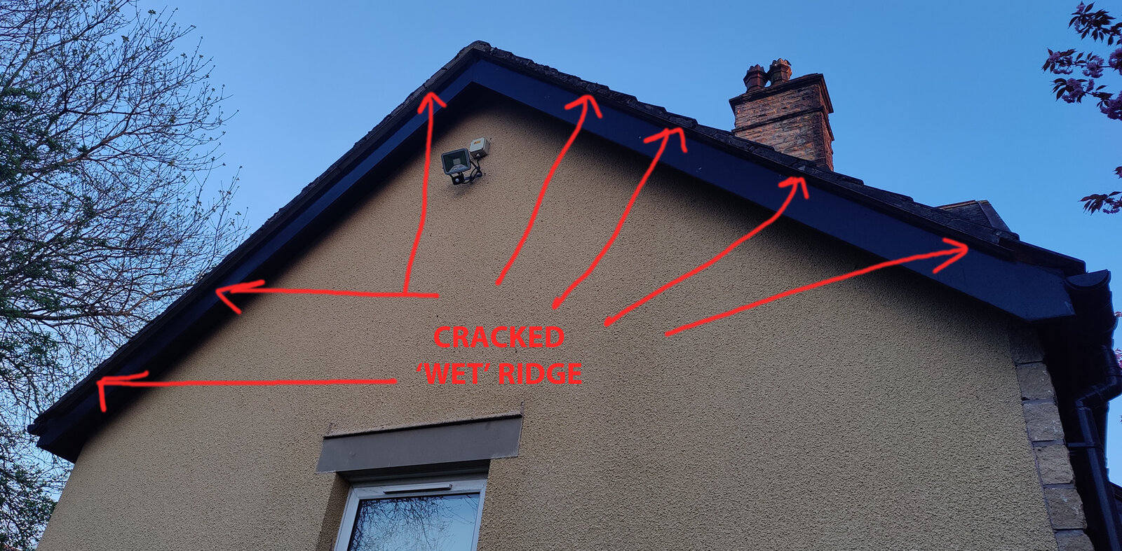

'The modern single storey extension has a 'wet ridge' to the gable end which is all cracked with gaps etc. and would be good to convert to a 'dry ridge' instead. The length of the 'wet ridge' is probably about 6m in total with a little bit extra at the front either side of a small porch area':
