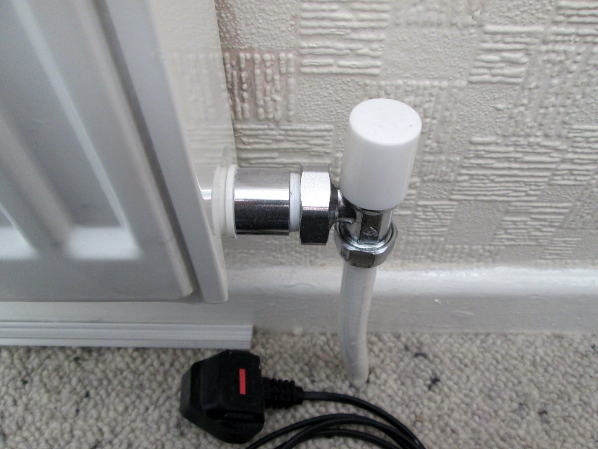

Did the job this weekend. Used plumbcenter center-rad radiators which are a rebranded Myson Rettig. Used Pegler valves. I gave the copper tails a blast with the blowtorch to get rid of the paint and slacken the old olives off. I cleaned the tails with wire wool and checked they were not dented or oval. (One I did a few years ago in the bathroom had such an overtightened joint that the pipe had a severe waist in it and I decided to solder a new piece in at floorboard level; no carpet at the time).
I fitted the new valves with a smear of boss white around the olives and nut thread. I fitted the extensions and tails with the loctite 55 which reminds me of thick dental floss. They screwed together smoothly with a consistent torque, no binding or squeaking.
Anyway, no leaks or weeps so far, thanks for the advice!
The first pic is one I did a few years ago ustairs with all-PTFE tape. Toolstation rad (Kudox) & valves. The pipe wasn't bent my me, it comes out of the floorboard like that. The housebuilder used underfloor bends rather than elbows and they do bind a bit on the floorboards.

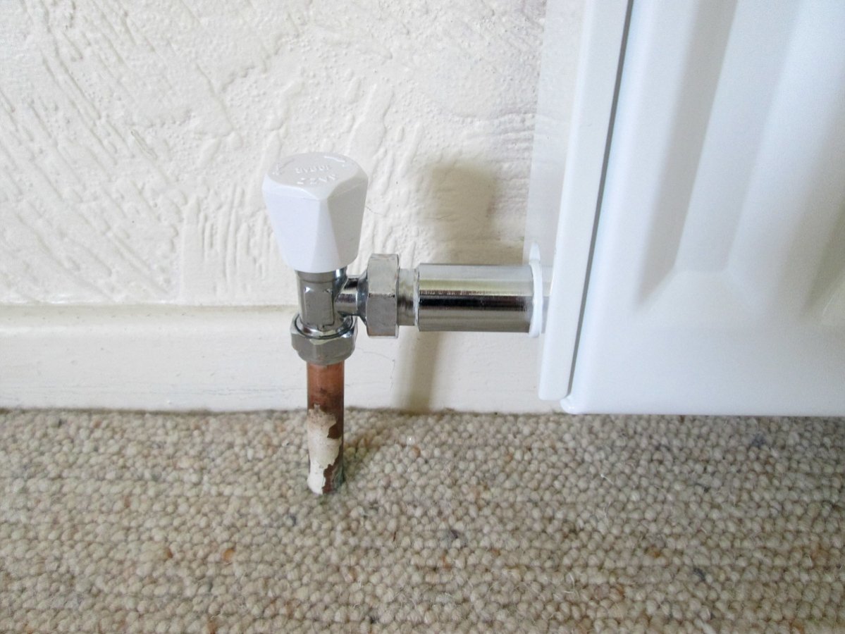

The last pic is the one in the lounge with the Loctite 55 floss. The pipe comes out of the floor at a slight angle, plumber in a rush I guess.
I've used these extenders before and see no issues in them. If it isn't practical to run a new straight feed I feel these look better than a couple of elbows on the supply pipe up out the floor.
