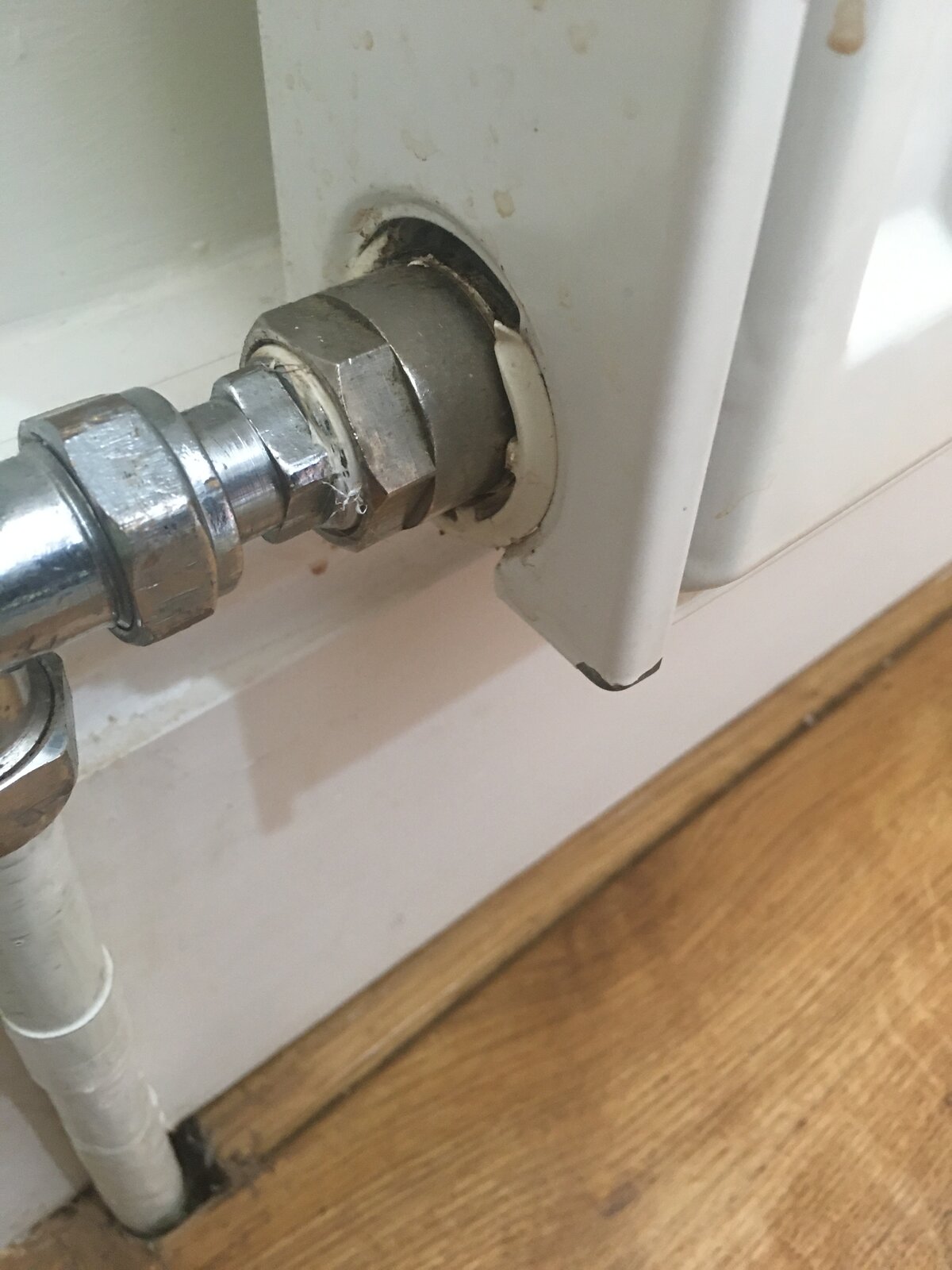

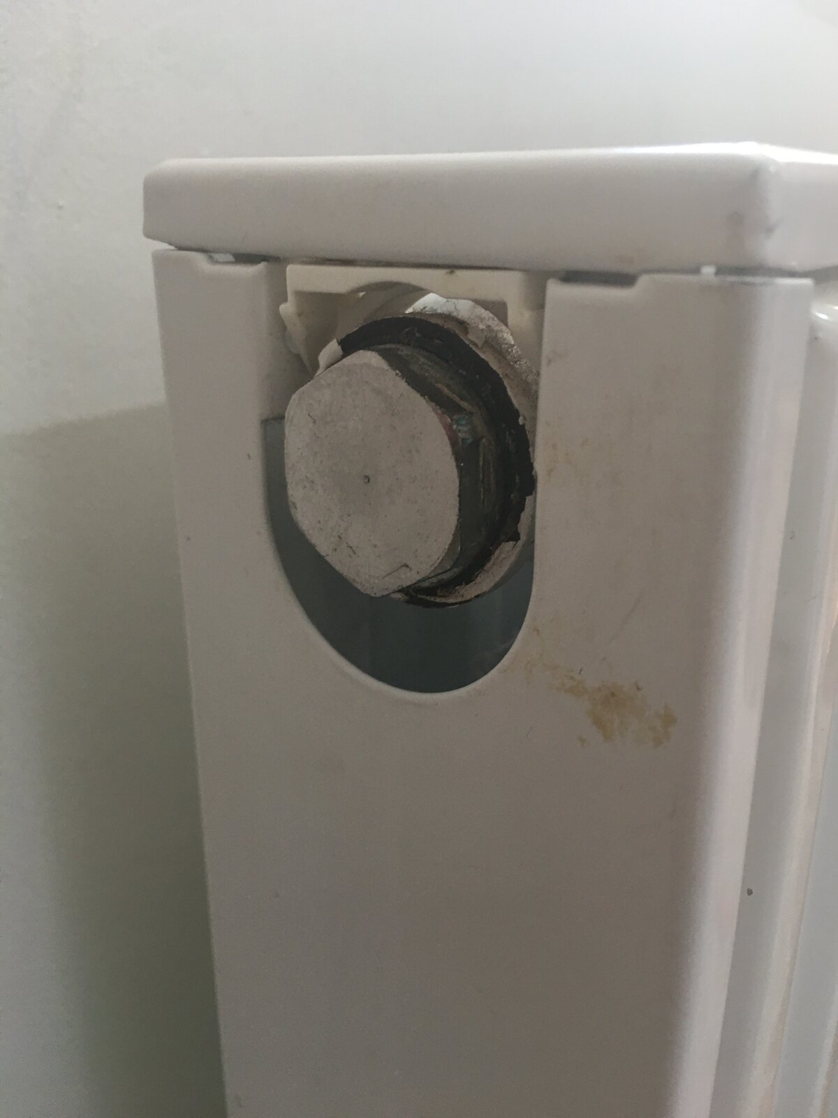

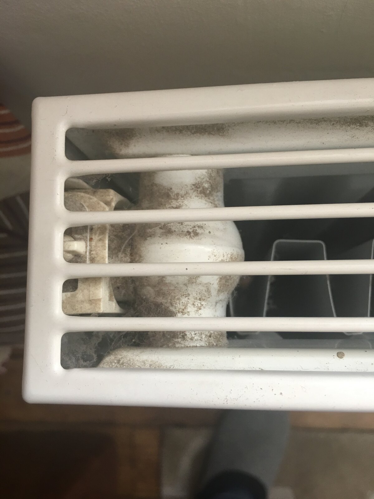

Hi,
Can anyone tell me how to remove these type of covers to clean underneath?!?
Thanks!
With the extensions on there it may be more difficult to get the bottom section out. It should be a case of twist the bottom plastic ring 180 deg so the open slot is at the bottom and then the end panel pushes up and then pulls away from the rad at the bottom, that then releases the top panel from the side panel. They end panel normally has 2 lugs that clip up and over onto top panel where they touch.
Either that or use a bottle brush.
