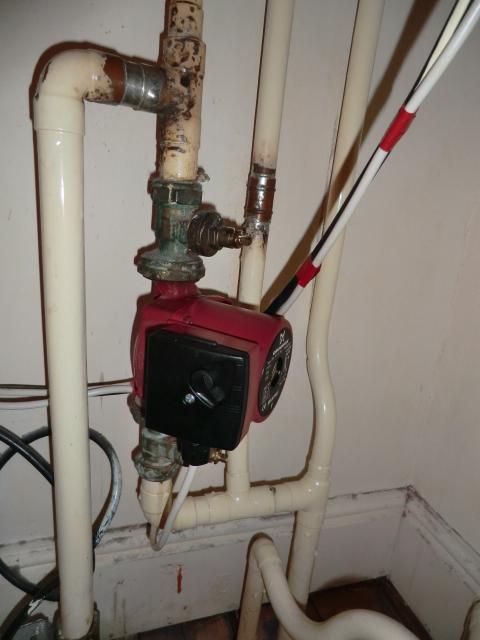

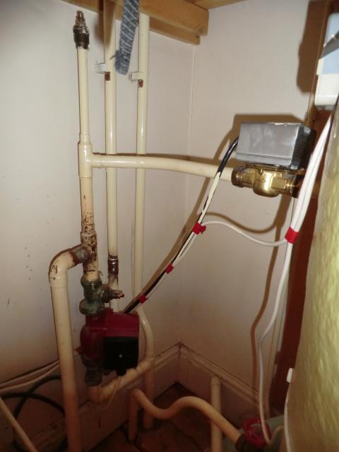

I can't find an air separator as you describe but I have taken a picture:
A previous engineer had used a magnet on pipework near (below to the right) the pump and said that it had some sediment in it, and suggested getting a local plumber to cut out the pipe section and replace. This was in response to me telling him that the radiator nearest the pump needed bleeding regularly. He also suggested that the build up of sediment could be causing it to vent to the F&E tank in the loft.

No air seperator fitted with your setup, looks a rather odd layout of pipework, but seen worse! The microbore wont affect the HW, the pipe rises from the pump, tee splits flow to CH and HW, the top pipe continues to the motorised valve and then into the cylinder coil.
Symptoms suggest poor circulation, boiler heats the water but as its not getting away very quickly, the boiler stat shuts the boiler down. Heat slowly moves away from the boiler, temp drops and boiler fires again, cycle repeats, meanwhile system is slowly getting warm. You said heat is getting to the pump, how far is it getting past the pump? I cant see it being a blockage if the system was fine at weekend, blockages tend to stay there until physically removed! Pump may be new but it does beg the question is it doing anything?
