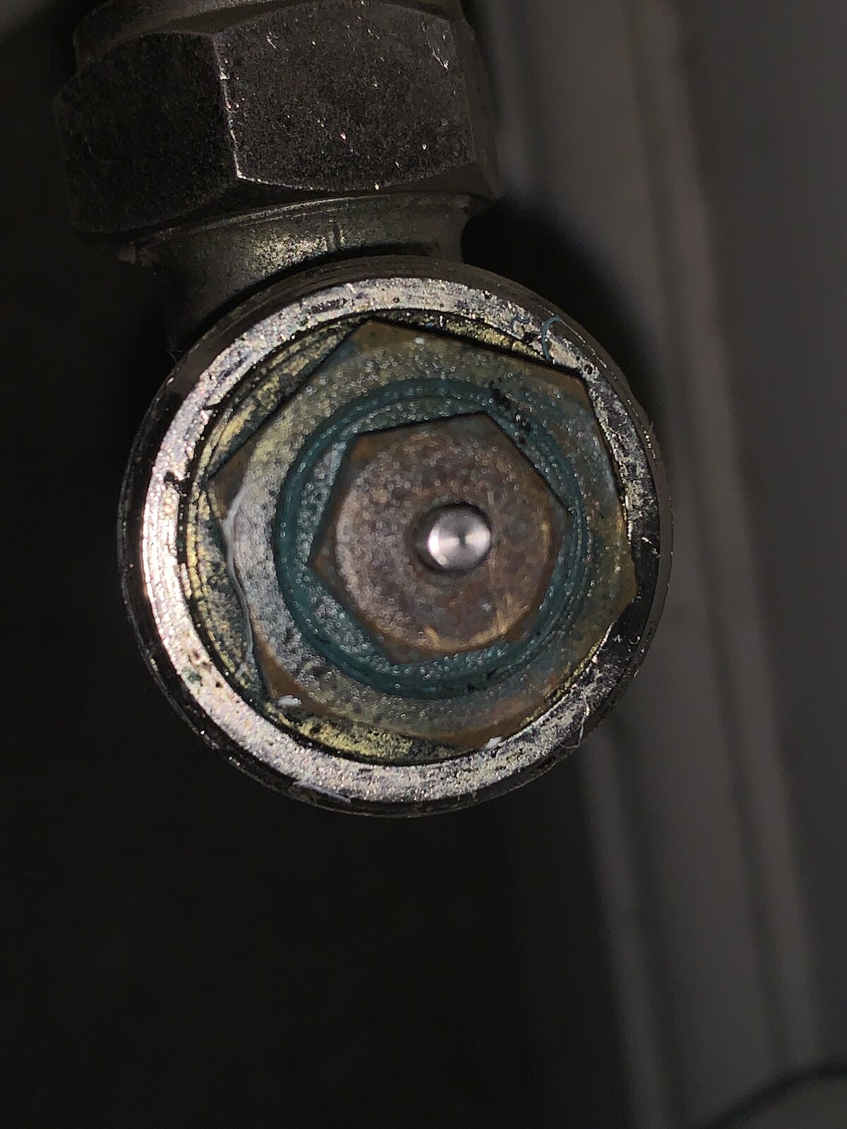

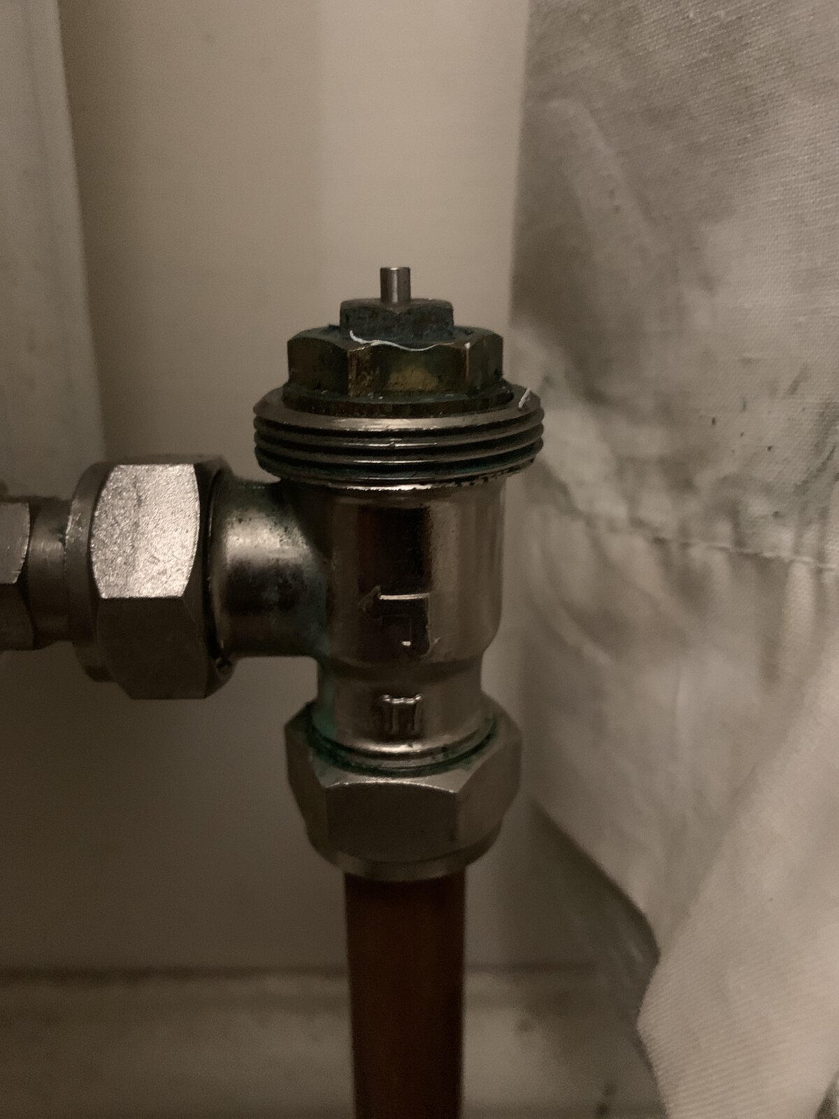

Hi got a new Trv head and it’s still not working. Radiator is boiling and can’t be adjusted. I’ve tried two new TRV heads. If I push the pin down without a head on it goes quiet which I assume is turning it off/down. Any ideas please? Is there a problem with the I internal parts of radiator instead of the TRV head??
You must have the wrong actuator head ,or you are not fitting it correctly.
Show us some pics
Hi, surely there is only one way to fit it? I turn it it 5/6 place on top with slight pressure and secure with the screw ring. I’ve tried two difference ones and taken old ones to tool station and screw fix and they’ve said they are the correct replacements?

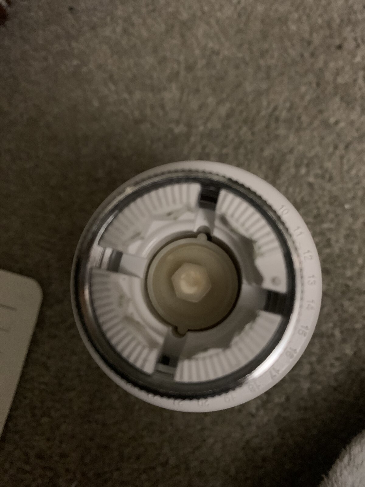

Take the head off, show us pics of the body ( from birds eye view) and pic of the head from its underside ( so we can see the bottom ,inside of it )

Thanks. Hard to tell for certain but I suspect it's the wrong actuator head. The hexagonal shape( that the pin is on the centre of) atop of the valve body doesn't like it will sit fully into the actuator.
Of you close the actuator fully ( to its lowest number) and try to fit it onto the body,you should feel resistance from the spring under the pin, so it will be pushing up whilst you are trying to push the actuator downward to enable the Screw ring to engage. If you can't feel that spring pressure ,it's the wrong actuator head.
Do you have the same TRV on another radiator that you can take off and try
