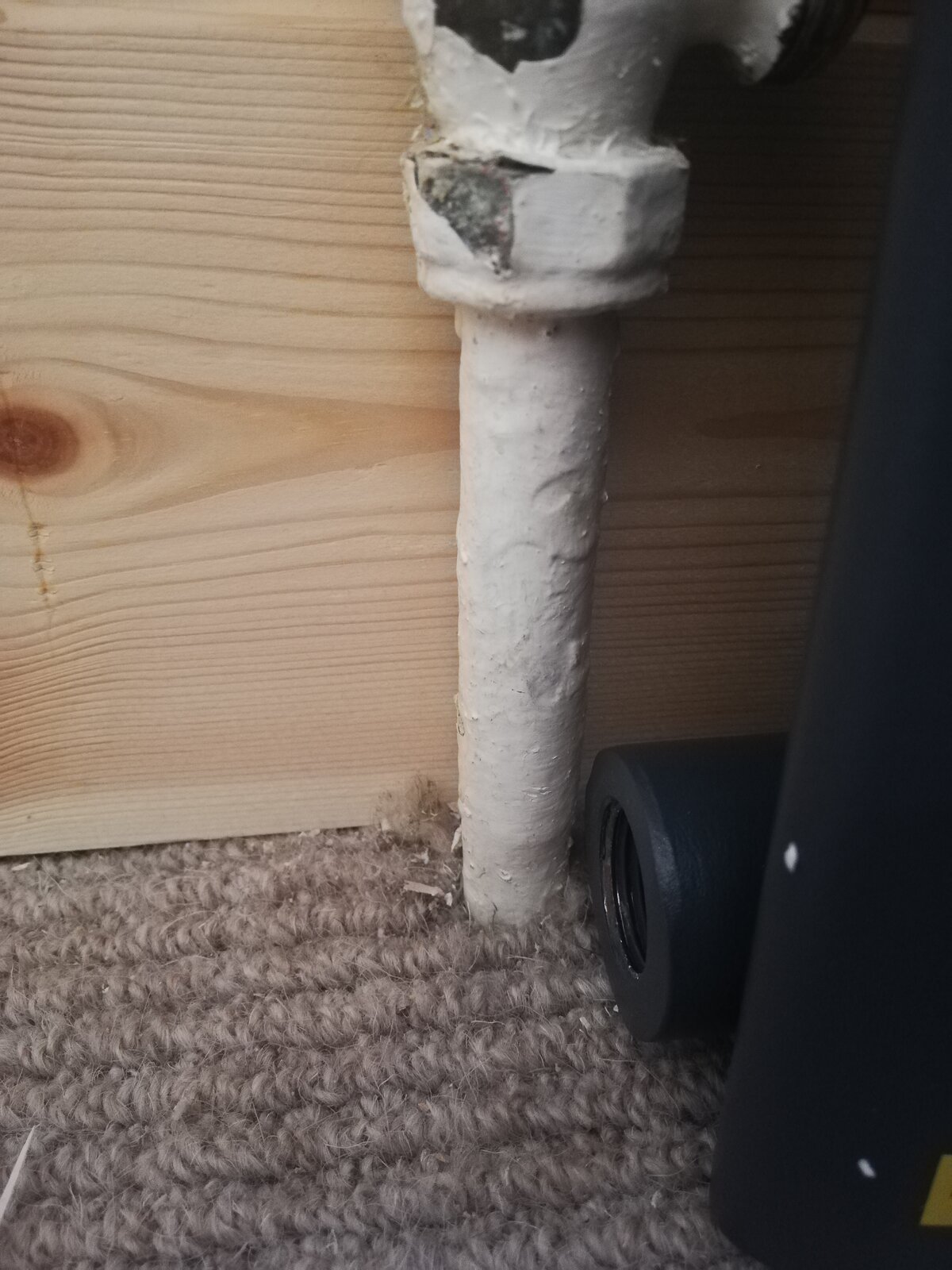

Hi all,
With winter on the horizon I'm helping the elderly couple next door.
They were dropped in it by a cowboy. They have no radiators fitted but have ones already bought.
They were either selected incorrectly or their flow/returns are at old distances.
Basically the inlets are nearly kissing both outer diameters of each flow/return pipe.
Does anyone have any advice on best way to plumb this in for them?
Be great if there is a known short valve that can be bought for situations like these.
They have no money and can't buy new radiators or even return them.
Any help is much appreciated.
1. A photograph showing the complete valve and the inlets of the radiator would be useful to determine the problem more accurately.
2. From what I can see of the valve, it is a "Union" fitting type. To get this to fit the new radiator you will almost certainly have to use the union type tails from the old radiator. The tails are the cylindrical parts which screw into the body of the radiator, and which have the other end attached to the valve. Tails almost invariably have a 1/2" BSP thread to go into the radiator. Union tails have a 3/4" BSP thread to connect to the valve. Compression tails (the other type) have a straight, normally chromed tube at the other end. onto which a compression (not Union) valve is fitted.
3. Given that the set up is of some age, great age judging by the paint on the pipes, the old radiators may well have been imperial, and the new ones metric.
4. It is likely that the pipe centre distances will have to be altered. It may well also be that the distance from the wall will be different. Such differences can generally be accommodated with additional pipework, with bends or fittings.
5. In my view this requires skills well beyond most average DIYers.
The pipework will need to be altered if all rads are as the one pictured .
Hi oldbuffer. Thanks for replying.
The old radiators are not here and must have been binned on removal. If they were I would have connected them back in for now.
The photo is all there is.
I am willing to buy new valves for them if there is anything on the market that is shorter than the usual valve connection to inlet distance.

I would use solder elbows ( assuming pipes are copper ) ,one to take pipe out horizontal ,the other vertical. Probably only need to do one side of rad,the other side would line up ok.
A lot cheaper and neater.

Simplest method is to move one end of the pipe work, which ever is the easier, where it emerges through the floor. It would likely only need an elbow - either soldered or compression type, and maybe a short bit of 15mm for each radiator.
The best and neatest way would be to use 45s possible 2 x =; & 2 x Street.
