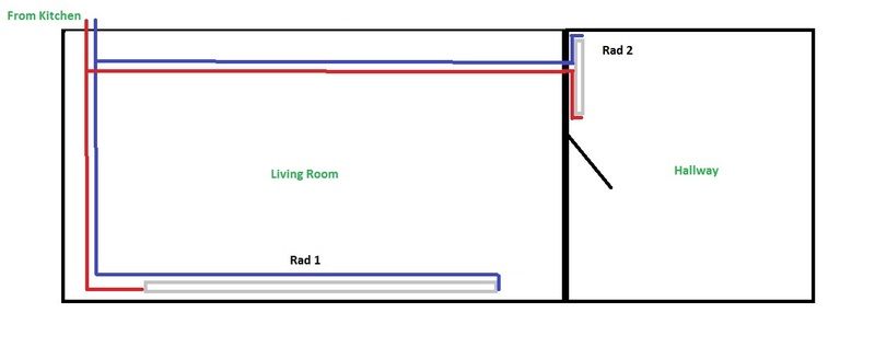

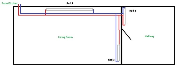

My situation is as follows, I've currently got the setup below which I believe is known as a "double pipe" system. There are flows (red) and returns (blue) which come from the kitchen to feed 2 single rads in the living room and one double in the hall.
Now I would like to replace the 2 rads in the living room for one large double P+ rad, but I'm unsure of the best way to layout the pipes. This is my preferred layout (because I'm burying the pipes in concrete and this means less work!). My worry with this option is that the system is split and if either rad is turned off this disturbs the flow of the rest of the system - is this something to be worried about? Also, I'm assuming I would need drains on both radiators instead of just the end one (currently on rad 3 in my current setup)?

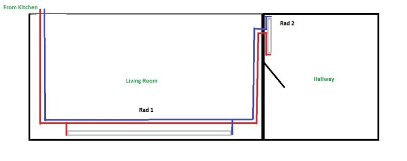

This would be option 2, in this case the rads are connected and shutting either of them off would not disturb the flow of the system.

Flow and return can be fitted to either side of the rad, so long as they do indeed have a flow and return not flow>flow or return>return.
You pipework layout will be fine, so long as you maintain the 22mm pipework main as long as you can up until it get's to the rad, then reduce down to 15mm.
To get a better idea of it will indeed work though, we would need to know what boiler you have, how many rad's in total, on what floors the rads are on, the size or pipework it is fed by... etc
Realistically I would maintain a 22mm main and only branch off of it for individual rads.

For those couple of rads 15 mm will be fine. Either of those 2 layouts would work so, whichever one's easier.

Are there any advantages/disadvantages to either of the 2 layouts I suggested?
