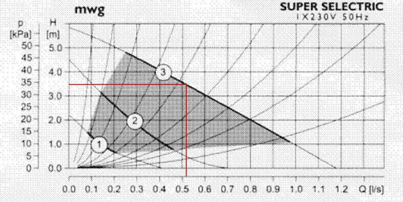

The boiler is a Potterton Suprima 80L - the pump is grundfos p/n 59506151
The flow rate at max output is 0.51 litres/sec and the available head from the pump is 3.5m (see chart below). The pressure drop in the boiler is about 1.1m, so there is only 2.4m available for the index circuit. Your system could well exceed this, given the number of rads and the convoluted pipe runs.
(click to enlarge)
The solution is probably a larger pump :( , but you should try balancing the system first.
