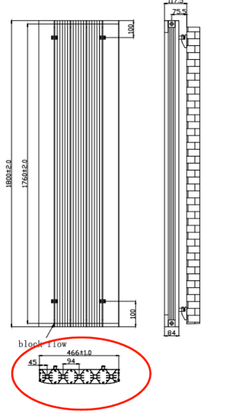

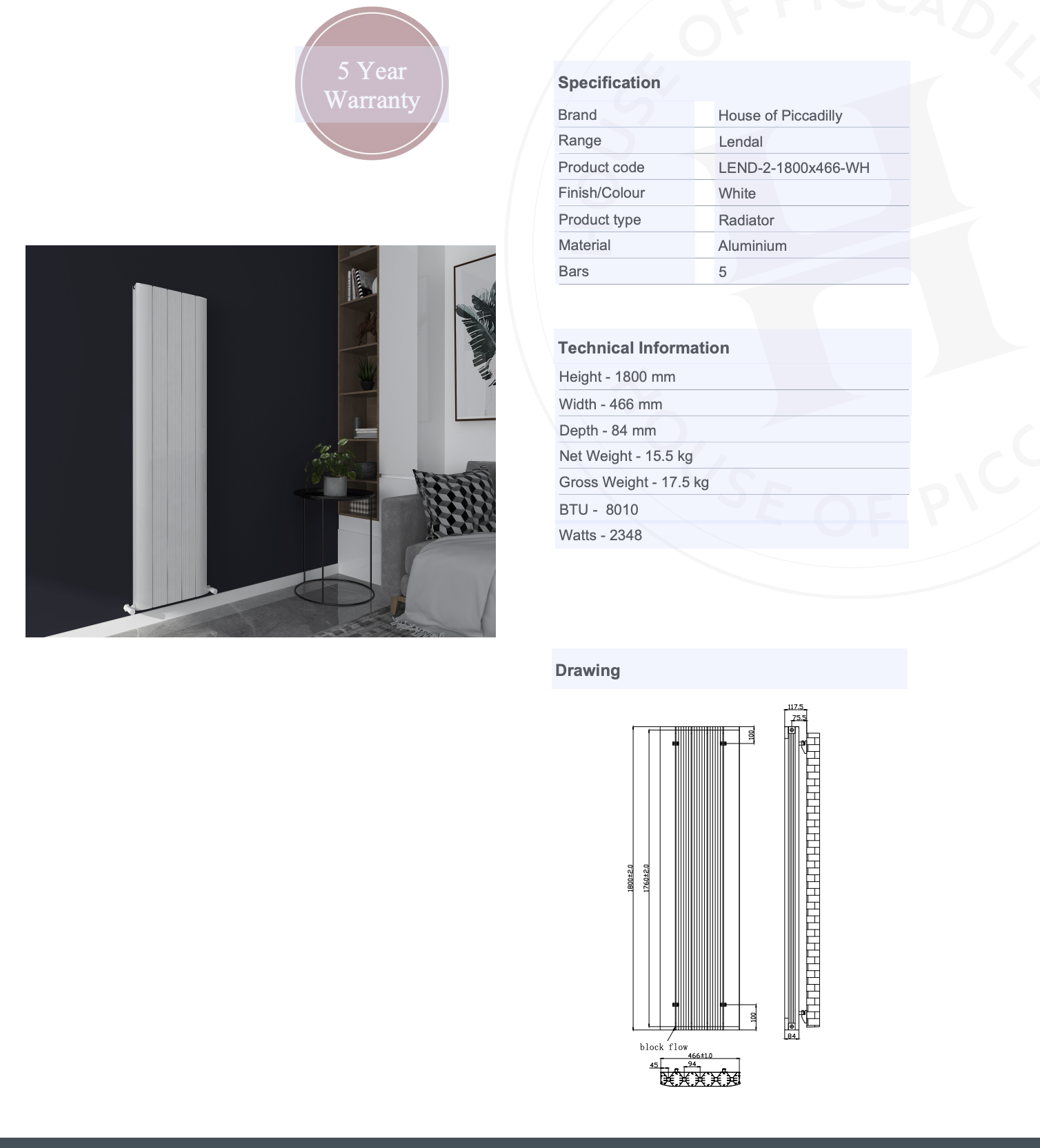

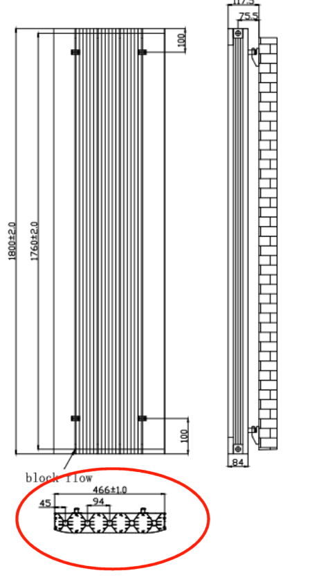

The vertical one we were looking is this one, it's aluminium but not sure what type

Thanks, from the online calculators the room would need about 5700-6000 BTU for the living room (room is only 4x4m - 2.3 ceiling). Do you think going to a 8000BTU is a good option?

Heat loss calcs are designed to provide the amount of heat that a given room can lose in an hour in Kw, that is then matched to the output of the radiators at a given delta that can then replace that heat loss, that is then designed to ensure that the space is comfortable to be in. Unfortunately that doesn't cater for how a given radiator may heat that room up and how that then feels to the user. They are useful when replacing like for like, as the performance of that type of radiator is understood but when changing the type of radiator to others that heat the space differently, then that information doesn't tend to be as real world useful
Looking at the specs of that vertical rad suggest that it may have hollow tubes which could act as convectors, a call to the supplier would confirm though.
Thanks, i'll check with them. Would that be good if that's the case?
