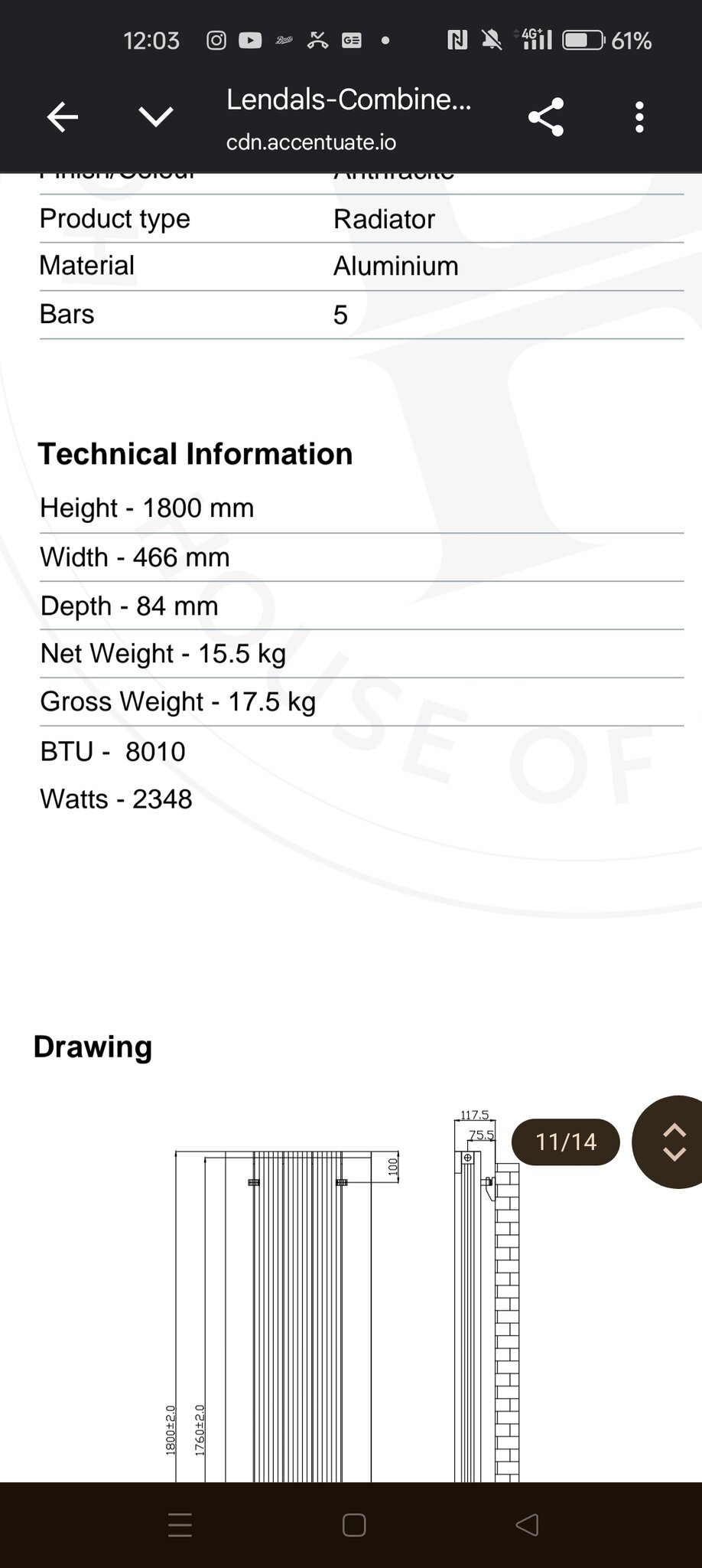

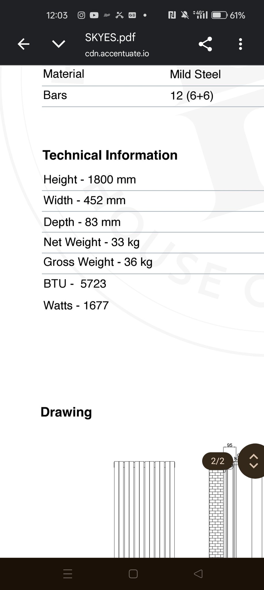

We’re replacing our living room radiator with a vertical one and our plumber has sent a few options.
One is a steel radiator (~5700 BTU) and another is aluminium (~8000 BTU). Our room only needs around 5600–5700 BTU, so both would technically be enough.
The rest of the radiators in the house are original steel ones (house built in 1996, standard boiler setup).
We quite like the look of the aluminium one and the price is pretty similar, but I’m wondering if there are any real benefits beyond aesthetics.
I’ve read that aluminium heats up faster but also cools down quicker, so wondering if steel radiators would actually be a better option in that regard?
Is aluminium actually better, or does it not really matter as long as the BTU output is right?
Also, is it okay to mix aluminium and steel radiators in the same system?
I’ve seen a few mentions of potential corrosion issues when mixing metals, but the plumber said that using an inhibitor prevents this issue.

Examine the temperature and heat output figures carefully when comparing them to steel.
I find it easier to visualise energy ratings in Watts and kW, but some manufacturers prefer BTUs from the 1950s because the numbers look bigger.
The figures quoted on the spec sheets tend to use delta T-50 data, meaning that your boiler flow temperature will have to be around 75C to get the 5700 btu/hr output. The modern trend is to design for lower flow temperatures in preparation for heat pumps, therefore the 8000 btu/hr rad is more likely to satisfy your heating needs both now (with a TRV) and in the future, whether that be in aluminium or in steel.
